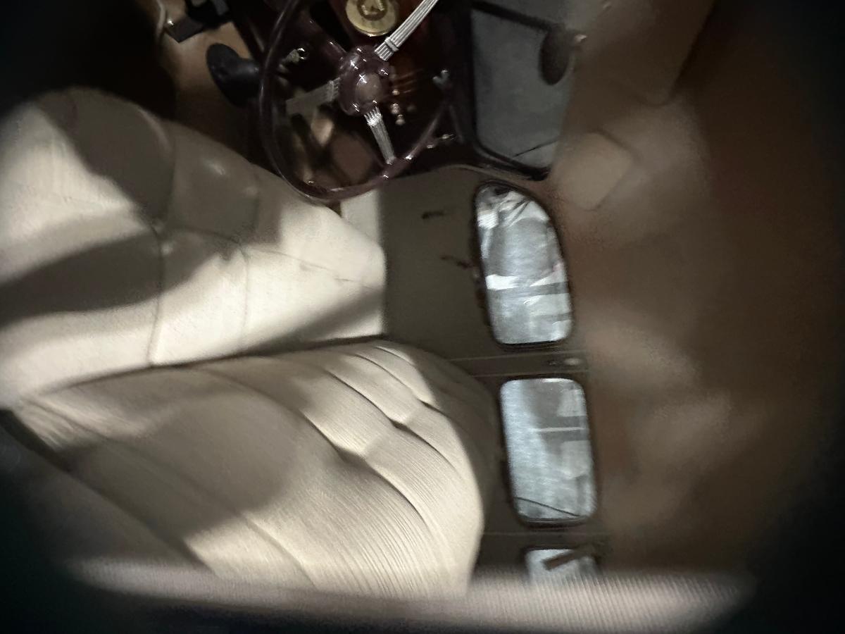

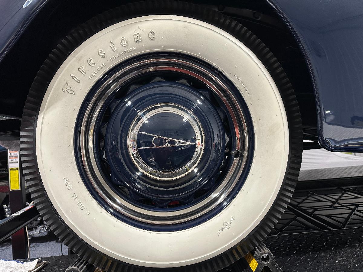

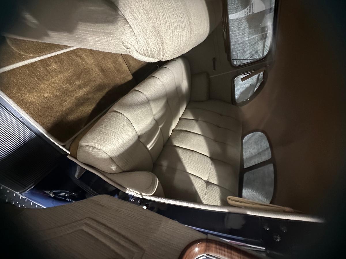

I recently entered my ‘37 Ford Model 78 Deluxe in an AACA Grand National event. My judging report came back with 2 deductions: one for seat cushions and a second for wheel rims. I am looking to see if I can get any pointers of photos of the as manufactured cushions and wheels. Any help would be greatly appreciated. Thank you.

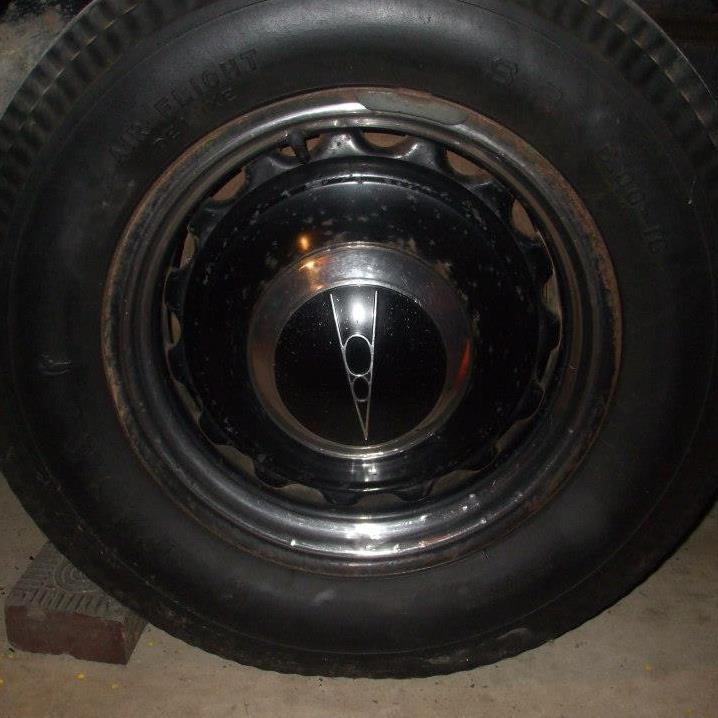

Did the AACA judges tell you what specifically was wrong with the rims? I personally don't see anything incorrect about them from the picture.

In doing sim AI research, it mentions I am missing a pin stripe on the rims, the tightly pulled buttons on the seat cushions (creating the diamond look) is not original as well as the fabric on the cushions.

Within the photo of the tire / wheel I noted you have incorrect valve stem caps; a certain deduction on the Ford V8 Club concourse.
If you are truly serious about absolute correctness, you would be best served by having your car judged at a Club (national) meet or preferably two or more.
Oh, quick question... are the tires white on both sides (double whites)?
