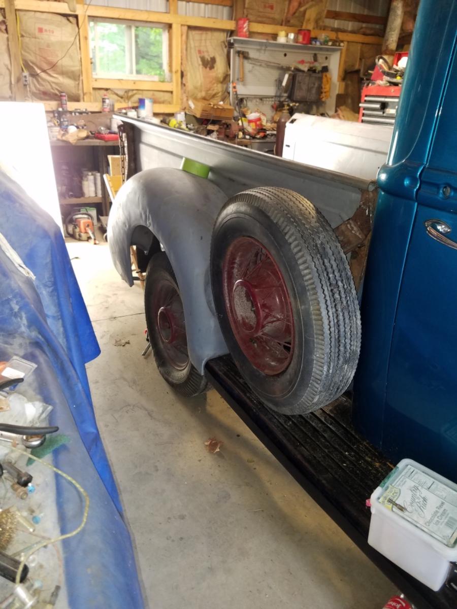

I recently purchased a very nice 1941 Ford pickup that had a few items to be reattached. One of them was the passenger side spare. There were photos of the truck with the spare mounted, so I believe all the necessary pieces are there. It's a little embarrassing, but I can't figure out exactly what goes where to remount the spare. I've searched for step-by-step guidance in Ford manuals or a YouTube video, but have come up empty. Can anyone offer the steps or a short video (like is the plate behind or in front of the tire?) so I can get this back on correctly? Thanks for any help!

As far as I know the plate is behind the wheel. I would also recommend you post your question on the Fordbarn as many of those on that site have pickups and can help. There is also a Facebook group dedicated strictly to the 40-41 pickup.

I recently had the same problem on my 41 half ton. I modified the original mount and fabricated a new mounting plate. I mounted the wheel to the mount and put it in position and marked where the mount had to go. Then i located and mounted the mount with bolts and hidden nuts. also baby V8 caps and beauty rings

Thanks to all for responses. I'm new to this site and didn't realize there was no notification when a reply was made. I did solve the problem with the assistance of a few V-8 Ford experienced friends. Thanks.

Original mount and lock
