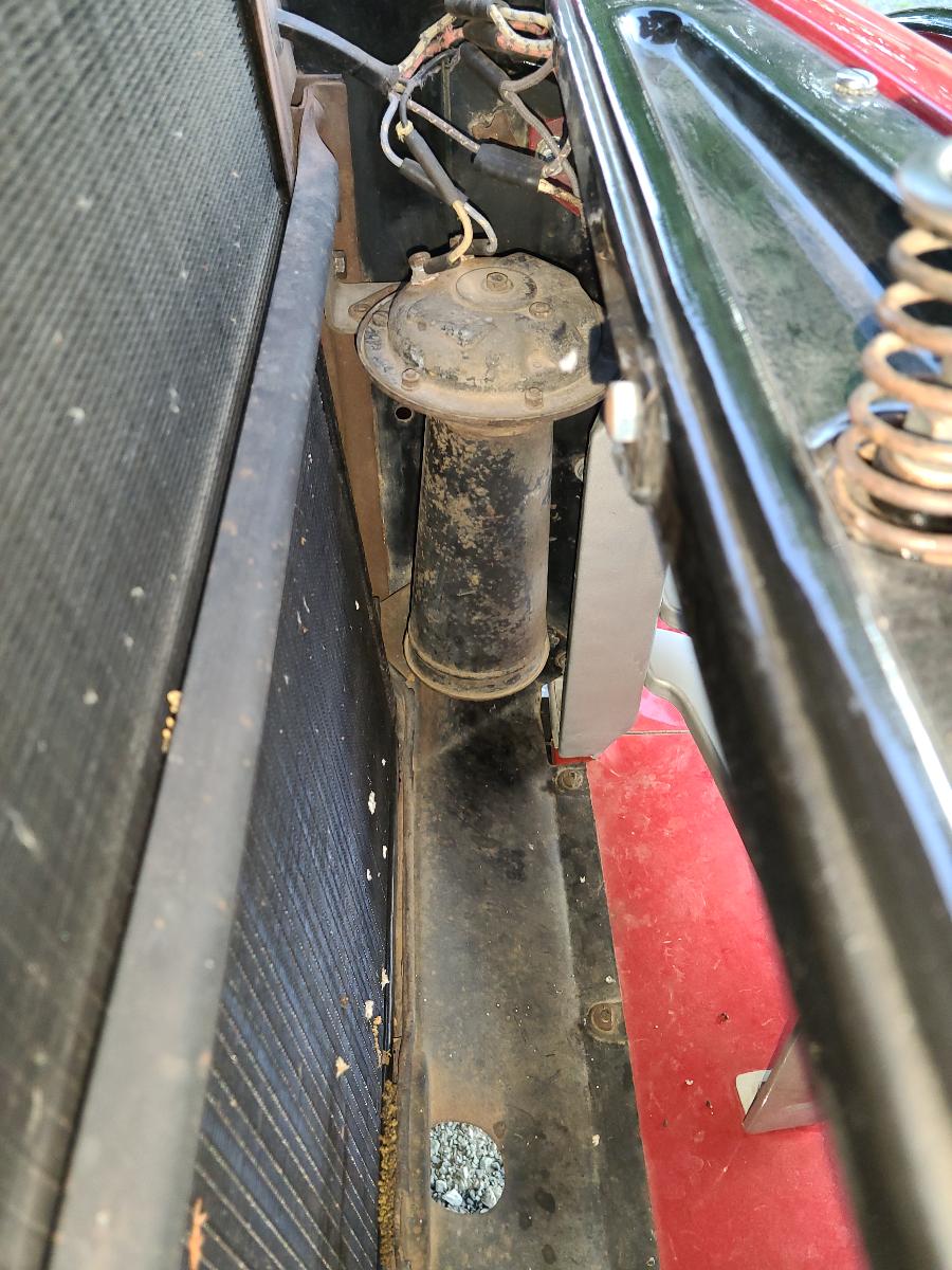

I would like to know what the horn looks like and also where is is located?
I would like any help I can get in troubleshooting a horn and knowing how the horn button works.

48-50 “beep” horn
f1ford48
05-21-2023 @ 8:11 PM
Posts: 61
Joined: May 2010
To remove button disconnect horn at base of steering box-or battery-. Push down on button and turn 1/4 turn counter clockwise.
These trucks have a horn relay mounted near the horn and the horn vibrator is adjustable too.
