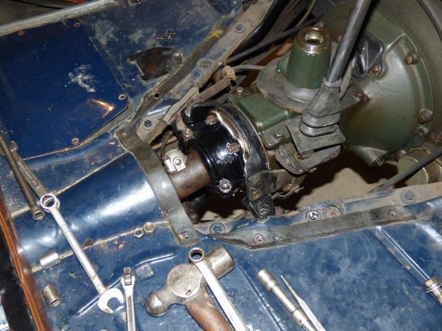

It is in my opinion, it's much easier to pull the torque tube / differential back a few inches and pull the transmission out through the floor. I'd done this very same task last summer. At that time I'd replaced the rear transmission mount. When you replace the clutch disc, you MUST replace the throwout bearing and pressure plate at the same time. Do not attempt to save a few bucks. If you do, rest assured, it'll come back and bite ya. Do you have the authentic floor shift transmission? If so, your issue is not linkage. Hey, as long as you'll have the transmission out and you have a friend that knows what he's doing... go through the transmission at that time. A new synchronizer assembly is a must as long as its (trans.) apart. And of course, whatever else is worn including the clutch release shaft and respective bushings. Check all of the pivot points of the clutch arm and associate linkage. A little wear in any of those areas effects the clutch release operation exponentially. I'd also replaced the universal joint. It was worn only a little but figured that was the "proper" time to do so. The photo I've attached is from my '36 roadster I'd done this work to. The torque tube needs to be pulled back only even with the floor pan edge - maybe 6" or so. Mike "Kube" Kubarth
