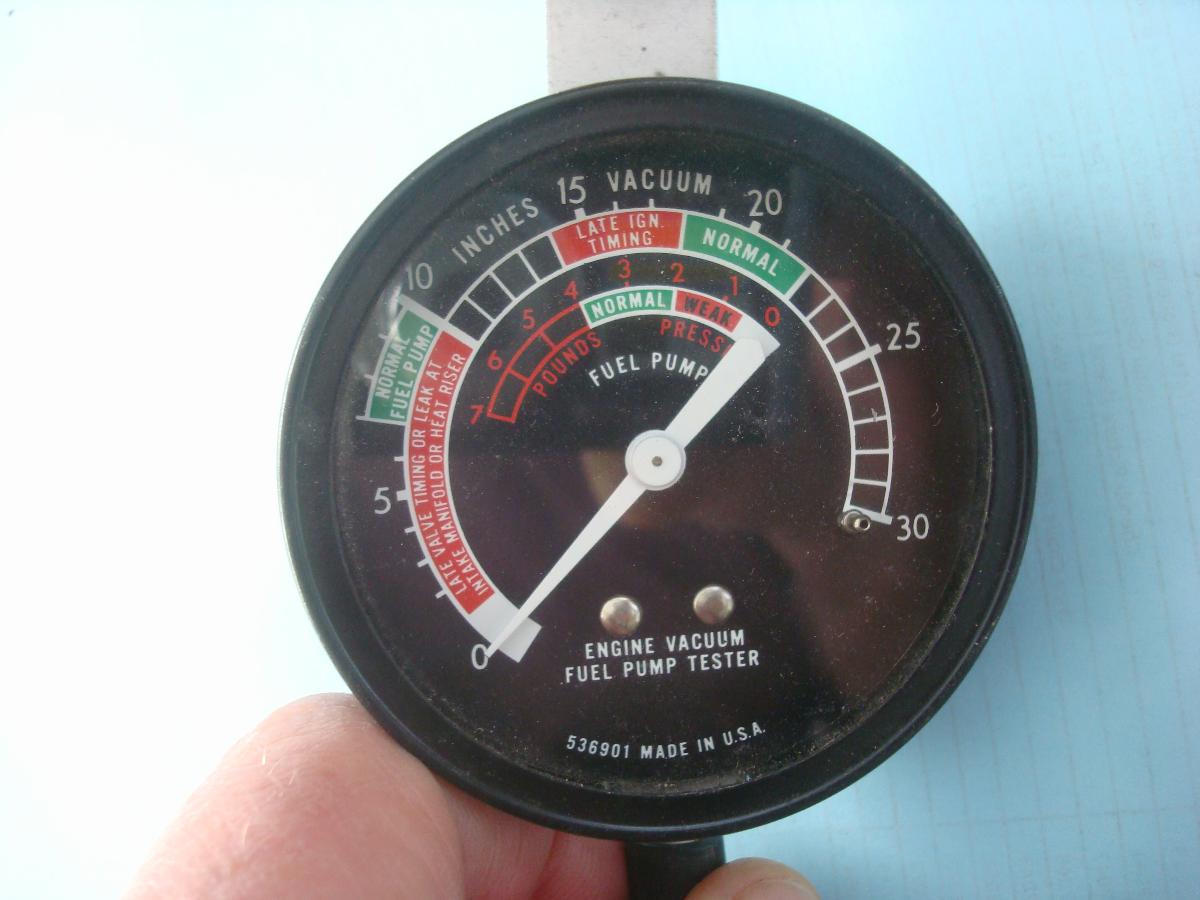

37RAGTOPMAN |
04-08-2020 @ 5:46 AM
Posts: 1941
hi I took a photo of a Vacuum gauge, is the engine running smoothly ? is the needle steady at 14 , hope this helps 1937Ragotpman
