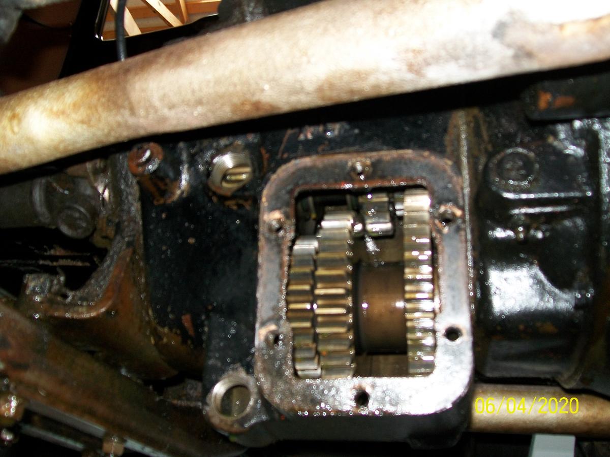

thats known as a ''crash box'' it is a Warner T9 spur gear transmission. upshifting works best on mine if i do it super fast. downshifting fourth to third you blip the throttle. forget down shifting to any gear lower than third unless you are a pro...... old truckers are the best in describing how it is done.
