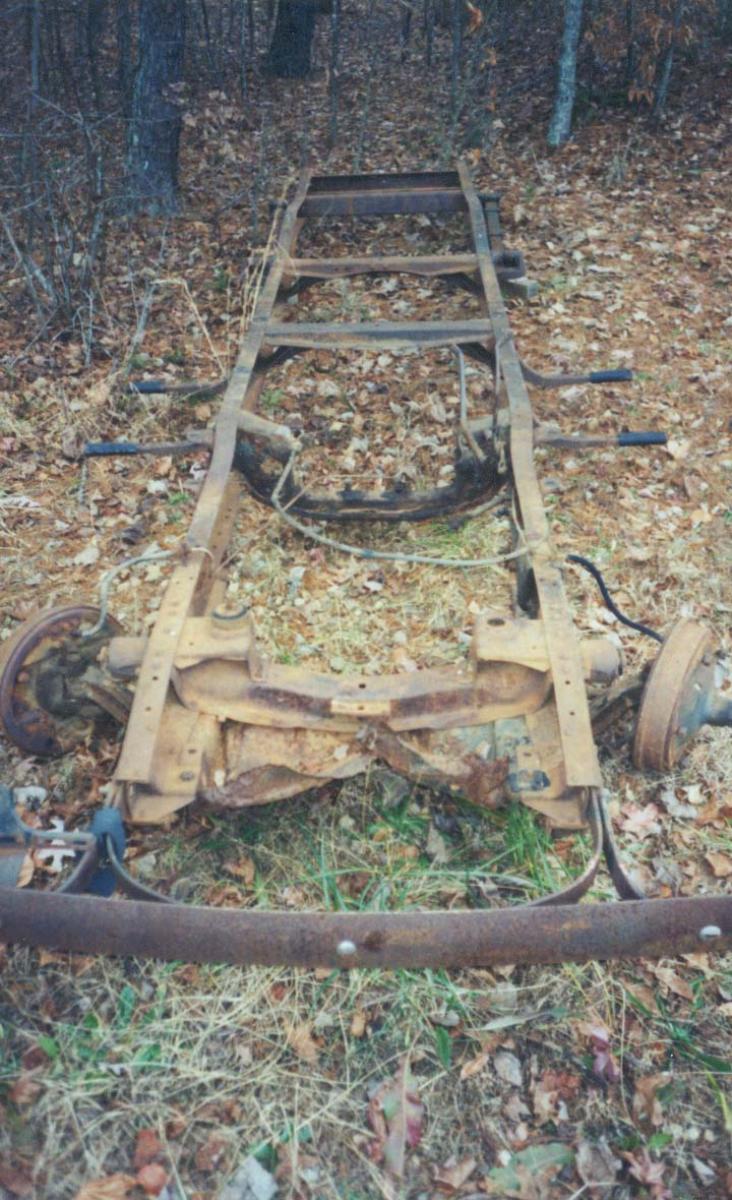

We have a 1945 half ton pick up which we are preserving. It’s had some changes made to it over the years as most farm trucks have, so it’s not completely original. I decided to fast track the chasis mechanicals which cost me a small fortune in a shop but I am doing the body build with my son and a mate.
When the shop stripped the truck down there were not enough pictures and labelling of parts so my first issues are what fixings and springs do I use in each of the 6 (I think it is) Cab to chassis bolting points.

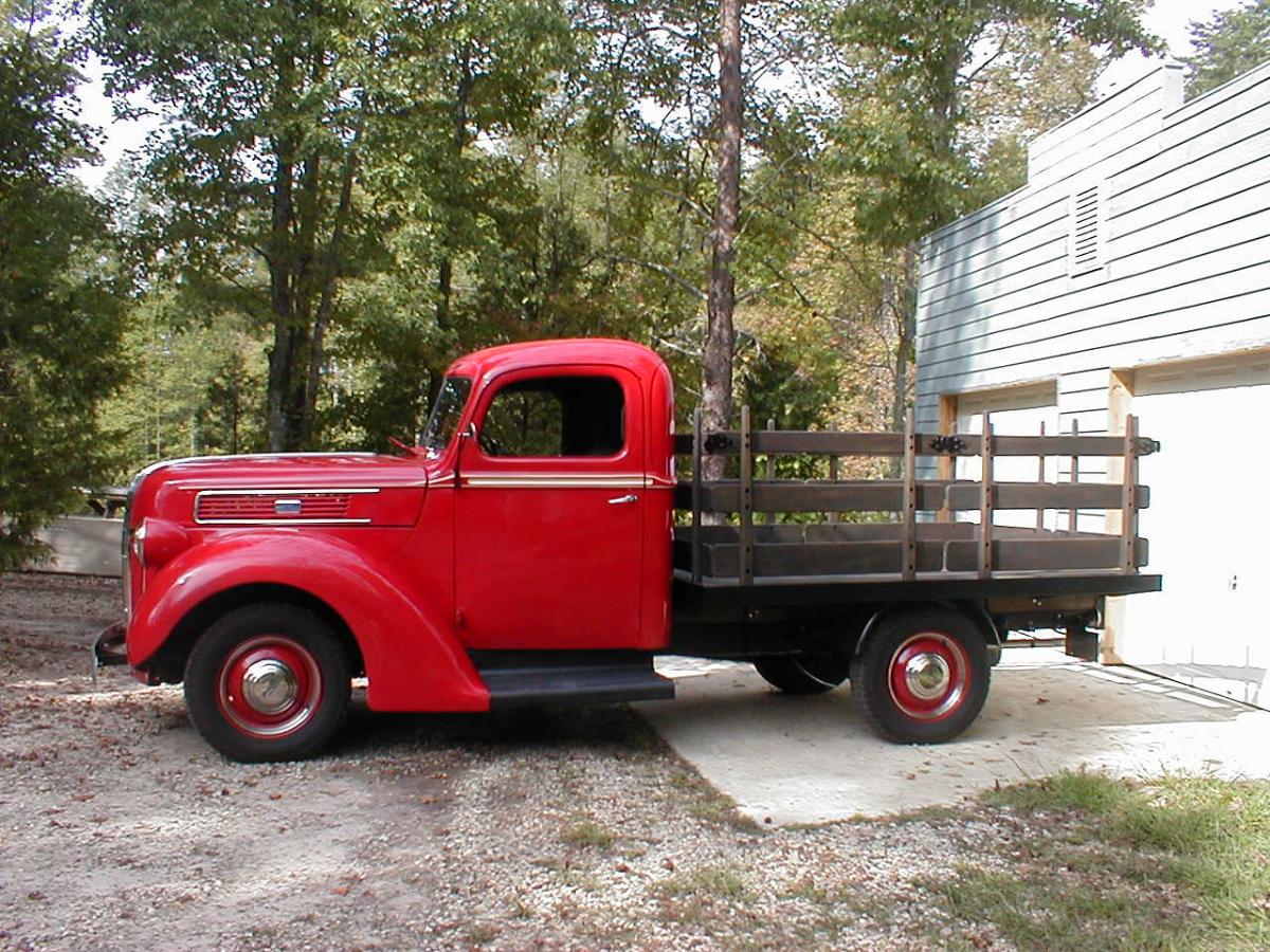

PS picture below is our truck as it arrived home. Mechanical parts have been fully reconditioned but kept Generally as they were on arrival. The truck will look like this when we have finished too as we plan to clear coat the body.

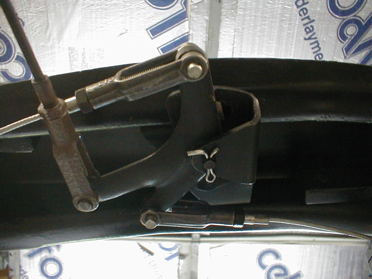

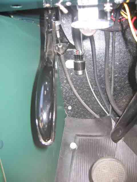

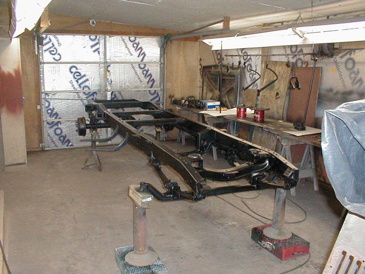

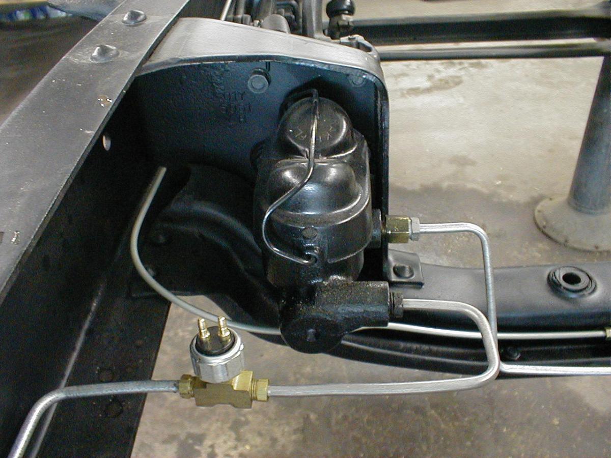

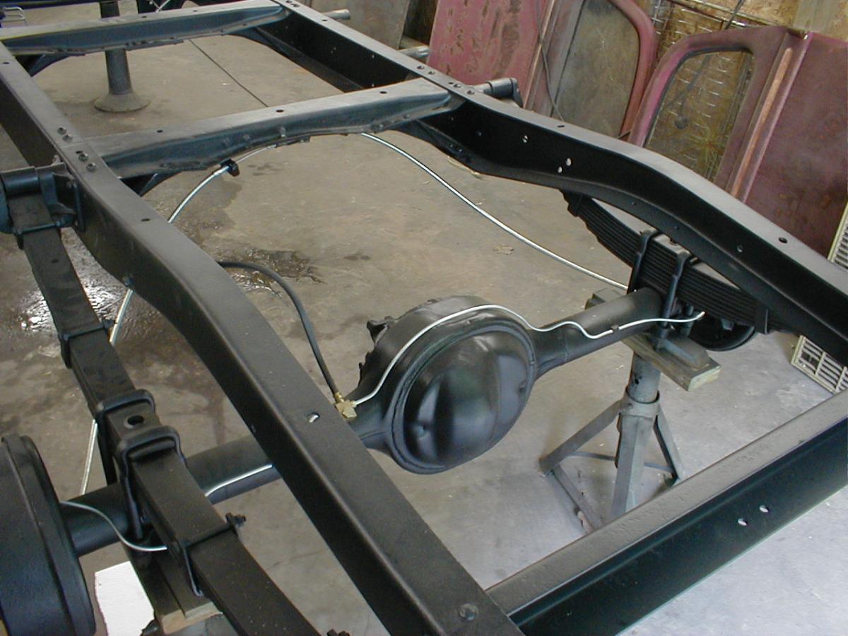

1/2 ton pick up cabs are virtually the same from 1940 thru 1947. the fenders and fender mounts changed, dash and other parts did not. I have a 3/4 ton 41 truck like your 45--same frame/drivetrain and I use a 9" Ford truck from 1968 so I can go faster. front park brake cable goes down to under the cab to a sort of contraption of levers to make the rear brakes work for parking. I will try to take pictures you want when I can get it on a lift

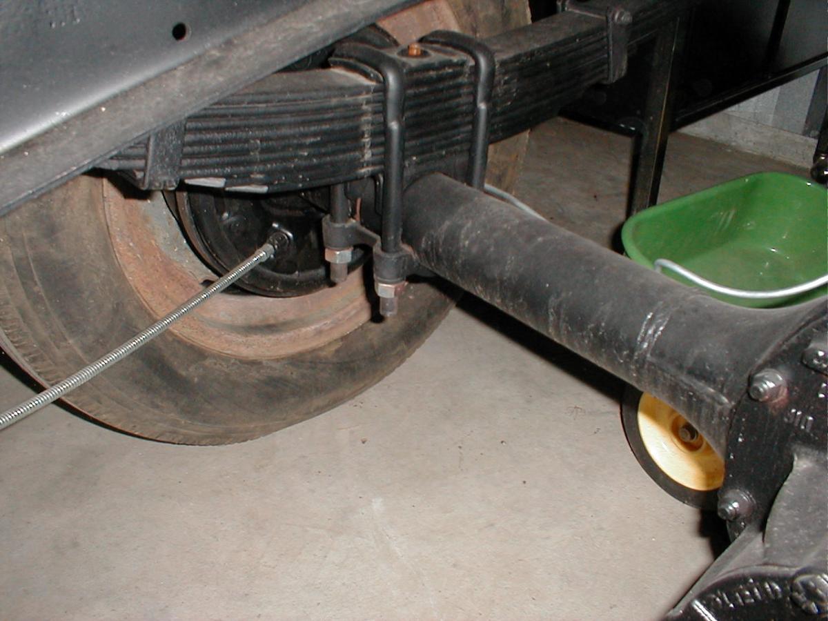

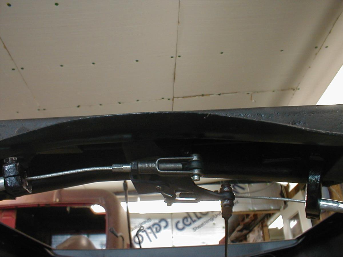

more brake/frame/rear axle. my frame is longer than yours 122" vs 114" but it is built the same

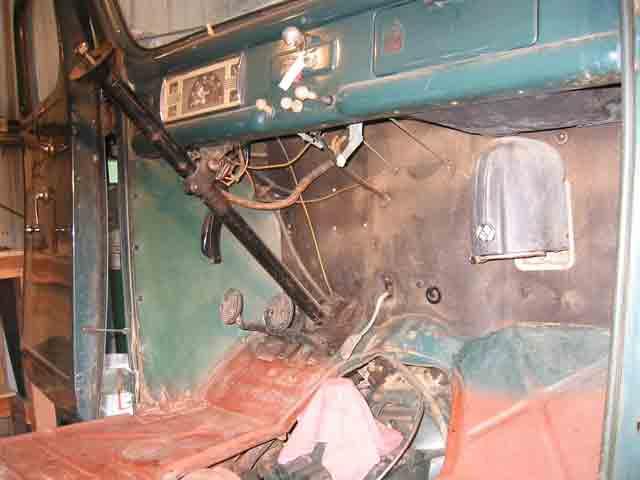

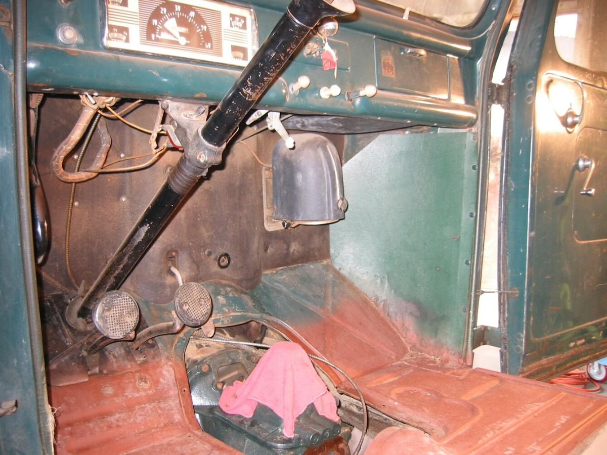

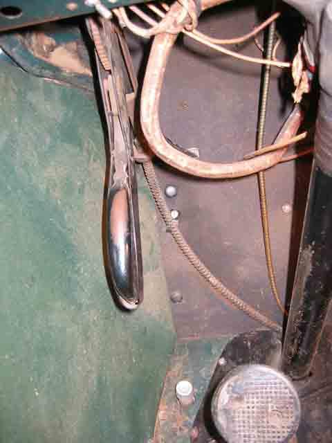

Thanks for those pictures Alan. I see how that swivel bracket works now. If you have any pics under dash of cable and hand brake and it’s route thru the firewall Also under the cab showing the sprung cab bolts coming thru under the fuel tank seat area, that would be great! Thanks again. Truck looks great.
Kevin
