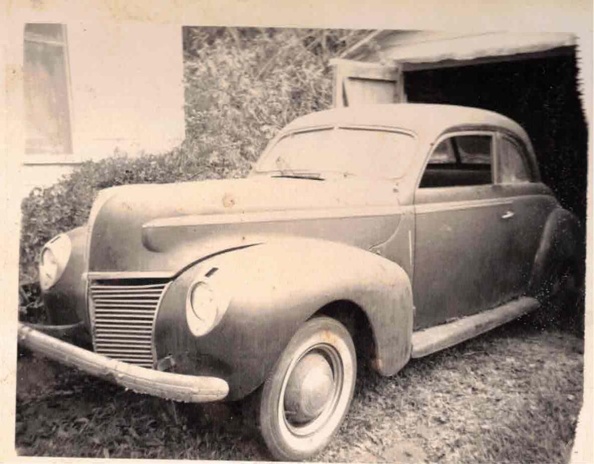

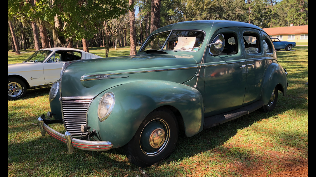

Pictured is my "early" production 39 Mercury Town Sedan with the antenna installed on the side of the cowl of the car, which from the sounds of it is "different" than your car!!! NOT sure WHY but I wonder about when and where the radio was installed?? Dealer ship maybe??? AS many pictures on a google search do not show ANY antenna at all and the rest show an antenna center top of the windshield!!!

Boy, no kidding. Not much to reference from…. Beautiful 39, by the way!!!

Rock, The antenna on your car was added many years later. It is not stock.

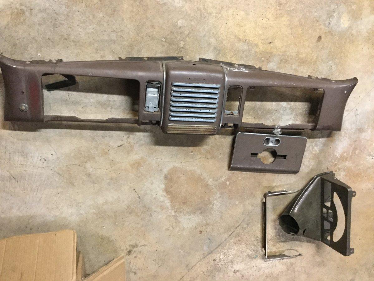

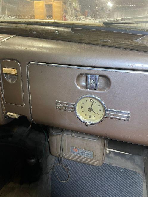

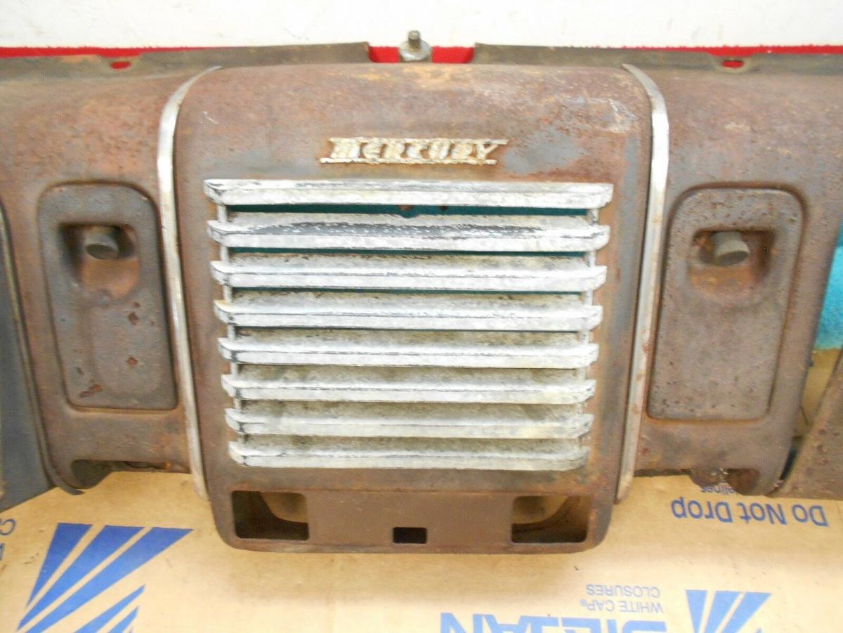

SO, Mike....my question to you would be this. There were two distinct dash set ups for the 39 Mercury, one with the openings for the radio controls and one with NO provisions for a radio (as pictured). My car has a radio (obviously) and did so at the time of manufacture by all appearances........SO.....IF it's a "later" addition antenna, then WHY no hole in the roof for a "correct" antenna?? There in NO marks anywhere else on the car where any other type of antenna was used prior to what is on my car?? Its a mystery to me......SO what say your opinion? I have NO proof of what I "theorize" and like you, have seen the same antenna on later model cars. It's only a theory BUT quite possibly had what is considered "original" type antenna for a 39 Mercury NOT quite made the production line at the time of assembly (as my Mercury is a "early" production car)?? Thus used what antenna they could get UNTIL a more permanent purpose built antenna was ready for full production?? My car also has several "other" distinct differences between it and later production 39 Mercury's. The ONLY other answer to my question would be IS the "NON" radio dash already cut for it BUT the blank off plate/ribs fit the radio hole openings (the only logical answer)?? My car shows NO signs of it ever having a radio delete plate on the surface paint. Mike, also AS an interesting side...the only other 39 Dash I have is for our 39 Sedan Coupe (dec of 38 production), also cut for a radio BUT also NO holes anywhere in the car for an antenna??

I will try to answer your questions. Like Mike, I believe that your antenna is a post WWII addition. My answers are my opinions based on what i experienced back in the late 1940's. "There were two distinct dash set ups for the 39 Mercury, one with the openings for the radio controls and one with NO provisions for a radio (as pictured)" This statement is not true. All 1939 Ford and Mercury dashboards had the provision for a radio. Your photos show one dash with the radio hole cover removed and another photo with the radio hole cover in place. "IF it's a "later" addition antenna, then WHY no hole in the roof for a "correct" antenna??" The hole in the roof for the antenna was drilled at the time the radio was installed. There was NO provision for a plug for the hole, so it would not have been predrilled. So IMHO it is very likely the the radio was installed after the car was sold new and most likely after WWII when that type of antenna became popular. "It's only a theory BUT quite possibly had what is considered "original" type antenna for a 39 Mercury NOT quite made the production line at the time of assembly (as my Mercury is a "early" production car)??" The photos that I have seen for the prototypes of the 1939 Mercury show the roof top antenna, so I believe that it was available at the beginning of production. A properly installed radio hole cover would have probably not left any marks. There is no such thing as a "radio delete" plate. Radios were optional equipment a quite a few cars were sold without the radio. In 1939 radio was still an infant industry. In 1930 a car radio cost $130 and in 1939 they were about $45 which was quite expensive.
