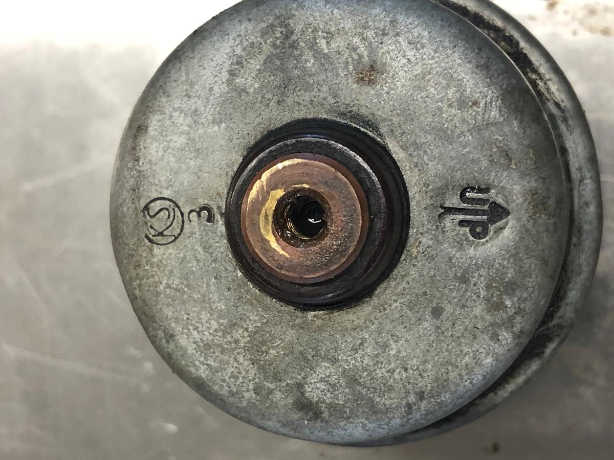

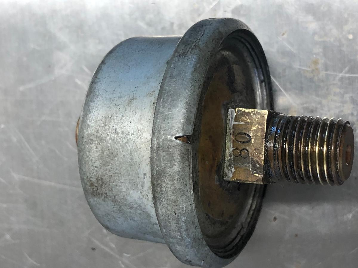

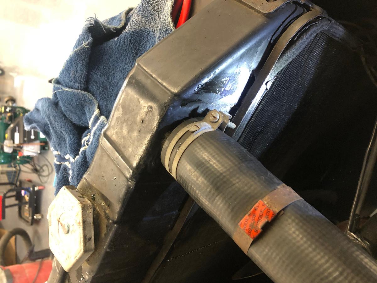

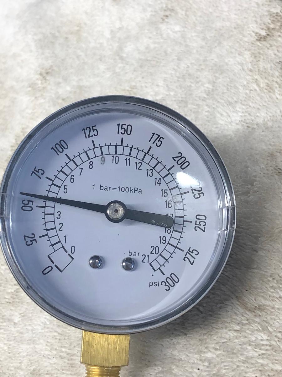

Went to work on the oil pressure issue. It was a bear to get the sending unit off to put the oil pressure test gauge in. It hold 60 pounds, so I assume it is not the oil pump. Discovered that my radiator is a 91A with an L underneath it. The fill is in the center rather than on the side, so it was replaced at some point I guess. I had to take the floor boards off along with the transmission cover to get to the sending unit. Not as easy as I thought. Found the KingSeeley unit stamped with a 3 on the top and 80 stamped on the brass. YOUNG was on the plywood on the drivers side. It's fun to take Mike's book out to the car and "see what I have".
What do I check next Mike? How do I check the oil sending unit?

You do have an incorrect engine unit and as such, it will never register the correct reading on the dash gauge. I'd suggest you seek out a NOS 50# unit. This unit will either have "50" stamped in the base or nothing at all stamped in the base.
To test the engine unit, attach a separate ground to that unit. One end should go to ground somewhere on the engine and the other to the terminal screw. Now turn on the ignition (just turn on ignition - do not start engine) and watch your oil dash gauge. If the gauge begins to move, that means the dash gauge is good. TURN off the ignition before the needle gets to 30#. This is designed to be a quick, temporary test.
If the dash gauge does not register, there is either a defective dash gauge and / or poor wiring.
My guess? Incorrect sending unit. When you replace it, do NOT apply any sealer to the threads. NONE!

The mechanical gauge is showing 60# pressure, so a 50# sending unit would peg a working gauge at the max side. An 80# sending unit is needed to get a reasonable estimate of oil pressure. The reading will be about 60% of actual pressure. Your reading of 10# would be about 17# pressure, 20# reading would be about 33# pressure and 35# reading would be about 58# pressure.
The 80# sending unit that you posted a photo of has been repaired at one time. The small V cutout is the clue. It is likely that it needs to be repaired again. The small 30 gauge wire that connects the output contact with the heating element was probably repaired with a solder that is not compatible with the nichrome wire. Hemmings has advertisers that will repair the sending unit. The current reproductions do not work very well and are short lived, because they work on a resistance principal an the original sending units and gauges work on a pulsating current.
The original type 80# sending units show up at swap meets regularly, so you could use your old sending unit until you find a good one. You can test the sending unit using a 6 volt lantern battery, a good dash gauge and an air compressor with a pressure regulator. The dash gauge does not have to be 1940 Ford, any of the Ford products gauges from 1939-1955 will work to test the sending unit.
