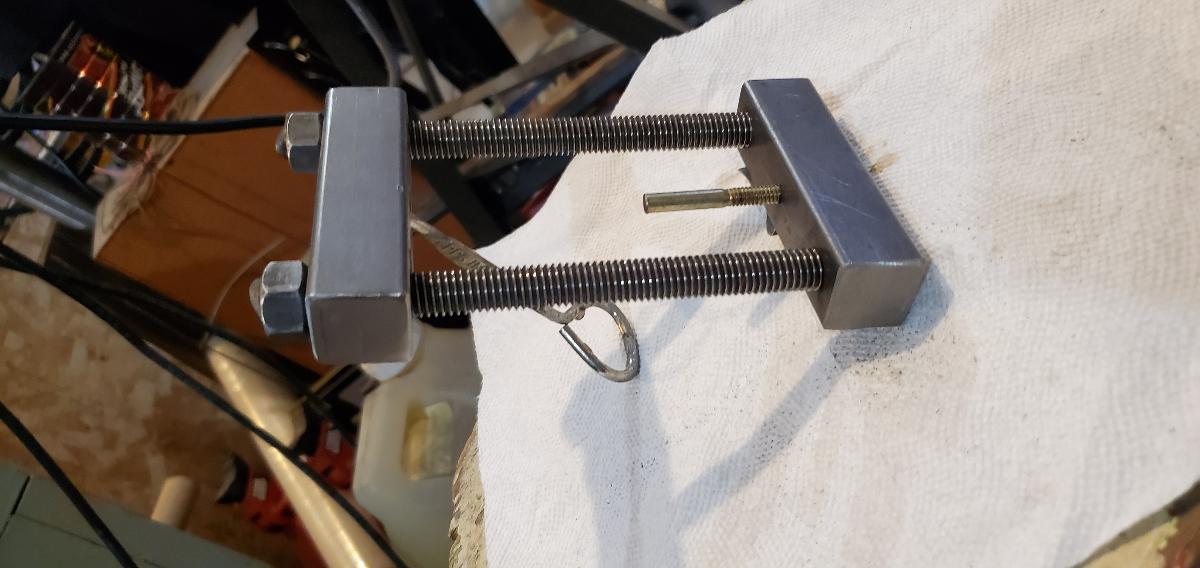

Steve, here a picture of the tool I use. It works great. Larry

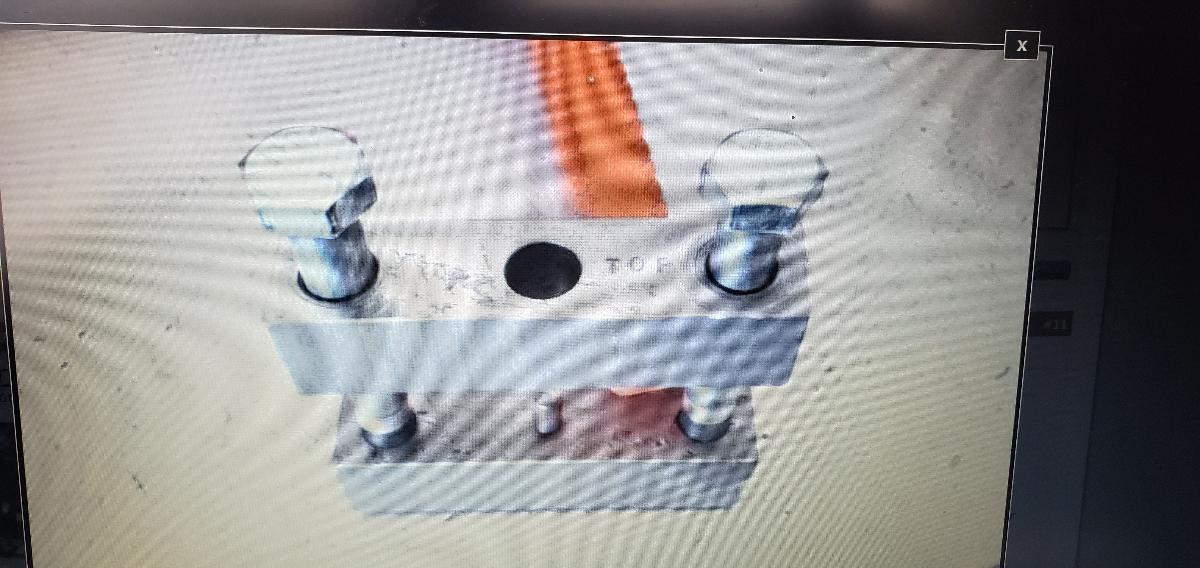

Better pictures of he tool.

If you don't have access to the proper tool, you can use a punch (suitable drift) of the correct diameter. The diameter of the punch should be slightly smaller than the diameter of the pin. Use a large hammer being careful not to hit the painted surfaces of the car while hitting the punch. Use a lot of penetrating oil first to loosen up the bond of the pin to the hinge.
Another option is to use a C-clamp with a suitably sized socket wrench located on the top of the hinge and a suitably sized bolt on the bottom of the pin to push it out. Be sure to first place a piece of rubber cut out of an old inner tube on top of the hinge to protect the paint.
