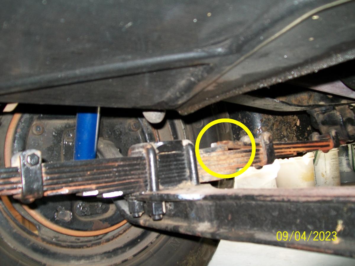

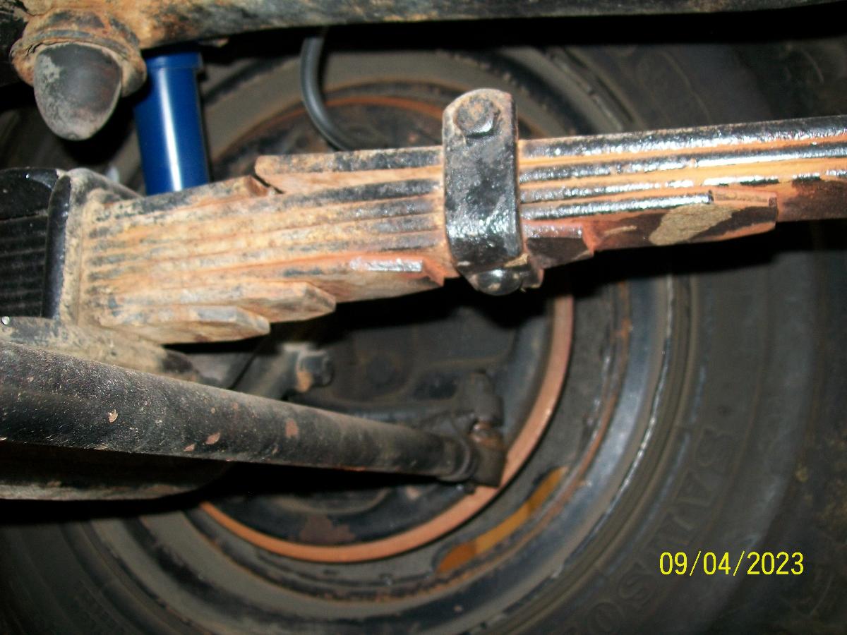

Here is the problem; I have a broken front right leaf spring. And, it is the main leaf spring, not just a smaller 'helper' spring.

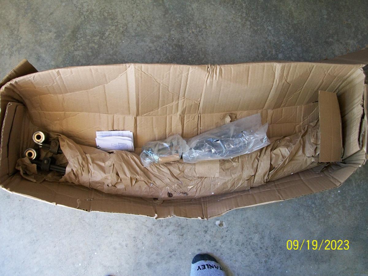

Your good advice is well taken. Thank you. I contacted Chuck's Trucks as per your suggestion and as it happens he had two NOS springs and spring accessories for my F-3. I ordered them up and they were delivered today. So all is good so far. I'm going to have a local guy (old timer that worked on these when they were the workhorses of the day) install them at his repair shop/garage.
