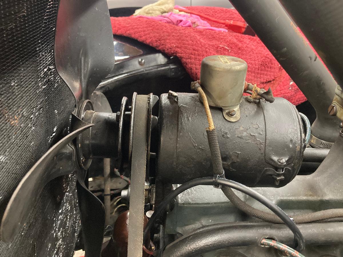

When I measured the voltage at the battery while the engine is running the voltage fluctuates back and forth from about 3v then to 5v then to 9v. Not exactly in that order but its all over the place and I expected it to be a fairly consistent voltage above 6v. Please forgive my ignorance but is the silver little round thing in the attached photo supposed to regulate or stabilize the generator voltage output?? The Amp gage on the instrument panel seems to be acting properly in that it is excited when I turn on the ignition, rev the engine or turn on the headlights.

I assume that you are usuing a digital meter to measure the voltage at the battery while the engine is running. Digital meters are very susceptible to interference from the high voltage ignition system. I suggest you use an analog meter for this measurement so as to get an accurate reading...

Analog meter please. The cut out disconnects the generator from the battery after the car stops. No regulation or stabilization, the voltage control is the center brush of the three brushes in the generator. Moving the brush up or down controls the voltage.
