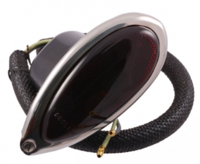

Should the tail light bezel retaining screw on a '39 passenger car be slotted or Phillips head?
The Dennis Carpenter reproduction shows a Phillips head, but I have my doubts. TIA

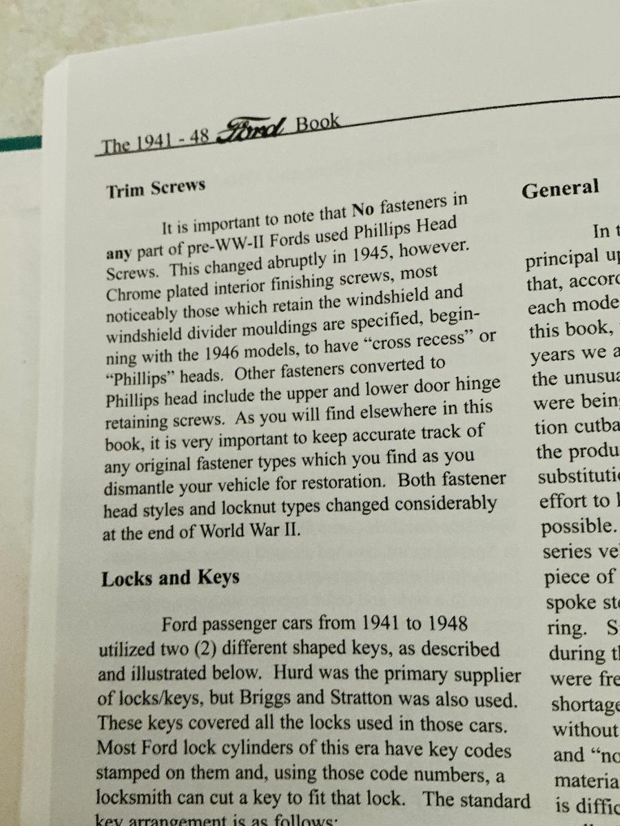

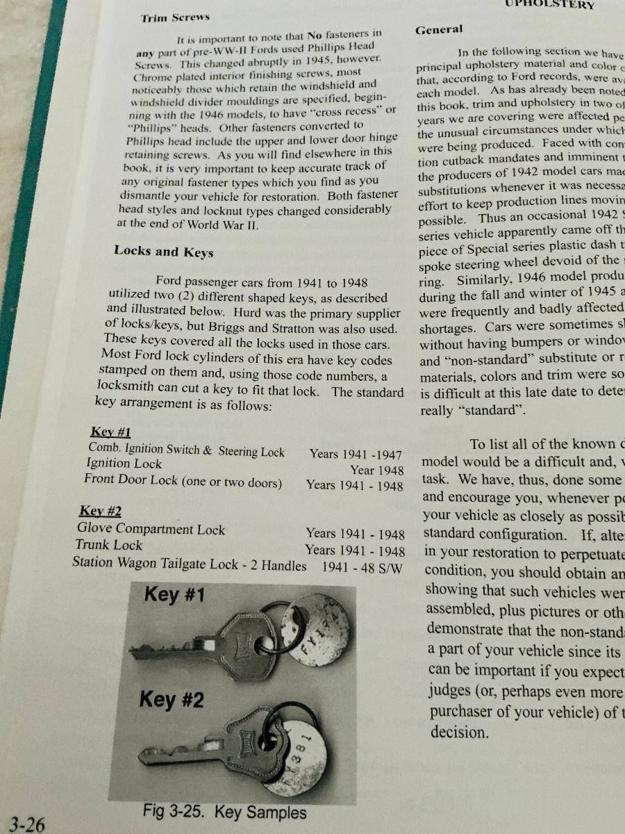

Here's what our good friend Al has to say on the subject:
cpipp01@aol.com

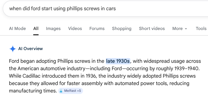

Here’s what are Best Friend says.
JayChicago
05-07-2026 @ 9:51 AM
Posts: 581
Once again we see that AI info may or may not be correct. AI searches the internet and consolidates what it learned into a general report. And we know there is a lot of bogus info out there on the internet. While the industry may have moved to Phillips screws in the late thirties, our experts know that Ford did not.
