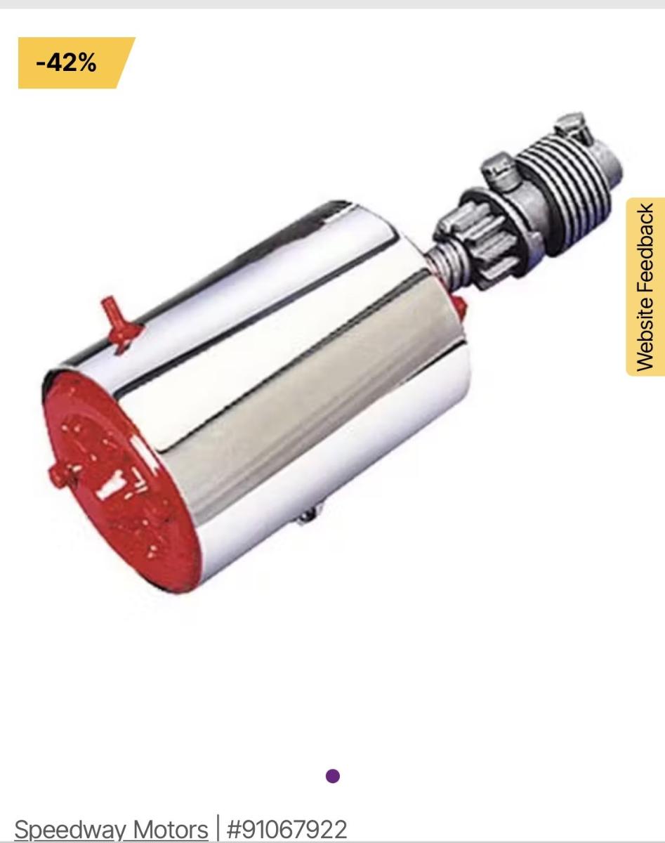

Thank you, I've been looking at these shields from Speedway. (photo below) Has anyone had any luck with these? Part of me thinks they'd hold heat in. I'm looking at a new Dennis Carpenter 6-volt starter with a modern Bendix. Then I can take my original to a good shop to rebuild it. Has anyone tried rebuilding the starter themselves? I'd really like to try it myself. I've rebuilt alternators etc., with good luck.
