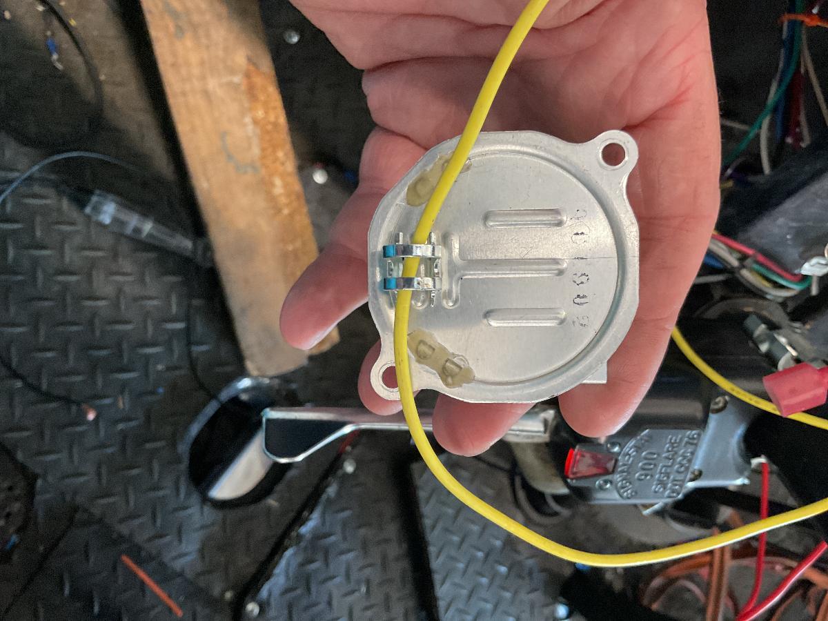

Here is photo of the back of the gauge. Does the wire have to come into physical contact with any part of the loop or just pass through?
Kens 36 |
08-15-2025 @ 11:48 AM
Posts: 405
It just passes through - no contact.
nelsb01 |
08-15-2025 @ 12:11 PM
Posts: 1095
But it does seem to be the incorrect gauge of wire. Should be a lot larger gauge.
carcrazy |
08-15-2025 @ 2:34 PM
Posts: 1975
The wire just has to pass through those two loops on the gauge, it doesn't have to actually make contact with the gauge. The reason for this is the gauge simply measures the electromotive force (EMF) of the current flowing through the wire. The EMF opposes the force applied to the indicator needle by a magnet within the gauge that tries to keep the needle centered.
JayChicago |
08-16-2025 @ 9:25 AM
Posts: 555
Is that the only wire you have going from the regulator to the battery? That wire has to carry all the current to/from the battery in order for the gauge measure charging/discharging.
