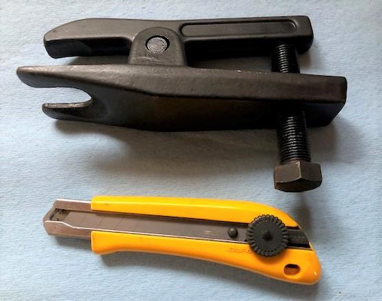

I bought this tool from a local tool supplier, but I believe they are available at a place like Harbor Freight. Not expensive, and small enough that it worked to get the shock linkage separated on my '46 Coupe.

The shock link is what connects the lever of the shock to the axle. The two studs on the shock link are a taper fit, similar to a tie rod end. The tool that 51 woodie showed may be helpful in separating the two parts. You might also check with your local auto parts store to see if they offer loaner tools for removing a tie rod end that may fit in the space you have.

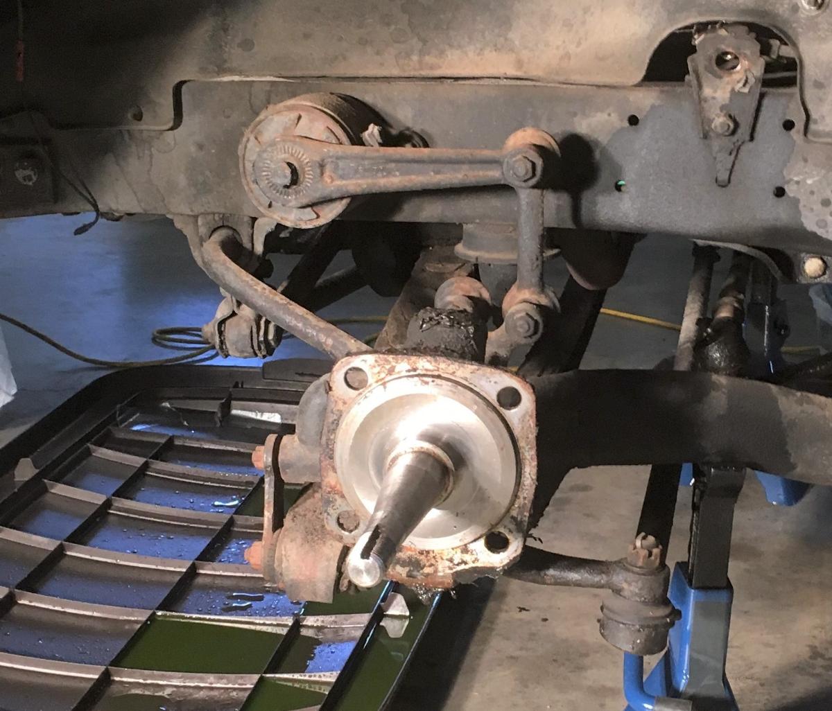

05-24-2022 @ 6:42 AM
I'm not familiar with '37s, but if the shock links are like the ones on my '46 Coupe, the nut you see in the picture holds the shaft of the link into a tapered hole in the shock arm. Using the tool I showed in my previous post, the U end of the tool goes over the stud between the link and the shock arm, then place the jacking bolt over the end of the link stud and tighten till it pops free. If you plan to reuse the shock link put a nut flush on the end of the link stud to protect the threads. When I replaced the shock links on the rear of my '46, the link studs were in so tight, that I cranked the jacking bolt until it wouldn't turn any more, then I had to heat the end of the shock arm a bit with a torch until it broke free.

I used tools similar to the one posted above by 51woodie to remove the shock links.
It worked GREAT!

Thank you everyone for your help. I bought the tool from Harbor Freight that 19 dollars that 51 Woodie suggested and it worked like a charm. Success thank to all of you!!
