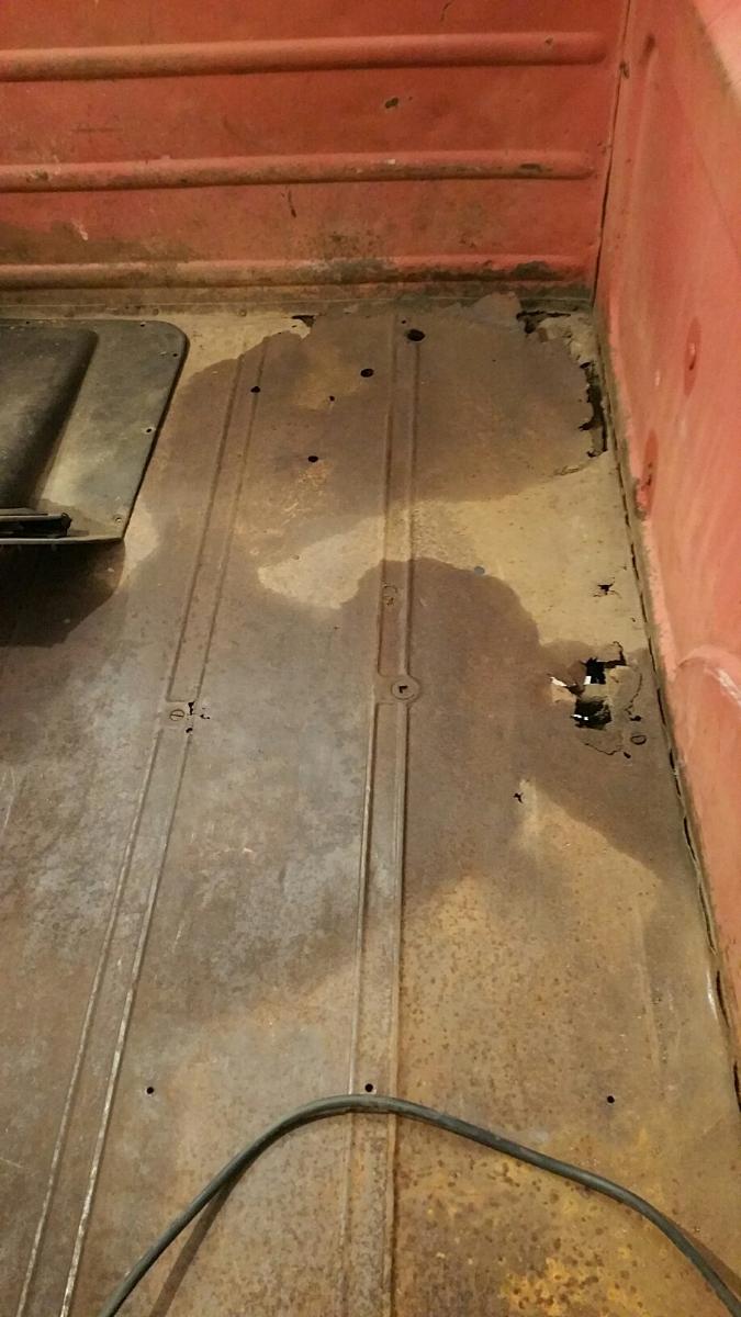

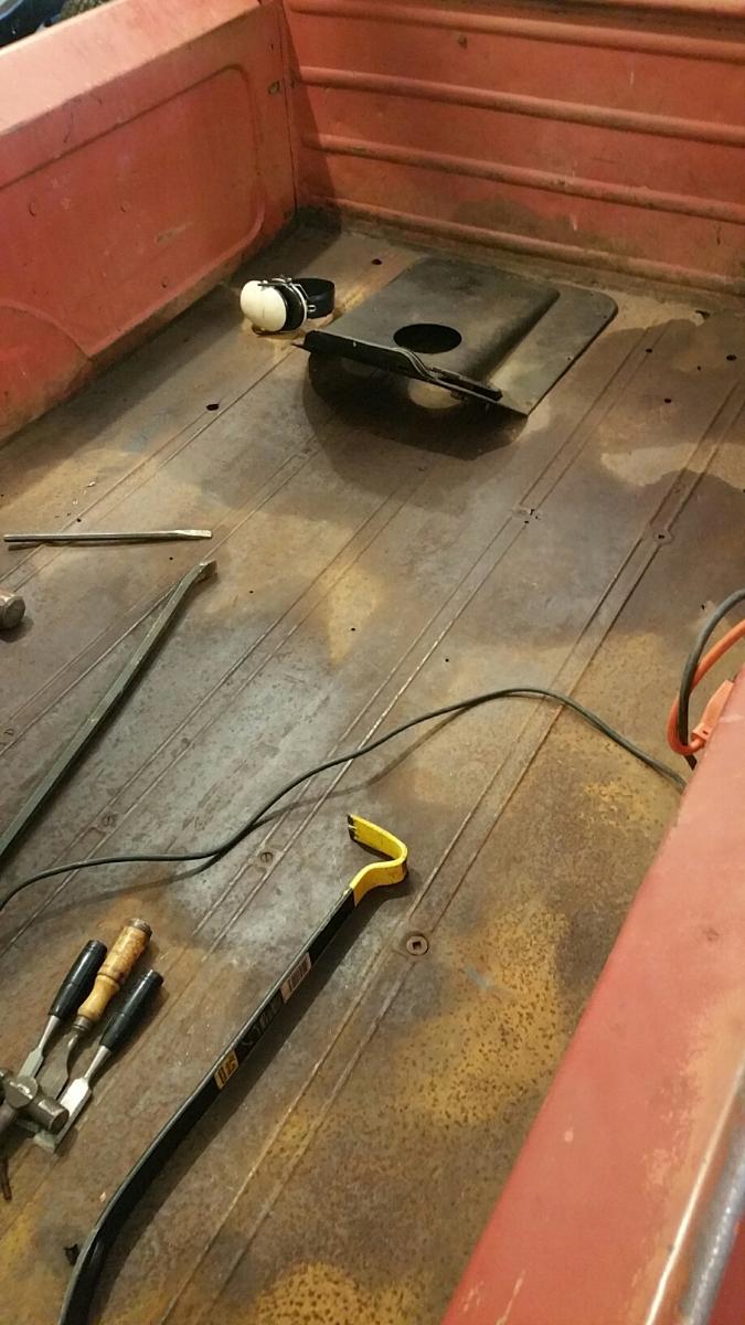

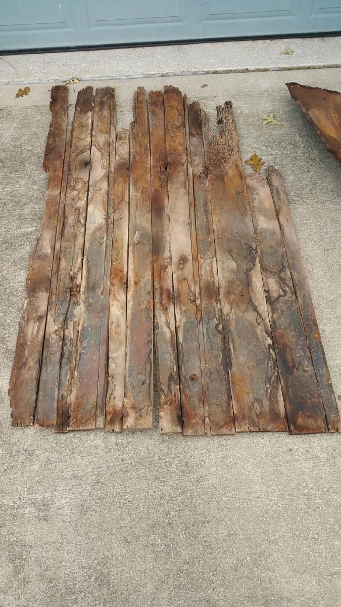

I'm doing a full restoration on my 1950 F-1. As you can see, the metal floor was in bad shape with the front right corner rusted out completely. When I removed the bed from the frame, I found a wooden subfloor consisting of several boards under the metal floor. I assume the wooden boards were put in to support the metal floor, but does anyone know if they are factory original? If factory, what is the correct number of boards, what kind of wood, and what thickness should they be? The old boards were in bad shape and I threw then away. Minor mistake on my part.

Yes the boards were original. And used for earlier pickups also.
The type of wood would have been what was probably available --- certainly hardwood from northern Michigan's Iron Mountain Ford Plant.
The boards were rough cut and with space between them one could guess they were 1 by 6.
I am sure a 1948 - 1953 pickup owner will be able to give you the exact information.

42 to 47 1/2 tons pickup had a wood subfloor with a thin skinned metal bed. I believe the same 1/2 ton pu boxes were used into the early 50's. Wood was oak rough cut 1" thick 6-8 " wide. Bolted to frame with metal bed bolted to wood & truck frame. Bigger pickups had a wood bed only with skid strips.

Posts: 4060
