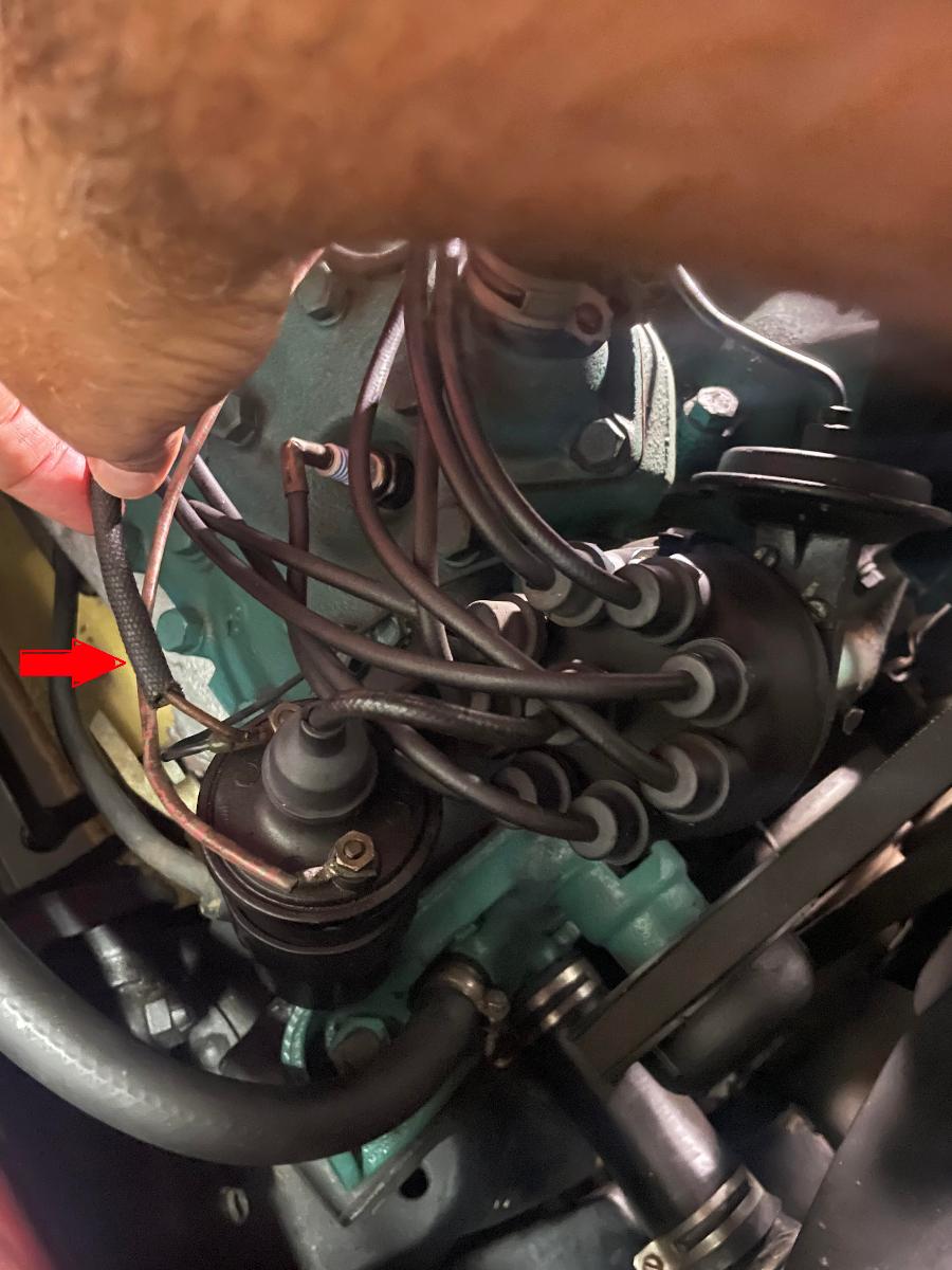

Hi everyone,
This cable (indicated by the red arrow in the photo) comes from the coil, but it isn’t connected to anything. Does anyone know what it is for or where it should be connected?
The only thing I’ve noticed is that the overdrive doesn’t work, or at least it doesn’t seem to be working properly.
Thanks in advance for any help!
Francesco

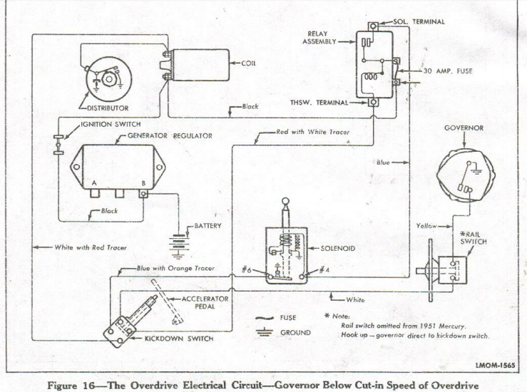

The extra wire on the distributor side of the coil should run to the kickdown switch that is part of the Overdrive wiring. See attached schematic.

Dan,
Thanks for your reply, it was useful ( also ) in confirming my doubt.
