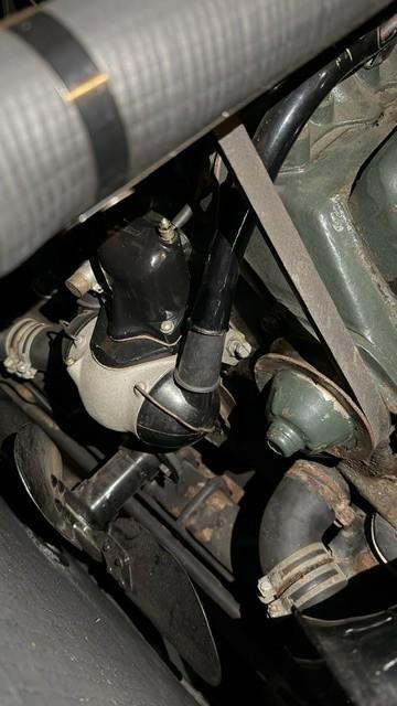

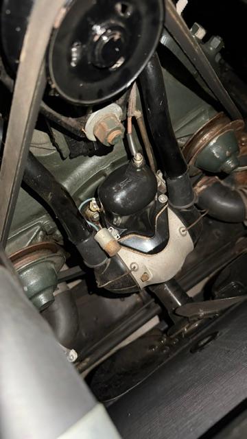

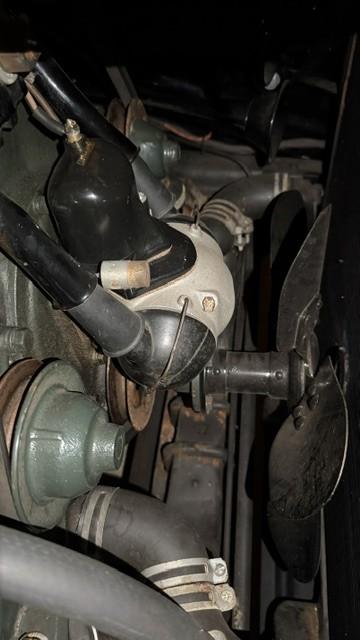

My caps and coil are brown - see attached pictures. You can also see here that my condenser is definitely different than what I've been shown to be the correct looking one. Sure, the one that I have might work, but I'm going back to an original looking one.

Your caps and coil appear to be black in your posted photos. I can see the improper condenser mounting of a later year condenser. For years finding good long lasting and proper mounting condensers has been a problem. Someone may have used a more dependable later condenser and found a way to mount it on your existing ignition.
By 41 most of the Carbon black was used in the war effort and Ford caps and coils were a brown to pale red color.
