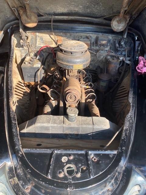

New to forum. I purchased a 1947 Lincoln Sport Coupe that has been in storage since 1961. 100% original, inside & out. Has some body surface rust but is laser straight. Beautiful paint and trim that cleans up nicely, see pix below. My intentions are to clean it up and try to get it running and to obviously keep it in its original condition.
Looking for ideas on how to get engine to turn. Not in a hurry, have removed spark plugs and spraying in Kroil 2x day. Have not tried to turn it over. Will not use starter, will turn is manually to try to get it to move. Never done this before, particularly on an original V-12.

Very nice looking car. The condition is very good considering the long storage.
I don't want to dampen your enthusiasm, but when a car has been parked that long, you should investigate why it was parked and not brought out of storage. There may be a mechanical issue that has to be taken care of before it can be made operational again. If it did not have an engine issue, it may have one when you try to turn over the engine with dry bearings.
You can get some lubrication to the bearings by using a pressurized tank of oil and forcing oil into the galley by the oil pressure port at the back of the block.
The engine has hydraulic valve lifters and they will most likely have to be removed from the engine, disassembled and cleaned, then checked for leak down before the engine can be made operational.
In addition to adding a penetrating oil (I prefer Marvel Mystery Oil) to the cylinders, I would remove the intake manifold and pour some down the intake ports and along the valve guides to try to free up the valves.
I would use the starter to try to turn the engine over. The front of the engine has a vibration damper on the crankshaft that can damaged easily and you may have difficulty in obtaining parts. Just tap the button on the bottom of the starter solenoid with no spark plugs.

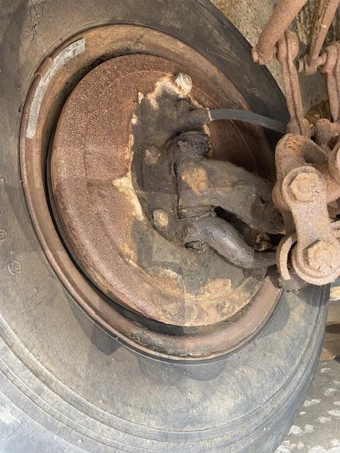

Front right brake draggy, need to adjust shoes inward so I can roll in/out of garage more easily. Not familiar with 1947 Lincoln, thought would be like Ford with eccentrics but obviously not. Any advice, instruction, diagrams greatly appreciated.
This message was edited by billearls on 7-16-23 @ 8:12 AM
07-31-2023 @ 5:08 PM
Posts: 7205
Sorry about the delay in getting back to you. Your Lincoln has Bendix brakes with a star wheel adjustment. Look for a slot at the bottom of the backing plate with a rubber plug in it. Remove the plug and use a brake adjusting spoon or a screwdriver to turn the star wheel. The wheel should turn up to loosen the adjustment and down to tighten the adjustment. If i am wrong about the direction, you should know in a short time as the drum will drag more on the shoes as you try to loosen the adjustment.
There may be another reason that the shoes are dragging, so if the adjustment doesn't work you will have to remove the drum to find the cause.

Thanks Tom. I attended the July meeting in Arlington Heights and was instructed then to look a little closer. Clip on back plate much smaller than I was used to on my prior 1962 Chevy so did not see it on my Lincoln initially. Got brake adjusted so can roll out of garage.
