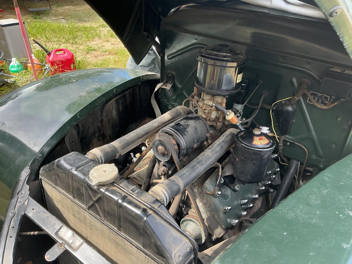

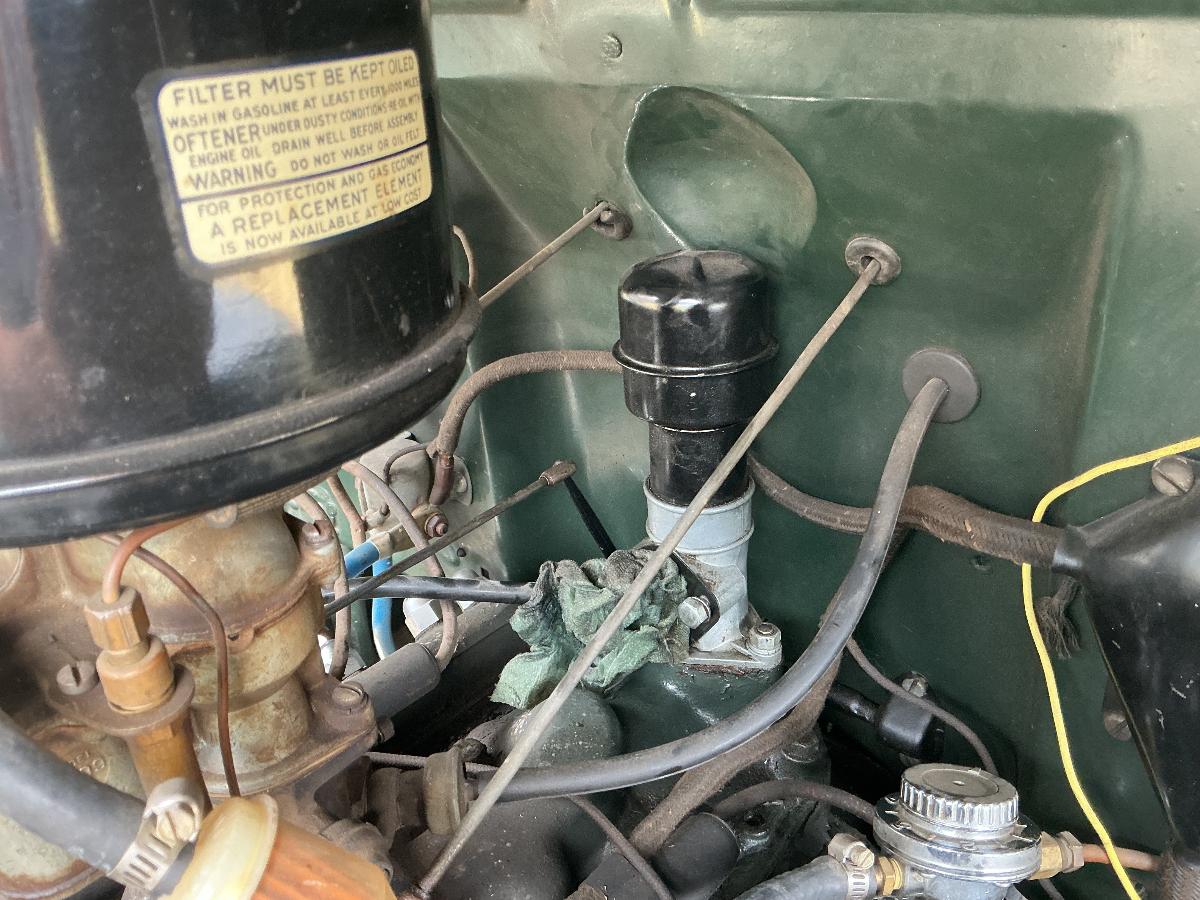

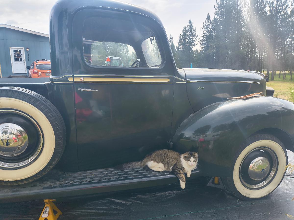

Hi guys, I inherited a 1940 Ford pickup from my Dad and my goal is to get it running again. But, I know nothing about it as he bought it and then it sat for many years in his shop. Anyway, I am trying to figure out what goes where the paper towel is at in this picture. Help please!
On a side note, how do I tell what type of engine is in it? I’ve looked for a stamp and cannot find one.

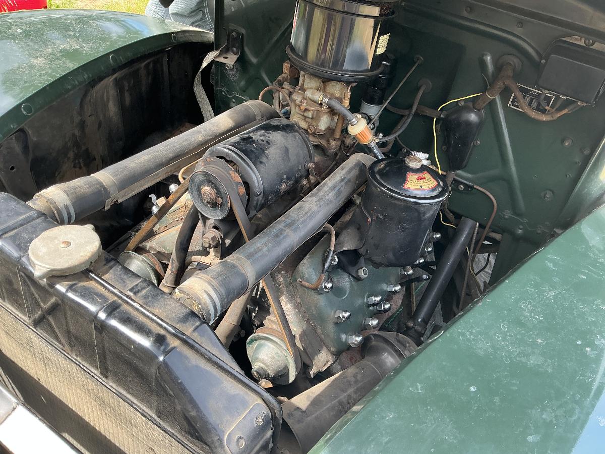

The mechanical fuel pump goes where the toweling is. It appears an electric pump was installed, and the authentic mechanical pump was bypassed.
If you post more photos, we can identify what engine is in your truck. There are no stamps to identify the block.
I'd like to see a photo at the front, looking down between the distributor and block. Also, a photo of where the intake manifold (properly termed "valve chamber cover") is bolted to the block.

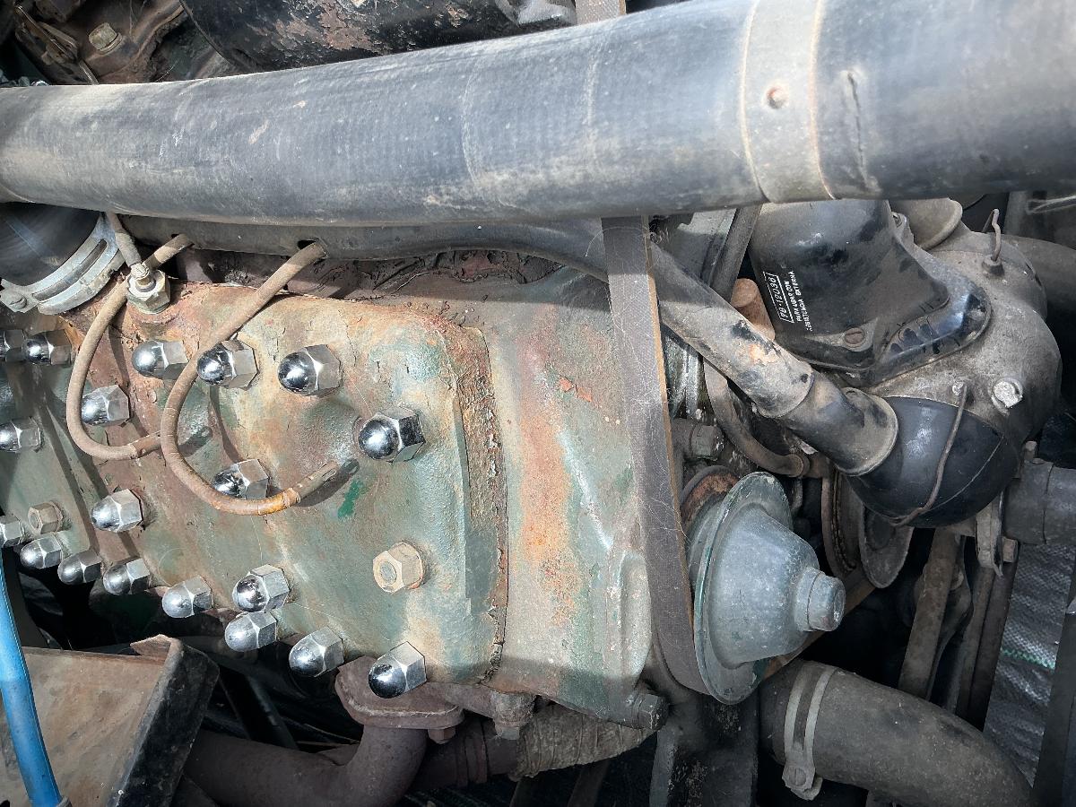

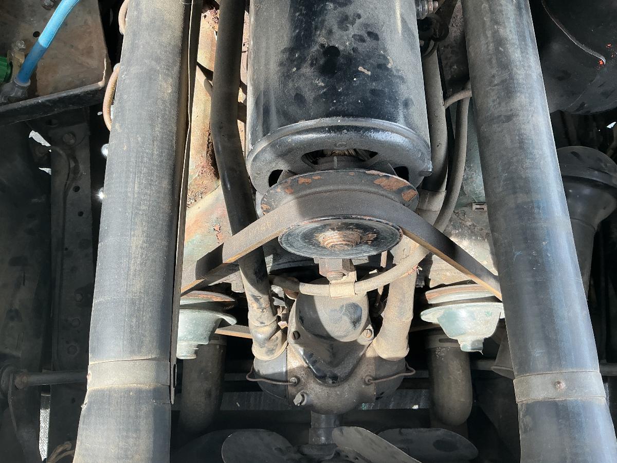

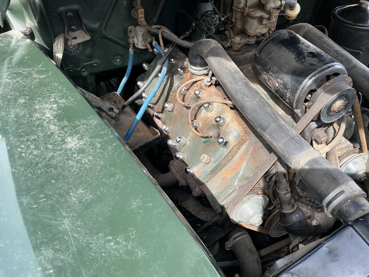

Thank you for the quick response. Here are a few photos of the engine.

The engine appears to be correct for your '40. There are a number of things that are not correct. If you'd like my help with this project, I'm here for you.
