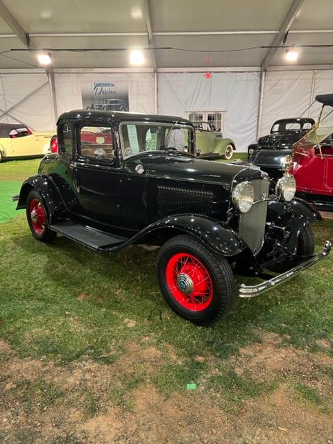

My 32 5 window coupe runs great and everything if good. But when I applied the brakes, and hit a bump, the front ent started to shake something terrible. Then it started to steer hard and jerky. Can anyone tell me what is going on?
