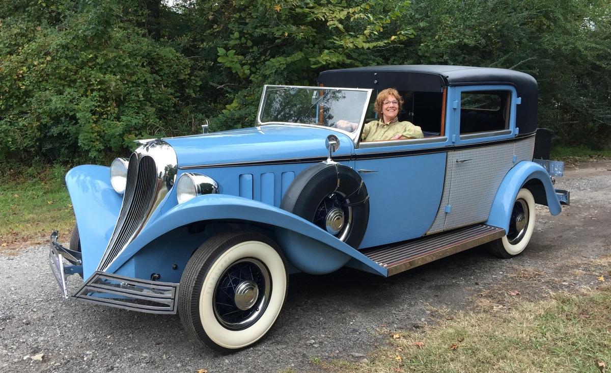

It is not dramatic, but sometimes while driving in second gear and it pops into neutral. The rest of the car is fine. Should I be looking at an adjustment? Certainly not bad enough to pull the transmission. Bill Wife, Anne, loves to drive 'her' Brewster!

Best to live with it if a new detent spring doesn't help and you don't otherwise have a good reason to pull the transmission. It is a commonplace problem. Neat car, by the way!
