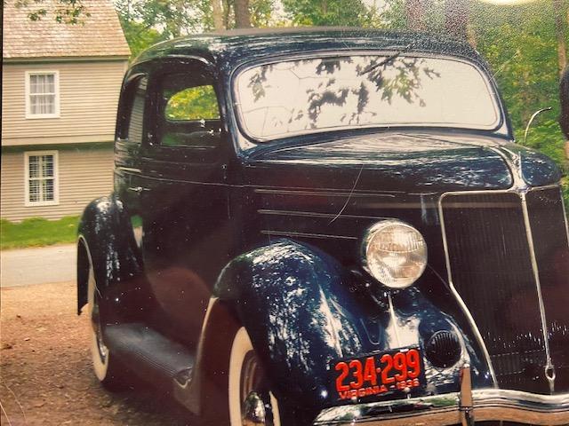

Has anybody figured out how to prime a fuel pump without a proper electric pump after the car has been sitting a week or more. I Installed an "ES8902 AIRTEX" electric pump and it worked great for 6 years. Cannot find replacement, not made anymore. New Part with same stock number does not work the same as the old one. Any suggestions? Checked Carter Pumps and they do not have it or could not recommend nyone.
