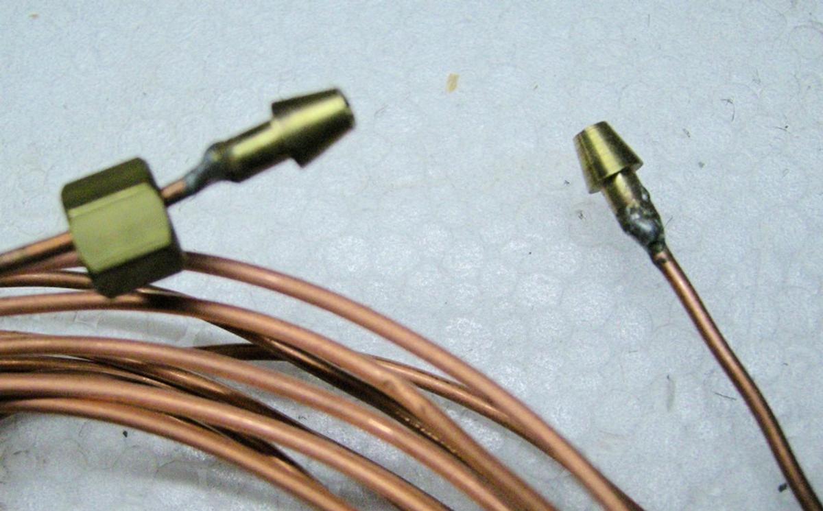

Jim,I bought my air line kit from The Early Ford Store and the copper line slipped right in the cone fitting-no problem,then I soldered it.Here is a pic. Sheldon
