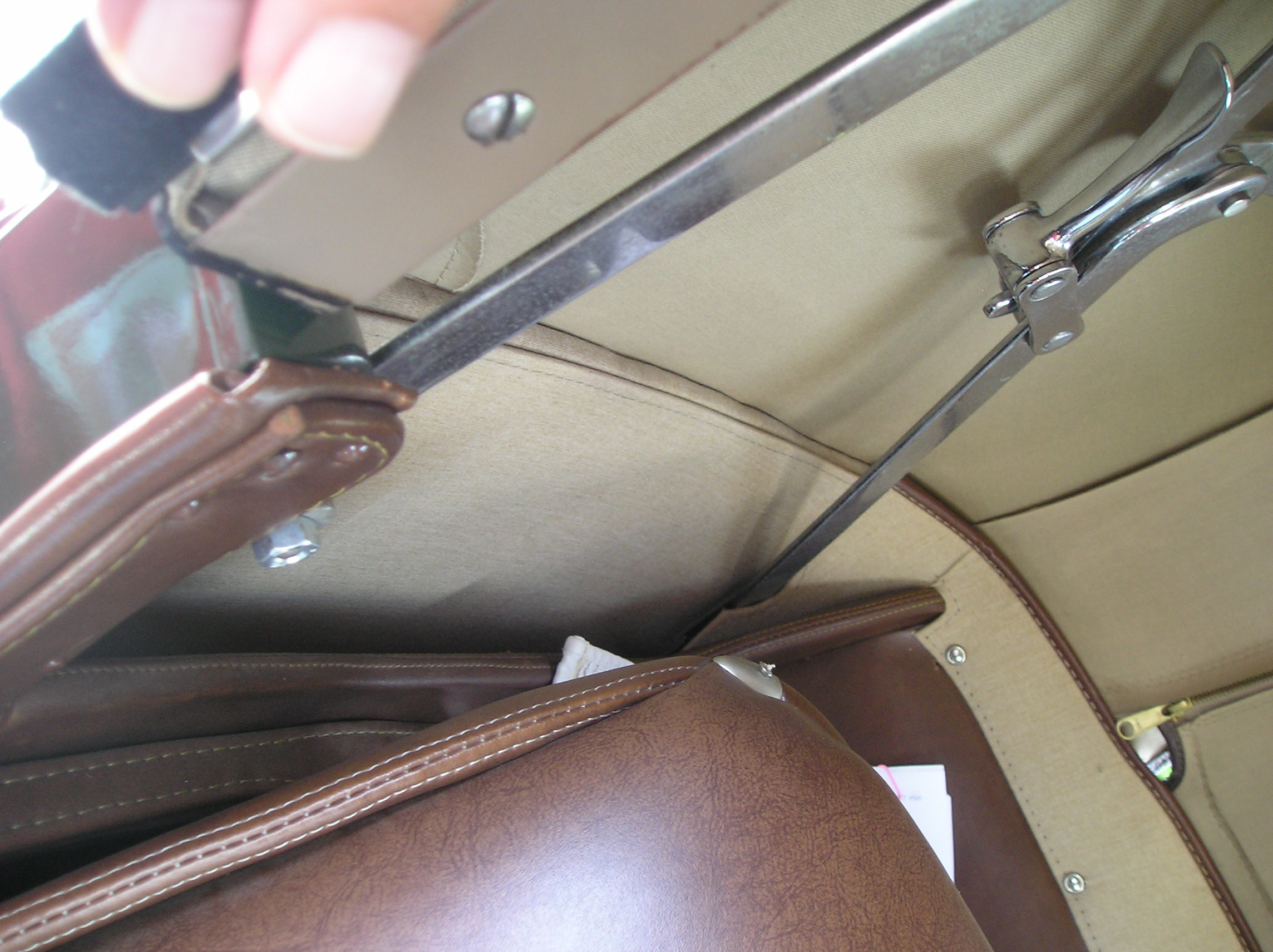

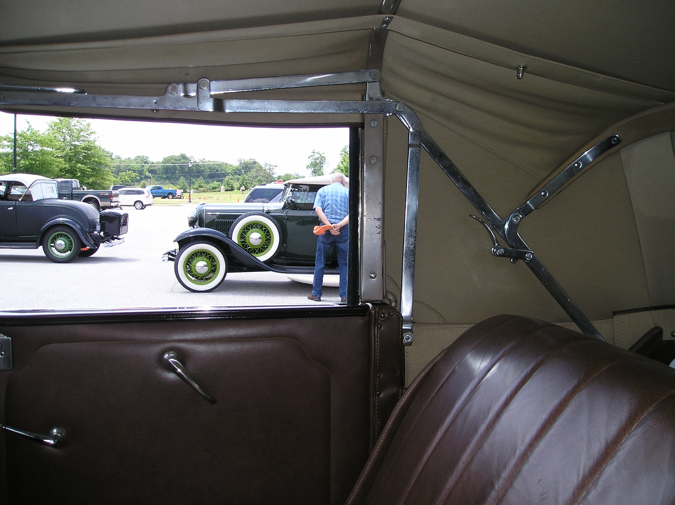

I was at Dearborn this year and had hoped to see a Cabriolet. I was looking to take photos of the top irons and how all the rollers go in position. I even went so far as to try and get the Ford Museum to let me take some of the one that they have, but they would not let me open the door to take a photo. So, my question is for any Cabriolet owners out there. Can you post a few photos of the top irons in your car so that I can be sure to assemble mine correctly? Thanks.

3w2
10-22-2018 @ 5:02 PM
This photo may be of assistance.
3w2
10-22-2018 @ 5:03 PM
And this one.
