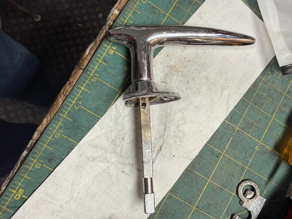

The shaft is square but on the 36’s handles the portion that turns the mechanism is rounded so in order to open the door I have to pull the handle out 1/2”.

Here is a door handle 35 that I bought off of eBay in photo one you can see the rounded portion on the shaft photo two shows that the length is too long as it come past the inter part of the door. So cutting it would not be an option. Trying to to get the shaft out of the handle I broke the fastener plate. The 36 deluxe hands I have are the same length.

If you want to use the handle you have, you will have to weld extra material all around the cylindrical section of the square shaft, grind off the excess material to allow a square crossection of the shaft to engage the lever.

1935 outside door handles are different for different body styles. What is the body style for your car?

I agree with V8'er. There are 10 different door handles foe 1935. What is your body style??

3 window coupe
