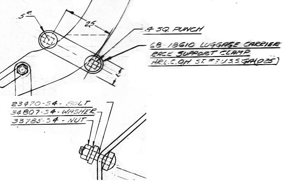

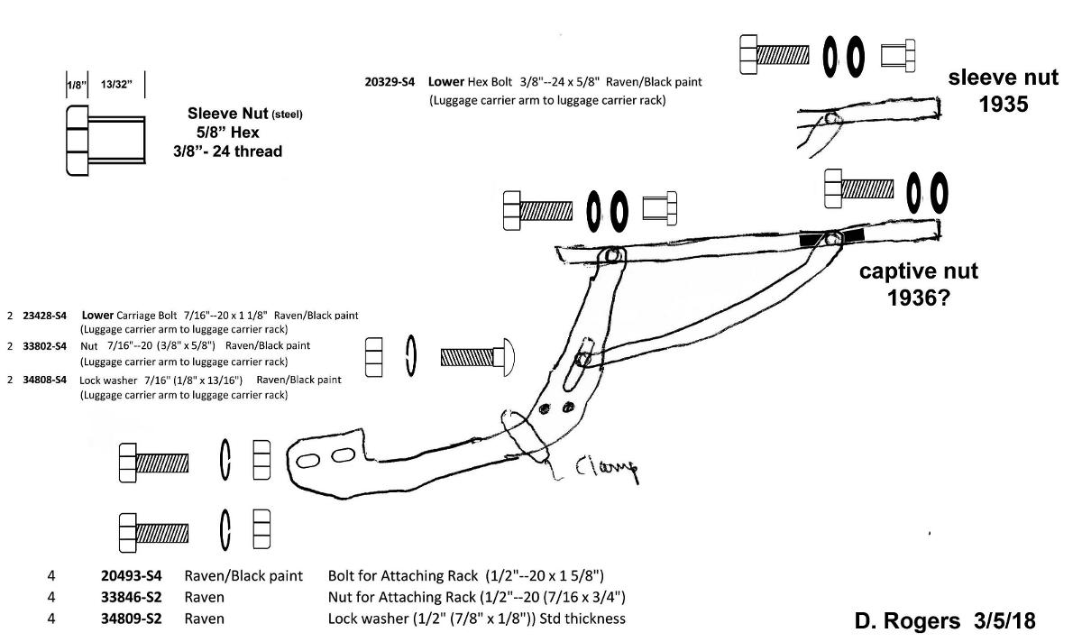

Does anyone have info, drawings, instructions or photos, of how to install a 1935/36 Ford Luggage Rack?
Don Rogers
01-06-2026 @ 10:05 AM
Posts: 515
See if these drawings will help you..

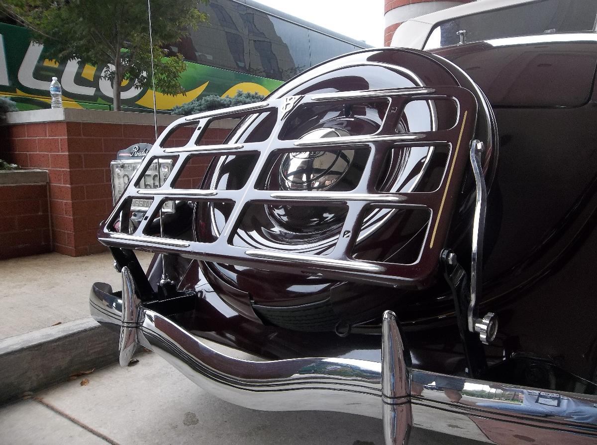

Perhaps this 2014 National Meet photo would also be of some assistance ........
Grant
01-09-2026 @ 9:46 AM
Another photograph from the same meet.
This time, a very nice '36 roadster with its trunk installed on a luggage rack ........
