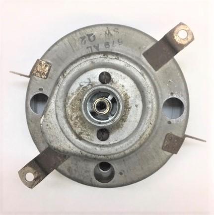

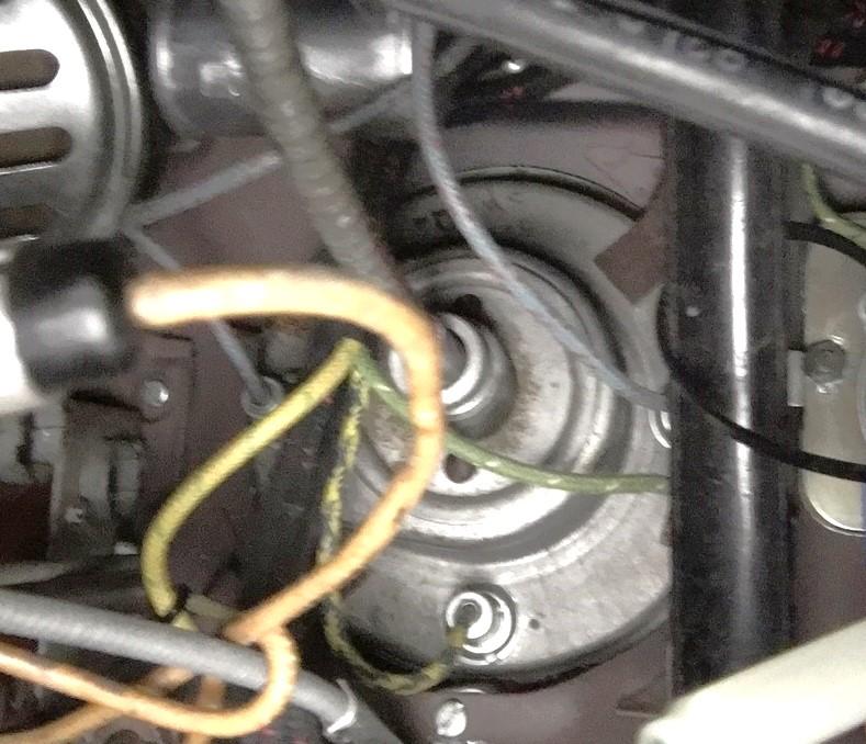

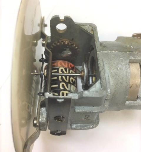

ford38v8 offers good advice. I took the speedo out of my '46 Super Deluxe to repair the odometer section, and took a few pics. There are three light sockets to remove, two for lighting and one for high beam indicator. The cable nut is likely hand tight, and there are two nuts with washers that hold the housing in. I suggest you disconnect the battery while working under the dash. First pic is what the speedo looks like internally.
