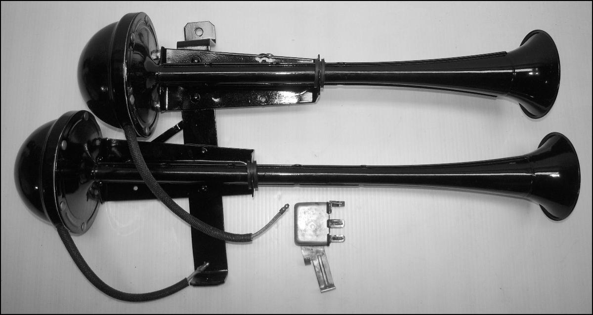

In 1939, there were two versions of horn assemblies. The first version had two points of attachment in the proximity of the body. There were two additional points of attachment close to the end of the trumpets. In that location a separate bracket was utilized. I have attached a photo of that assembly (partly disassembled).

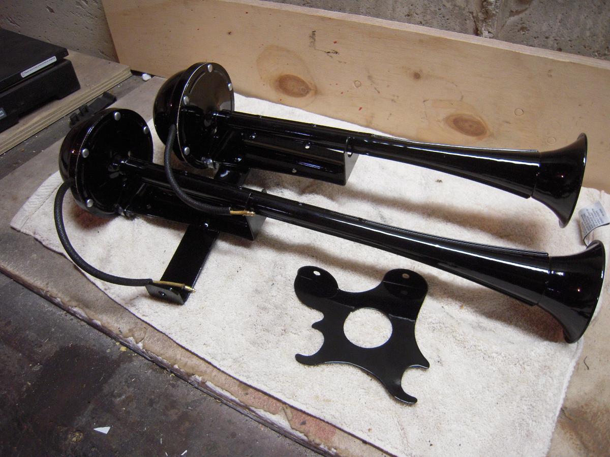

Very late in 1939 the design was changed. So very late '39 though all of 1940, the second design was installed.
Please note the photo I'd attached showing this (second design) style. Note specifically the addition of the angular brace integral of the bracket. With that addition, there was no longer a need for the earlier secondary brace. Most likely a cost savings change of design.
I have seen the caps that were snapped on. My research did not show this build option within the engineering release. I can only offer a guess as to why these have shown up. That guess? Most likely a deviation from the blueprint taken by the supplier of the horns to Ford. This type of deviation happened occasionally, and it appears that if it (deviation) did not cause any issues, Ford accepted the part(s).
When judging a concourse, I expect to see the earlier version on a 1939 passenger car built through at least February 1939. After that I would accept the second design. In 1940 I would NEVER accept the first design.
