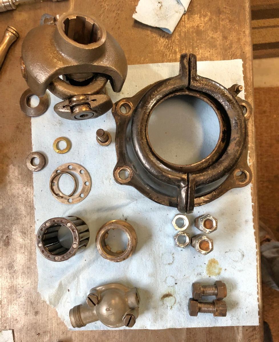

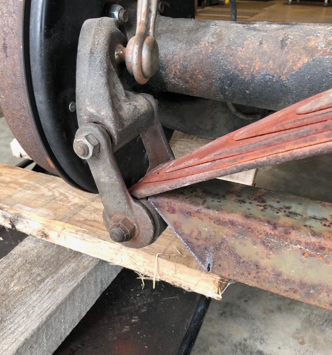

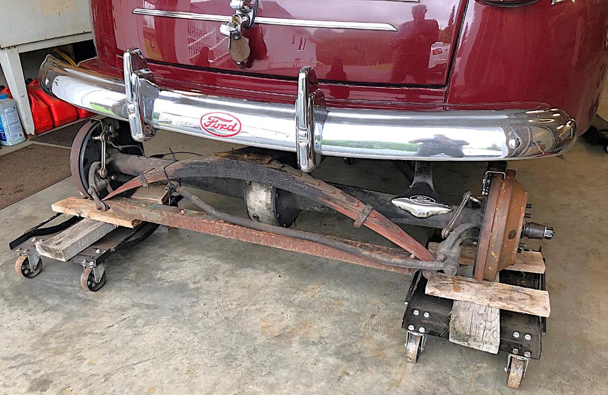

I used a 1/8x2x2x44" length of steel tubing, with the ends mitered at 45deg. and placed the pointy end in the spring eyes (see pic) then jacked the rear of the car up. I placed a floor jack under the diff and disconnected the two U-bolts that secure the spring, then lowered the axle. You will need to disconnect the speedo cable from the "turtle", the brake flex line and e-brake cable, then remove the four bolts that hold the "clamsh*ll to the trans. I had to remove the floor panel over the trans to access the clamsh*ll area. It is best to have some blocking or such positioned where the "wishbones" attach to the driveshaft to support it when the d/s comes way from the trans.
One thing I did was to check the torque on the bolts that connect the u-joint housing the the back of the trans, and found two were tight and the others were "snug". you can only get at them when the d/s is out of the way. Also the "nut" that connects the speedo cable tot he "turtle" is a very fine thread and easy to cross thread, as a previous owner did to mine. I found it a challenge to get the d/s inserted into the splines on the u-joint when reassembling. Long needle nose pliers did the trick.
Reconnect all the parts and pieces, then bleed the brakes.

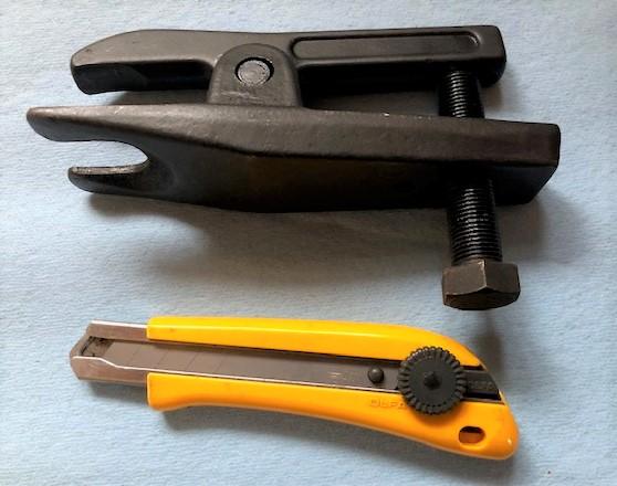

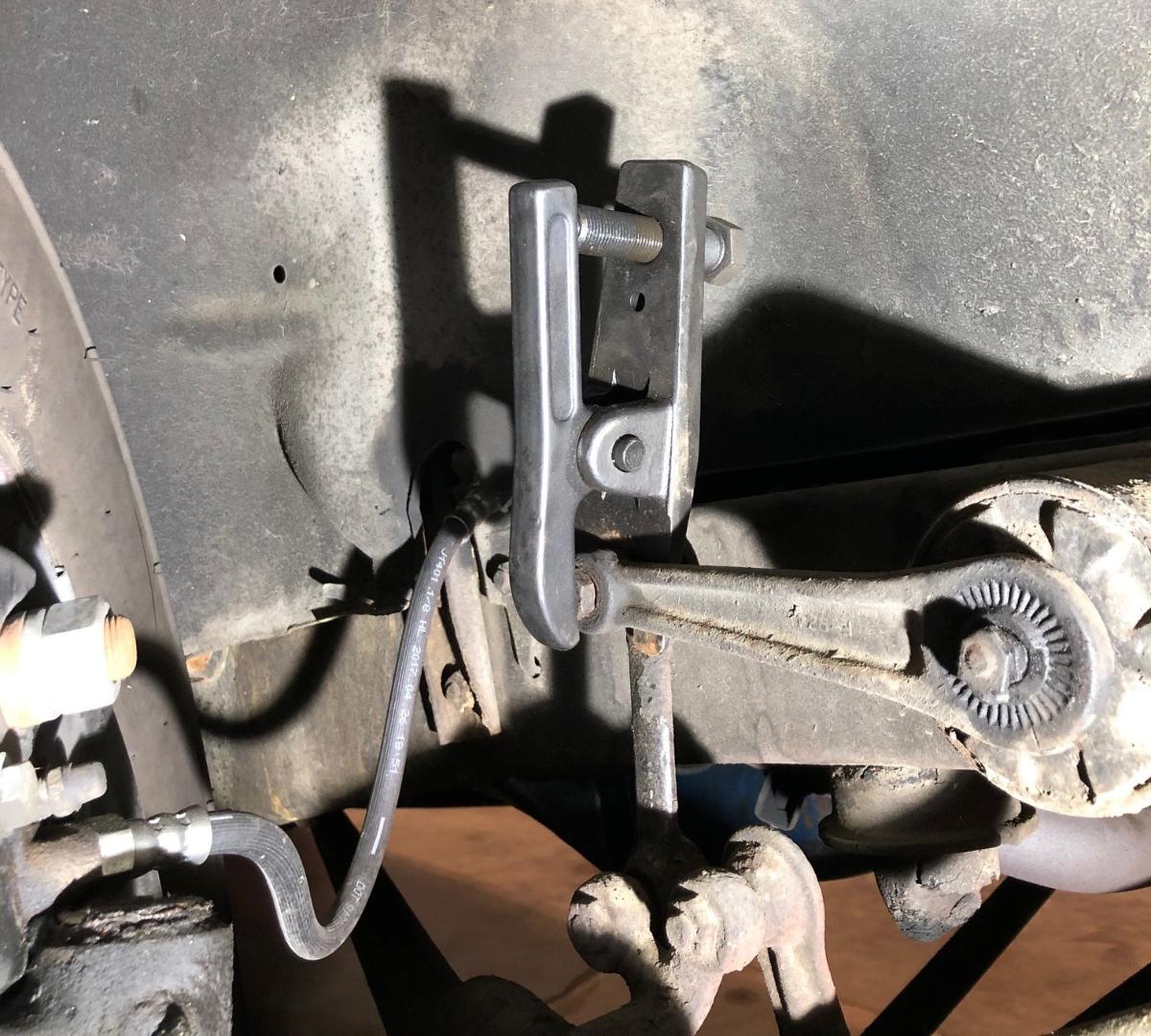

I forgot to mention that the shock links (depending on you car type) will need to be disconnected. Loosen the link nut until it is flush with the end of the threads, then use the tool to free the link stud. I think these tools are available at Harbor Freight.
