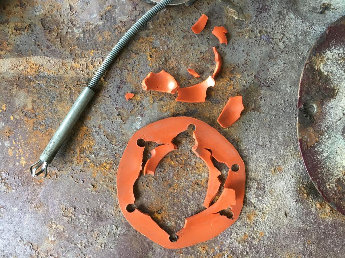

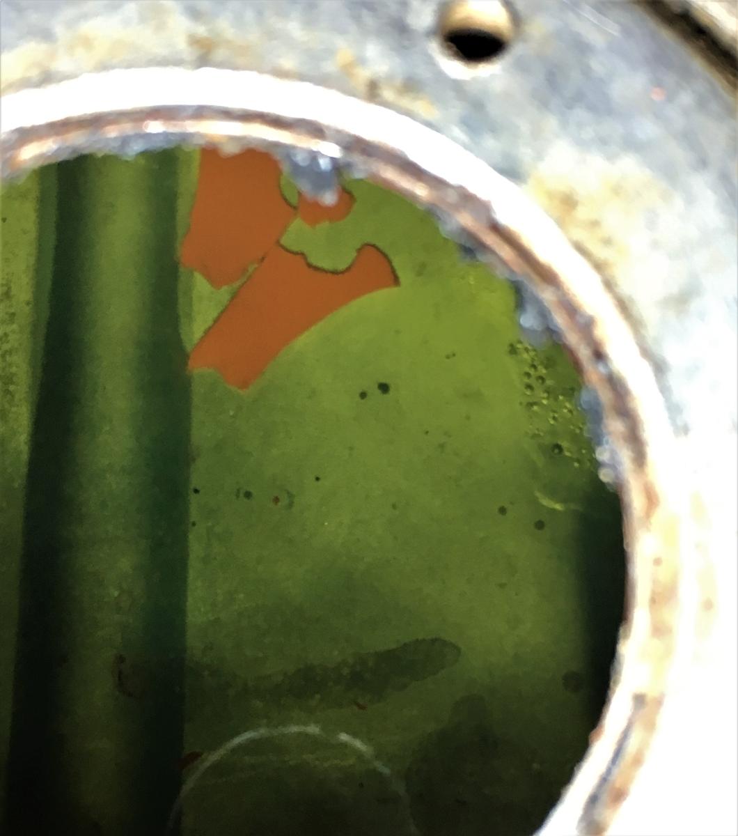

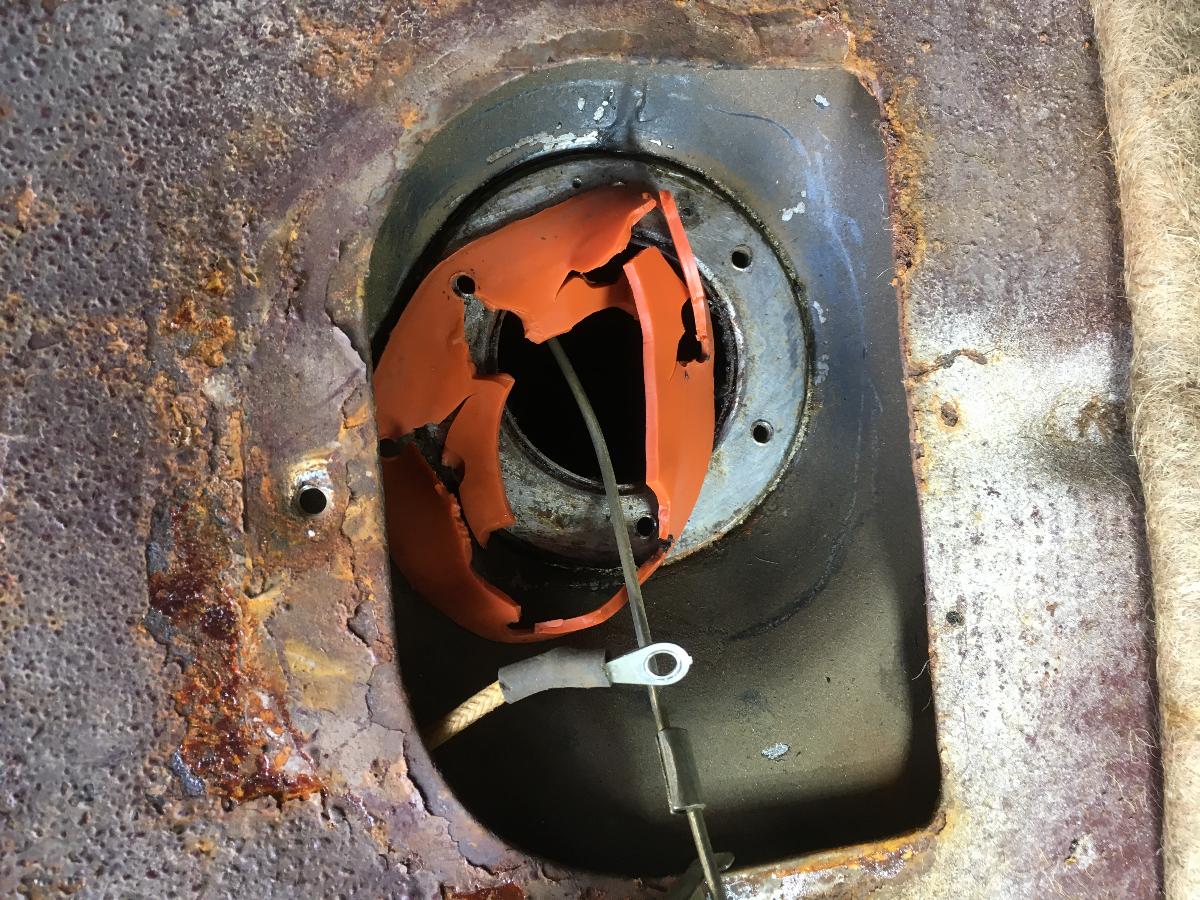

You never know what you will find in a fuel tank. The fuel gauge was not working when I got my '46 Coupe, so I pulled the fuel sender, and found a previous owner had used "red rubber" for a gasket. The fuel partially dissolved the gasket, causing pieces to fall into the tank. Had any of those pieces blocked the fuel pickup, it would certainly have cased troubleshooting issues.
