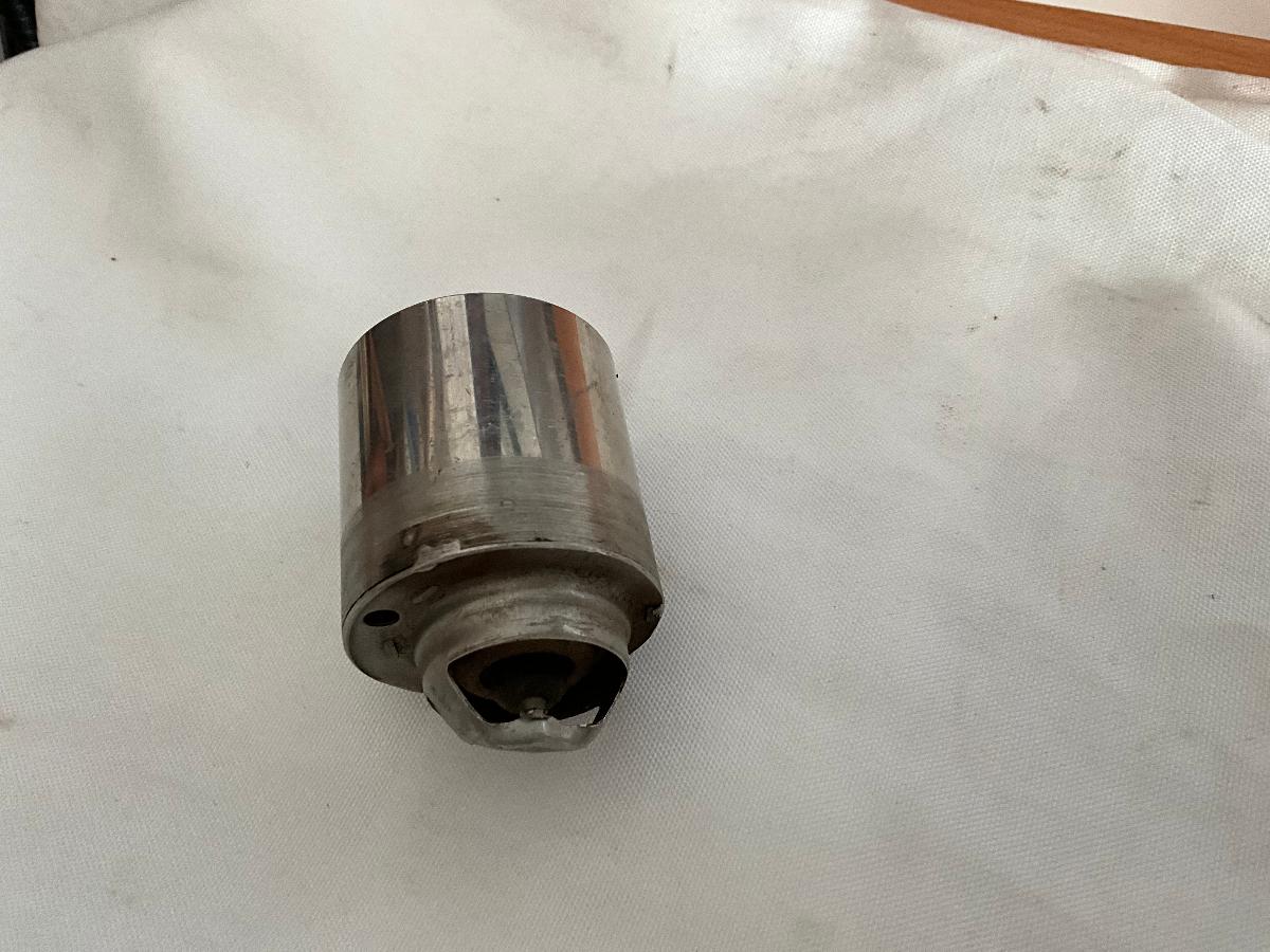

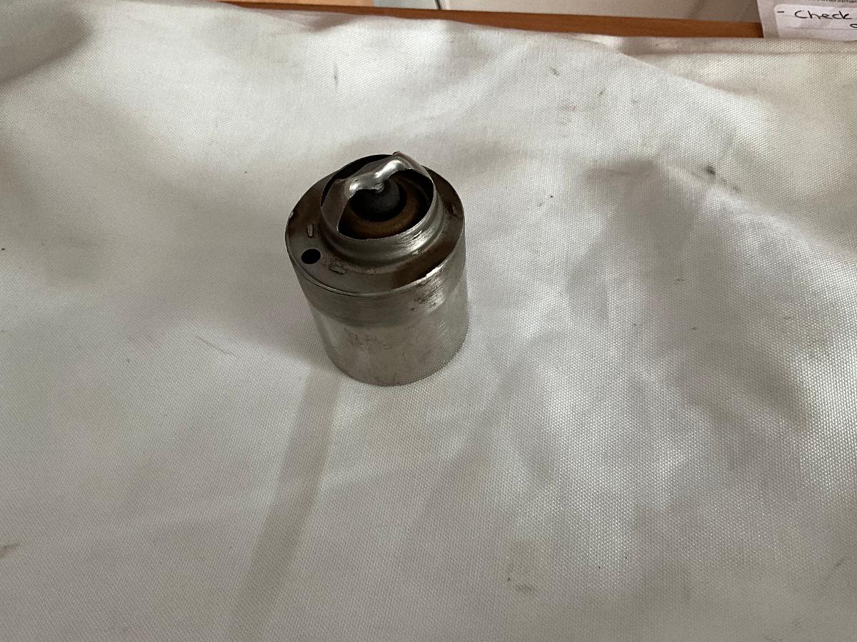

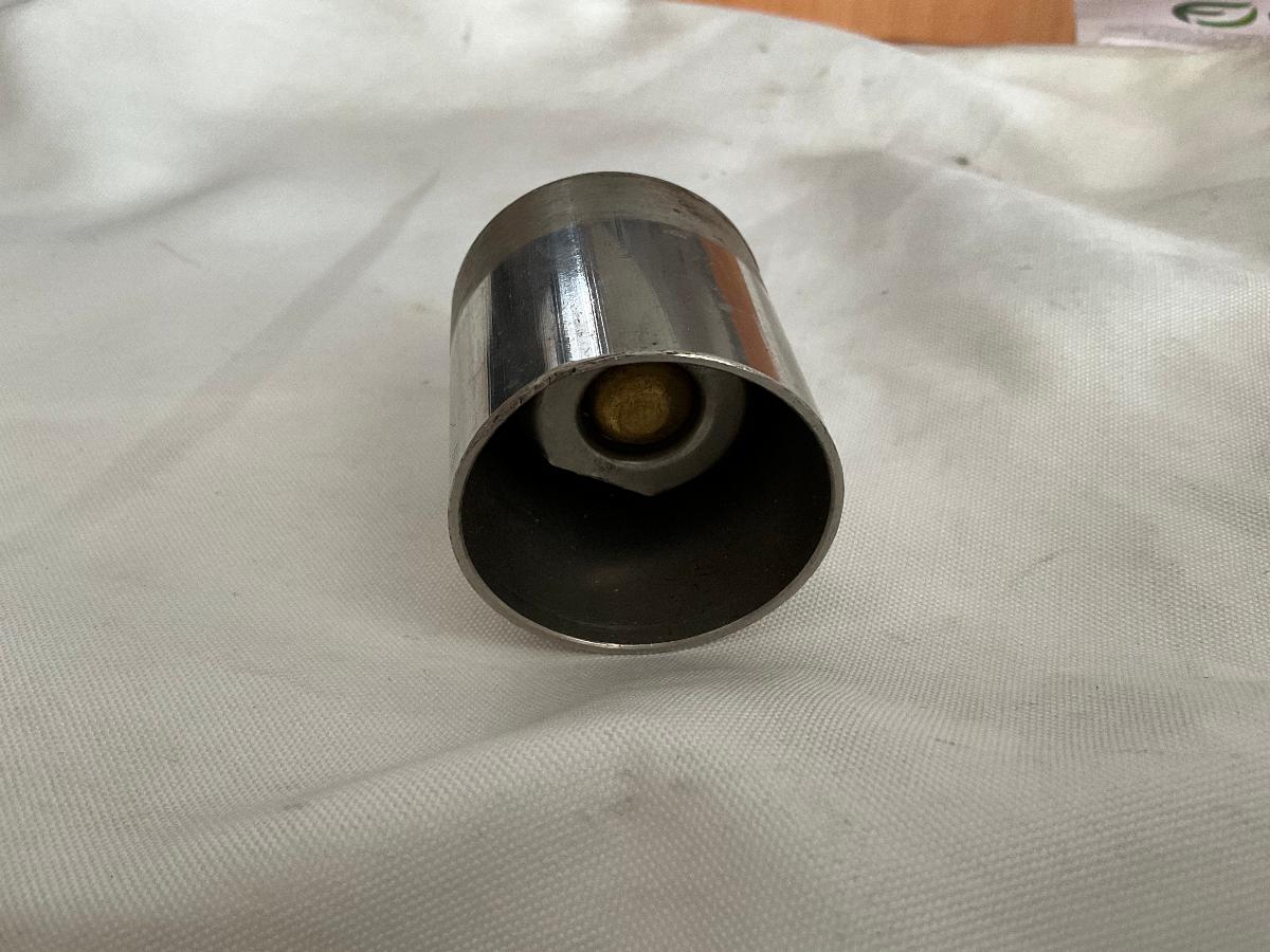

Get a modern one and then get a short length of SS tube that will push up in the upper hoses. Get some one to tig weld the T/stat onto the tube,You may need to file or machine the OD of the T/state flange down to be the same OD as the tube, then just push them up into the top hoses
Let me know if you want a pic.

lawrie
08-24-2024 @ 5:26 PM
Posts: 40
Joined: Oct 2012
Hope these come out
I have these in my 33 , 34, and 28 model A
Lawrie
