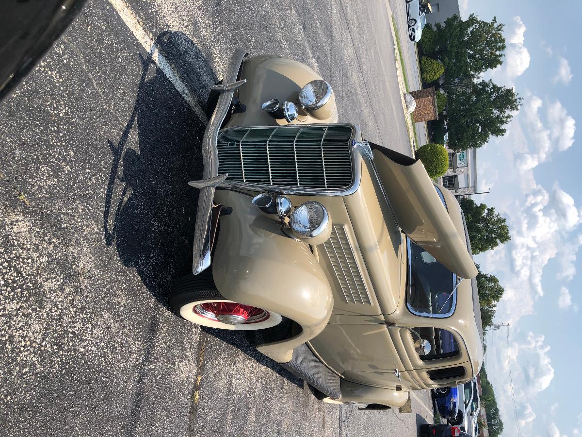

First welcome. Your car looks great. Now a couple of suggestions.
1. Put your general location and email into your profile.
2. Start a new discussion and delete this one. Otherwise, it will soon become difficult to know if comments relate to your problem or flatfoot’s problem.
3. Join a local club if you haven’t already (see https://www.earlyfordv8.org/Regional_Club_Directory.cfm). Ask if anyone has a speedometer they could loan you to see if that is where the problem is located.

Hello all, I just became the proud owner of a 1935 4-door. The speedo does not work. I do have rotation of cable at end by speedo. I have zero history or anything other than a set of keys and the title. I’m hoping speedo is good but speedo cable is wrong or not engaged. Any help is appreciated.
