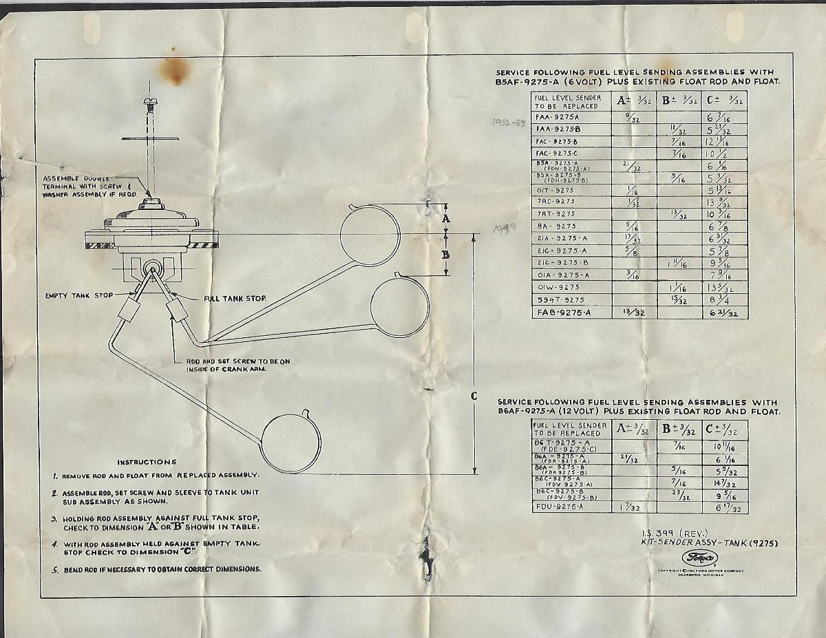

Here is a link to the AACA that has information on fuel senders. I could be wrong, but I believe the senders function the same. I salvaged a sender from a '51 sedan, cleaned it up, configured the float arm travel to match the tank it was going in to, and it is now working in my '46 Coupe.
A good reading for a fuel sender is zero ohms. The attached chart is for a '51, but will give you a general idea for setting the float arm travel.
