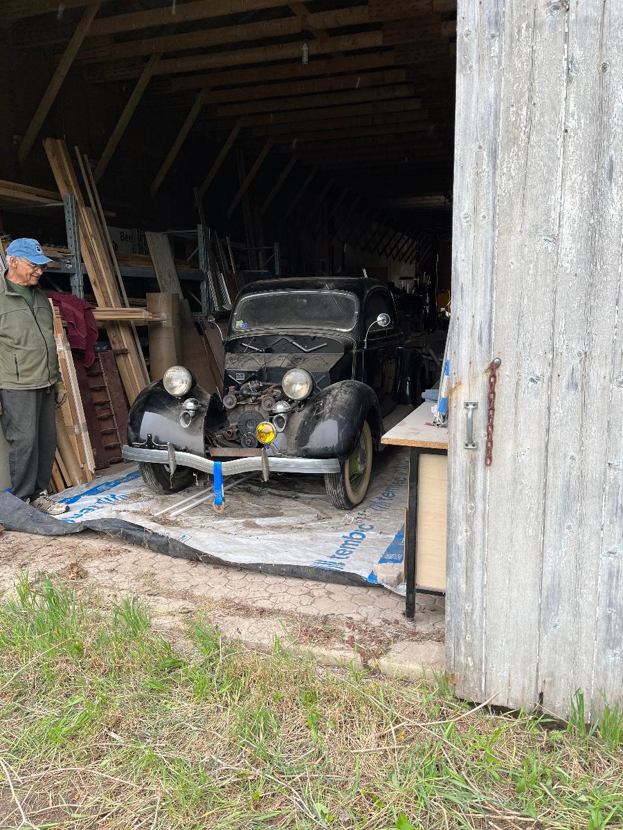

Have my "barn find" 35 - 3 window coupe home and want to remove engine and transmission.
The rad, grill, front bumper, intake, distributor and spark plug leads, generator have all been removed.

The car had been stored since 1990 and is remarkable condition. Car was put into storage due to lack of funds to deal with overheating problems.. engine has a "tight" spot as you rotate the crankshaft.
The car was restored in the seventies and has all original panels and no rust.
Plan is to keep car pretty much original ... will change engine to rebuilt and updated 24 bolt version but will keep original engine aside.
Any help/advice will be greatly appreciated .. Thx Rudy
(will post a few pictures as it emerges from the barn and after a wash and cleaning)

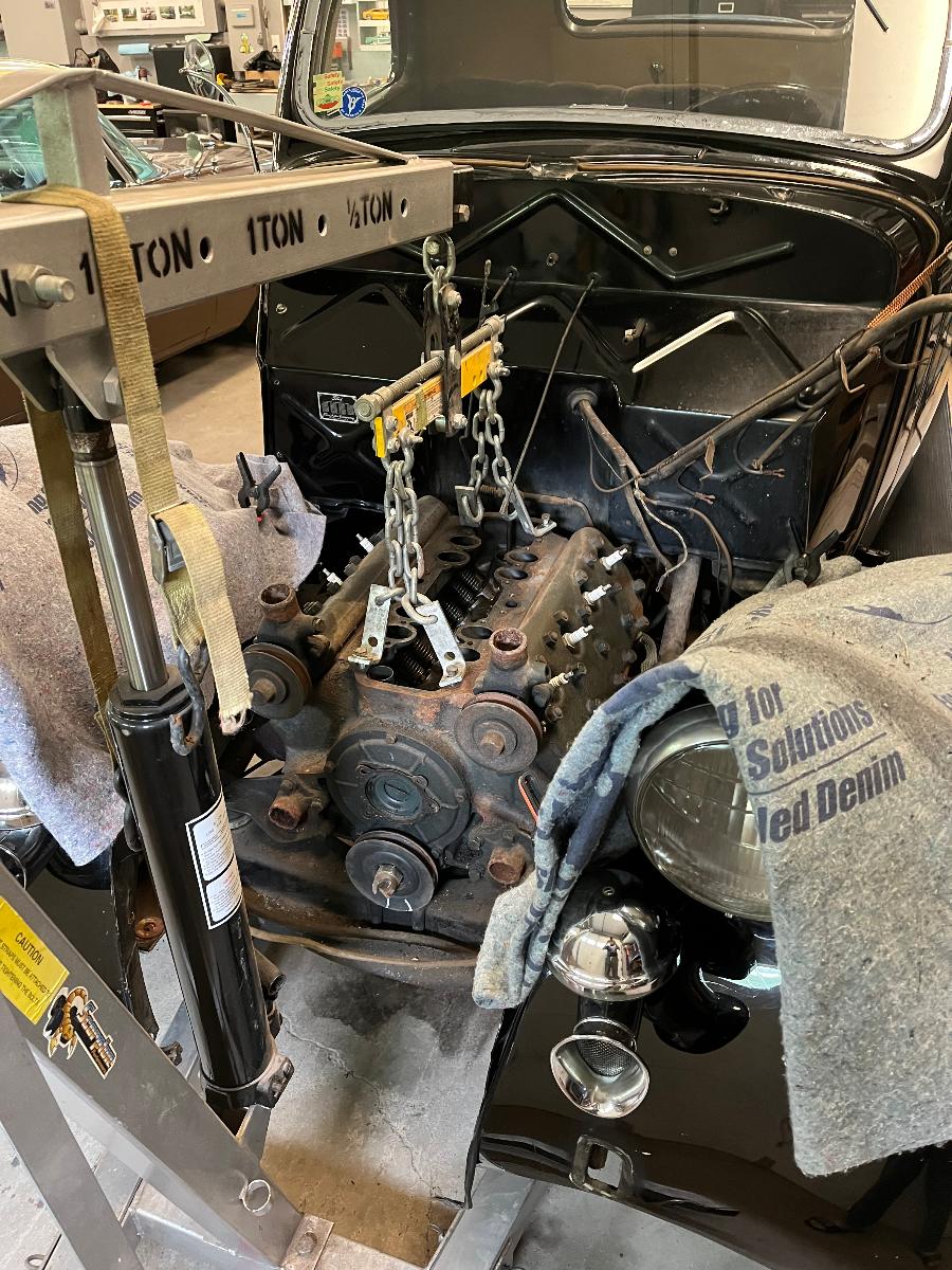

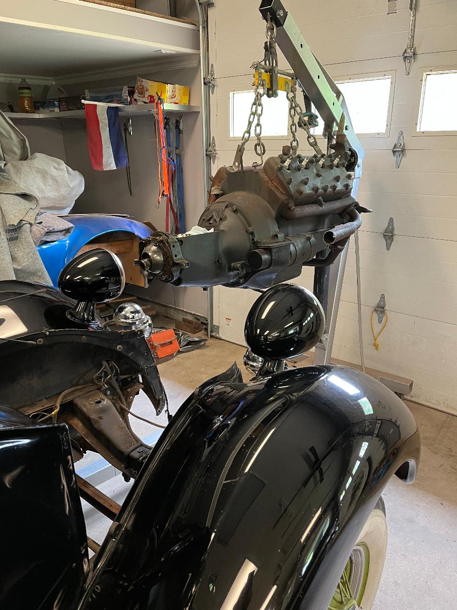

Thanks to all for the good advice.. Engine and transmission are out all if one piece and no issues save a little spilt oil. Previous owner had filled the engine with as much oil as he could fit in.
Have removed transmission from the engine, clutch and fly wheel are out as is the starter and exhaust manifolds.
will look into getting a 39 or newer? transmission

NICE car & the internals look good to me. Love it!
