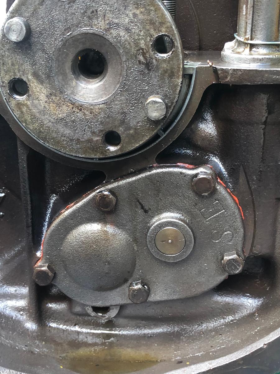

You guys nailed it. I left out the slotted screws that is above the pop pump gear plate.

Pretty sure it's the oil galley. It should have a recessed plug in it.

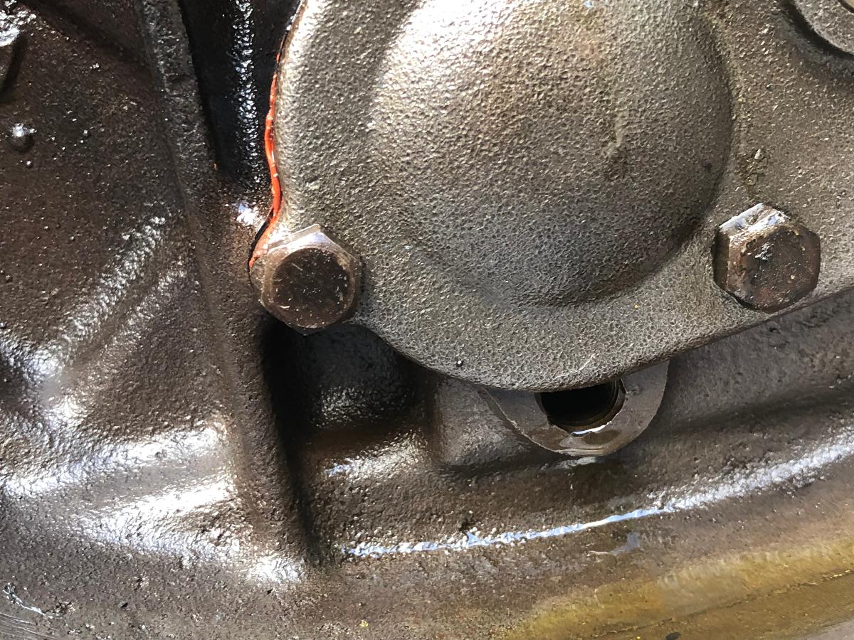

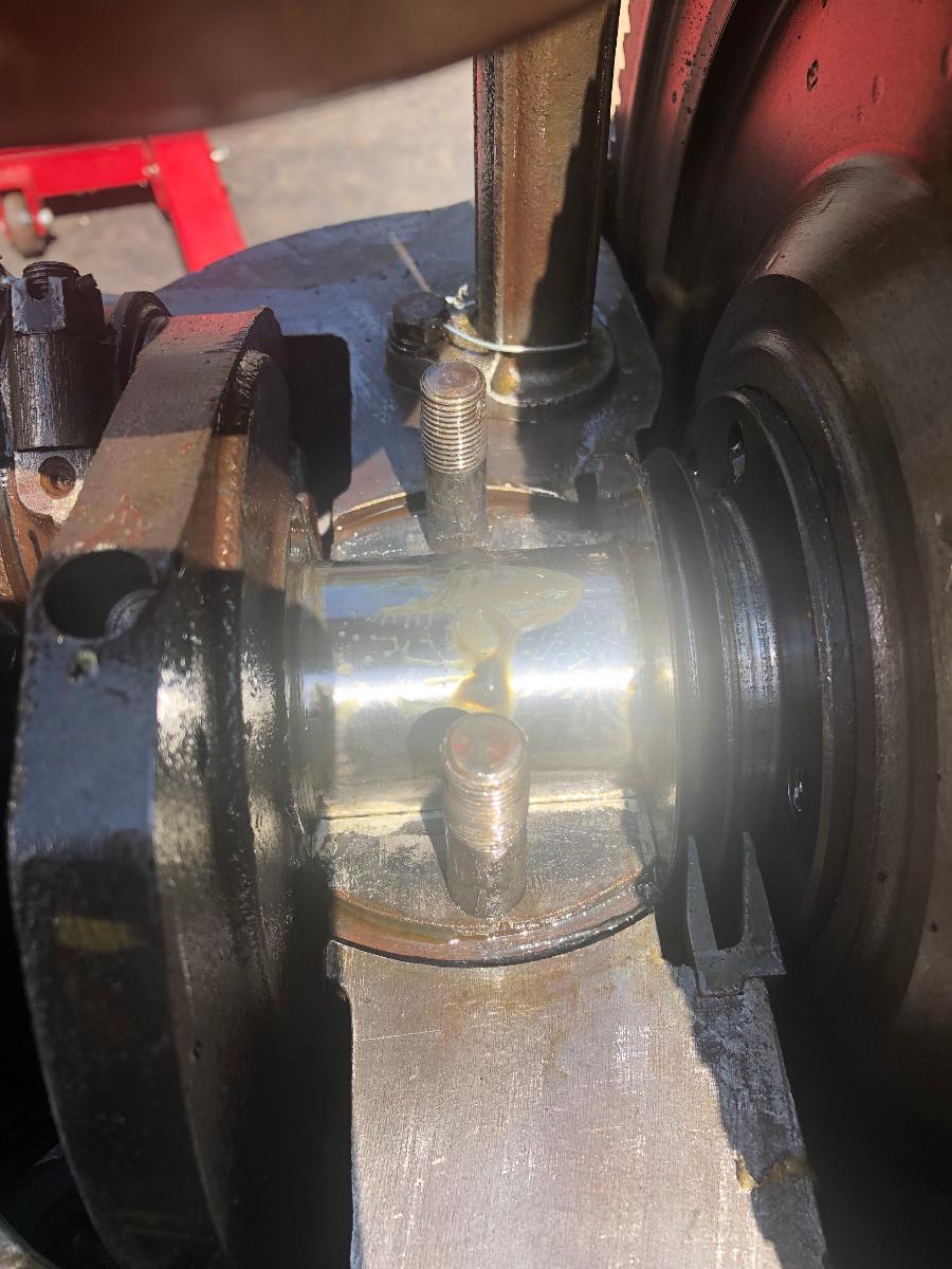

I took the engine out. Pan gasket look fine. On this model there is no rear rope seal. I removed the clutch and flywheel. The cam shaft cover is not leaking.
Now I see a machined hole half covered by the cam shaft cover. If I stick a probe in it it goes in about 2”. Now my second block has the same hole but the probe only goes in a 1/2”. So I am missing something in my rebuild. What is that hole for.?
I can not find any reference to it in tracker and Herman’s rebuild book.

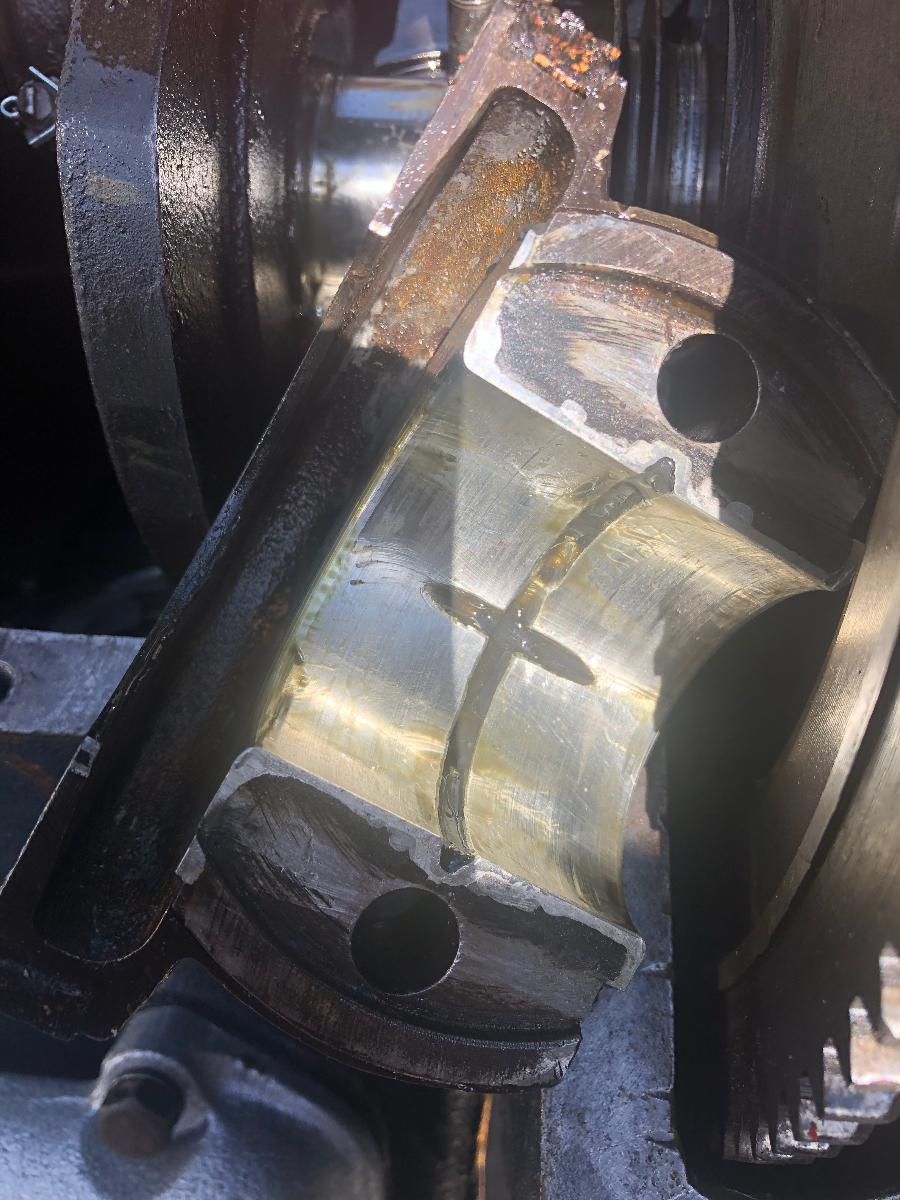

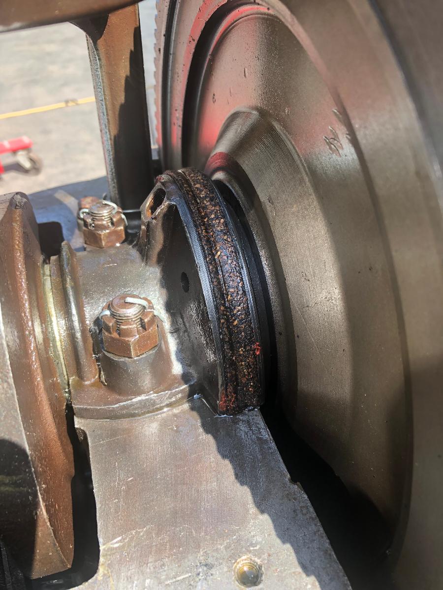

I am not that familiar with the early engines, but it looks to me like he may have a main bearing cap that requires the pot metal seal with the V-groove for the slinger. The rear main cap inside should look like the block in the second photo.
The other place that I would look is the cover over the rear of the camshaft.
Before you tear it apart again, put a measuring cup under the cotter pin and crank the engine over again. It would be a help to know exactly how much oil is coming out. Just cranking the engine should not allow a lot of oil past the slinger or rear cap drain. A lot of oil from cranking would indicate that rear camshaft cover is not sealing or the oil is leaking from the oil galley.

No didn’t have one. Looking to get Ann original motor for the car I traded this engine for the ‘48 year model I had. Had the engine for 50 years and just two years ago start overhauling it. When I took it apart it didn’t have this tube, I could be wrong. I have two other babbit blocks like this one and neither one has this tube. What would it look like?

Did you obtain and install the rear main tube before re-installing the engine??
