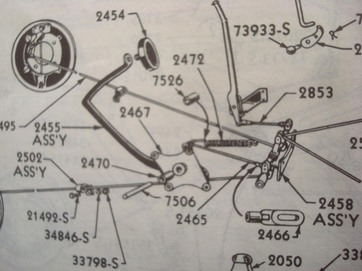

I got this photo out of the FORD GREEN BIBLE page 18
the spring is number 2472 and looks like it is attached to the chassis and the pedal linkage,
BOOKS do help
hope this helps 37Ragtopman , Maine
ASLO in the clevis pin that goes in to hold the rod in,,, has a groove for the return spring to hold on too
so make sure you have the correct clevis pin, and make sure you put the cotter pin in it,

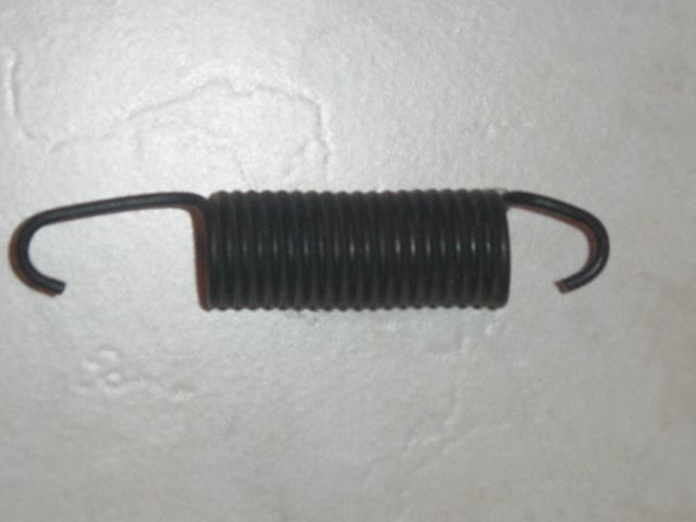

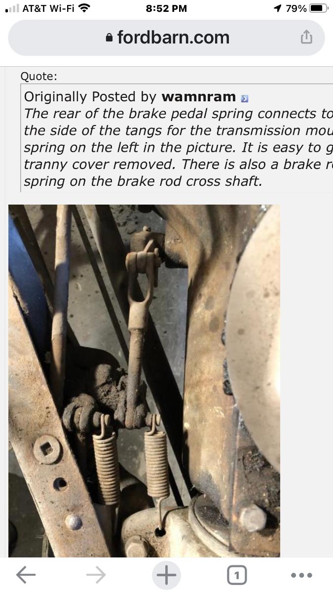

36 brake and clutch pedal use the same spring, photo below. The attachment point for the brake pedal return is just to the outside of the rear motor mount. The hole in the mount is for the clutch pedal spring. See page 82 in the restoration book.

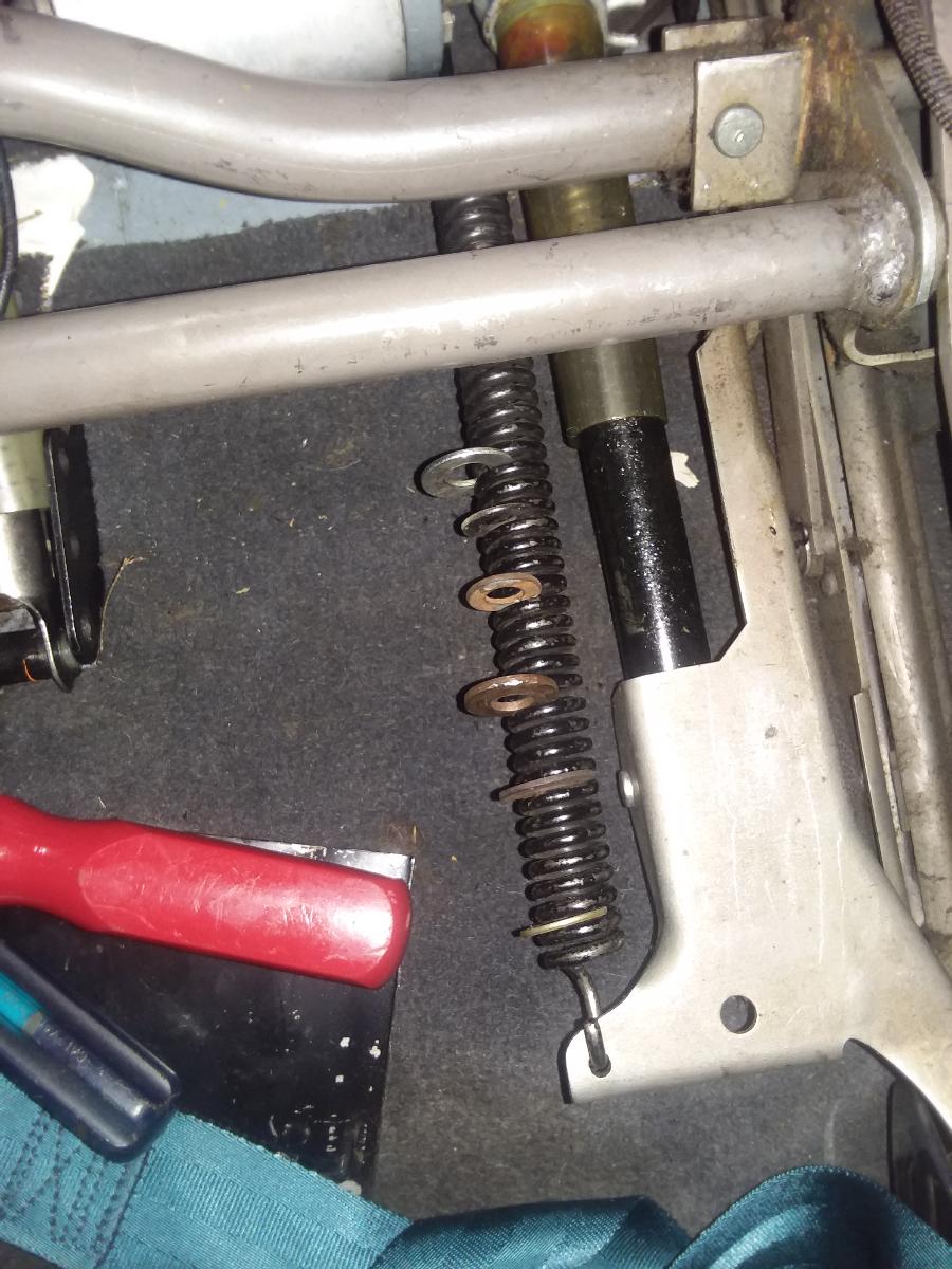

When I have a strong spring to install, I like to use flat washers between the coils of the spring to make it long enough to fit. You can bend the spring to get the space needed for the washers.
