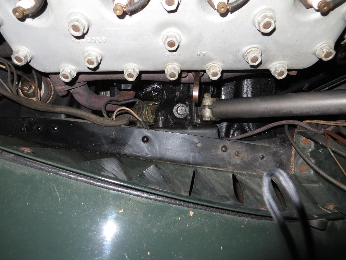

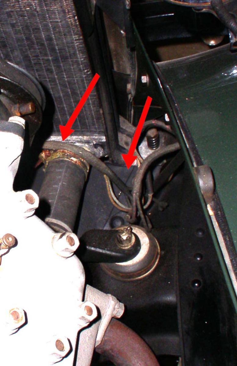

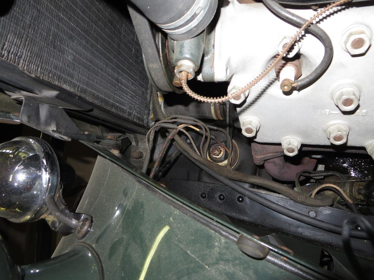

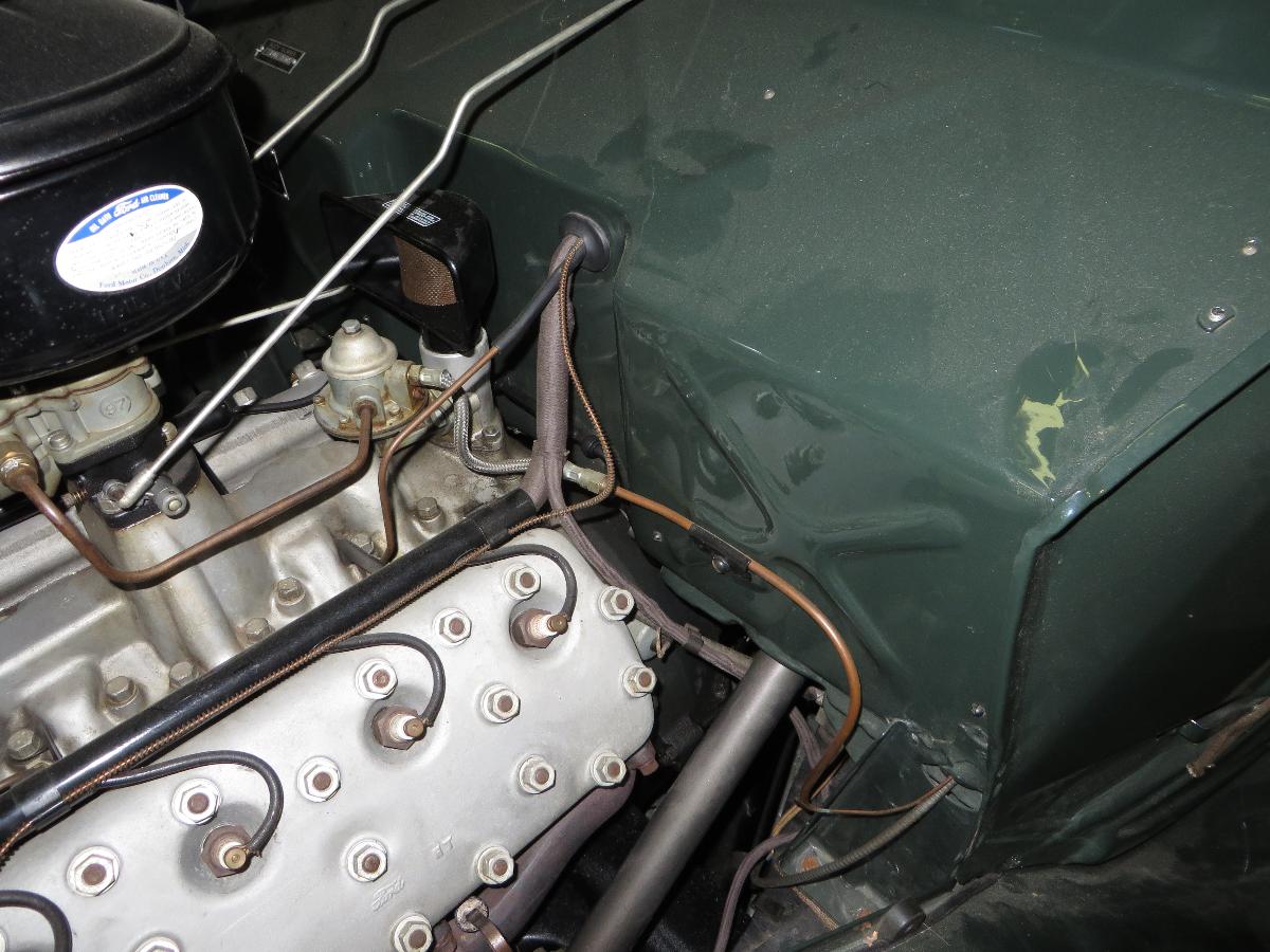

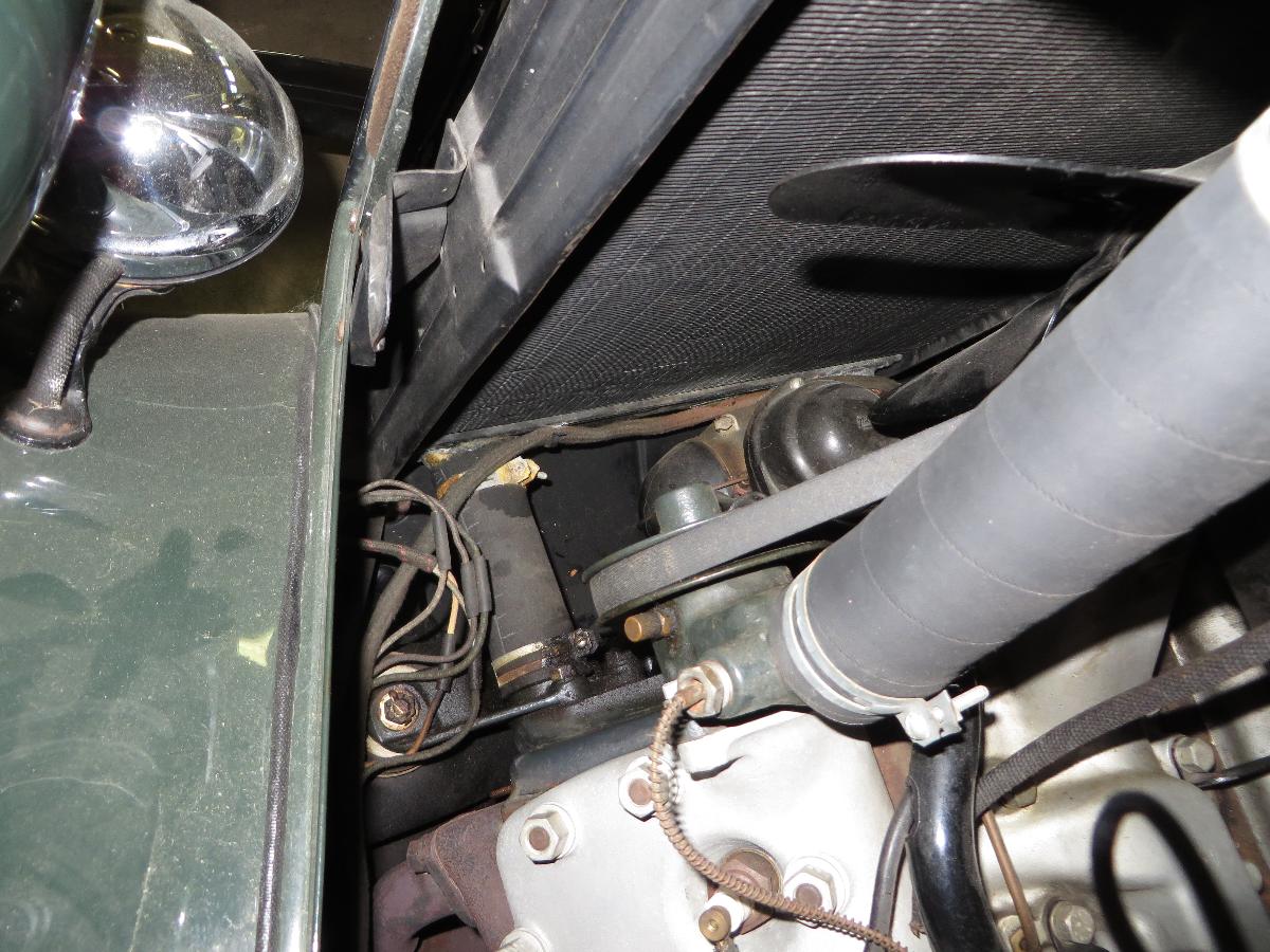

Here's some photos of my 35 engine comp that might help. Please note that originally the headlight/horn crossover wiring was held in place by clips on the bottom of the radiator.
