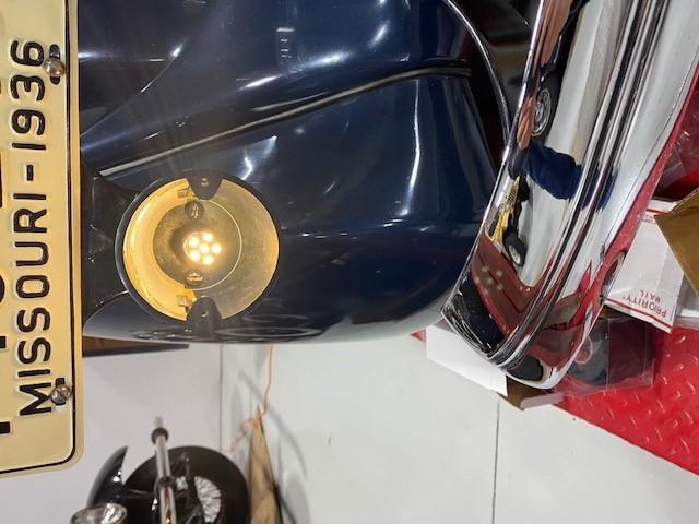

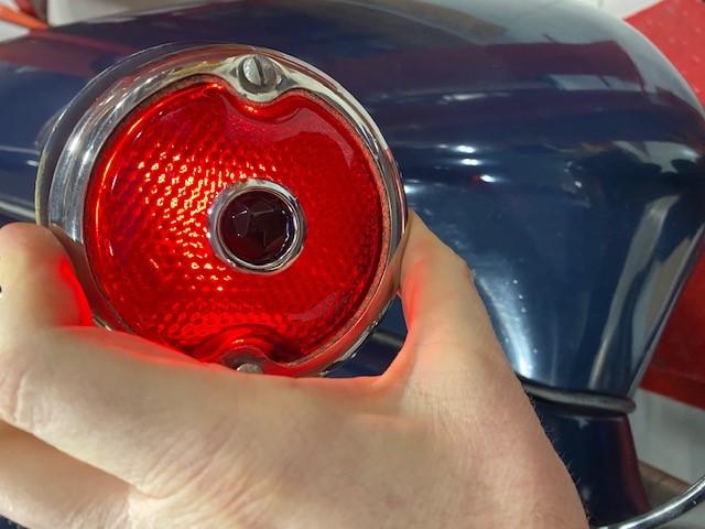

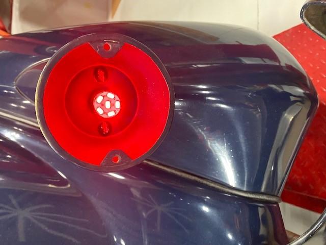

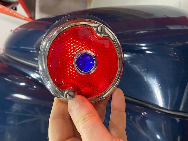

Just thought I would update folks. Switched from super bright incandescents (which didn't work well for me for some reason), to LEDs for the taillights. Definitely brighter. I ordered both white and red LEDs because I read somewhere that the red LEDs penetrated the taillights better. Honestly, I didn't see it. The red also didn't light the license plate, and since I have blue dots, the reds would not show through the blue filter. See photos below. For the purists out there, I do have the original red glass lenses. I keep them in the car. Switched to these after a friend of my Dad shared a story about them on his '35 phaeton when he was in high-school. Plus, they do seem to shoot a little more light back and may draw attention, which is really what I am going for with the brake lights right now.
Up next for winter projects, I am going to run an extra ground to taillights, search for electrical short, try to figure out why my turn-signals stopped working, complete install of brakelighter, and seatbelts.
Bonus points to anyone able to identify the make, model, and year of the car in the foreground. Dad's, not mine. Hint (not hint), we are pretty sure it was the first car to be manufactured with heated seats.
