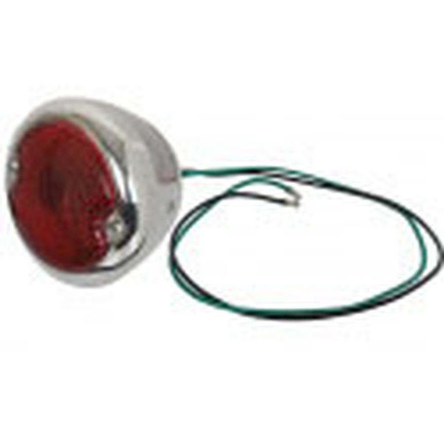

Interested in any comments on Mac's LED Tail Lights for Ford “1933-36 Passenger & Sedan Delivery, Stainless Steel Body, 21 Red LEDs”, left Part # 32-14660-1 & right – Right Part #: 32-14654-1, $64.99 each. Have 1936 Ford & main interest is in brightening these lights. Do these lights just fit inside stock housing? Any issues, other recommendations. Thanks.

I replaced one side with an LED. I then placed the car in the dark garage to see the difference up close when compared to the opposite side. The difference? Well, if there was one, I could not detect it whatsoever. In my opinion, save your money. Oh, and yes, my grounds are very clean.

Make sure your lights have a good clean ground and then paint the inside of the light with white paint..You can also adapt a reflector from a flashlight to slide over the light socket to reflect the light. These are cheap fixes that will most likely give you as much light as an LED.

I believe that those lights are 12 volt and unless you need the housings, 12 volt led bulbs are less expensive. If you need 6 volt Pos ground bulbs they are more expensive than the 12 volt bulbs. Here is a link to a discussion on LED bulbs https://www.earlyfordv8.org/forum/viewmessages.cfm?Forum=18&Topic=12656&keywords=led%20bulbs I tried painting the inside of my tail light housing white, and saw little improvement, next I painted one with Chrome paint with another slight improvement, but still not bright enough to be seen clearly on the road. I then used flashlight reflectors behind the bulb and saw a big improvement with the light output. One of the members of my RG was following me at night and said that my tail lights were not working, so I investigated LED bulbs. I installed a set and they are bright enough to be seen under all conditions. I still have the flashlight reflectors behind the LED bulbs. I bought very bright LED bulbs at http://classicbulbs.com/ But the site doesn't list them any more, but this site does. https://www.ledlight.com/ledlight-6-volt-positive-chassis-catalog.aspx
