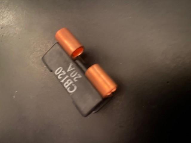

At the suggestion of TOMO, I bought a breaker fuse to save having to constantly replace while I source my short. Works like a charm.

How about info on these breakers - I didn't even know they existed, and I saw no info on these in the 'brighter taillights' post referenced. Where'd you get it? Manufacturer? Amp ratings available? Etc.

I found this one on Amazon, it was around $3. Mfg. by CEC Industries. They had a lot of different AMP choices. Under 20A Type 2 Circuit Breaker. There were some options you could wire in. I liked this style because it basically plugs in the old glass fuse spot.
