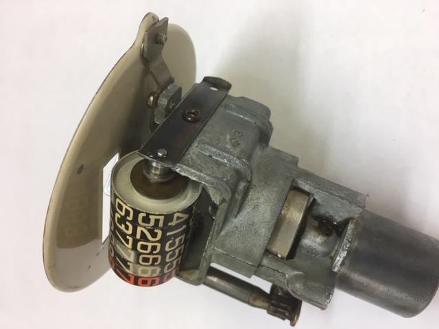

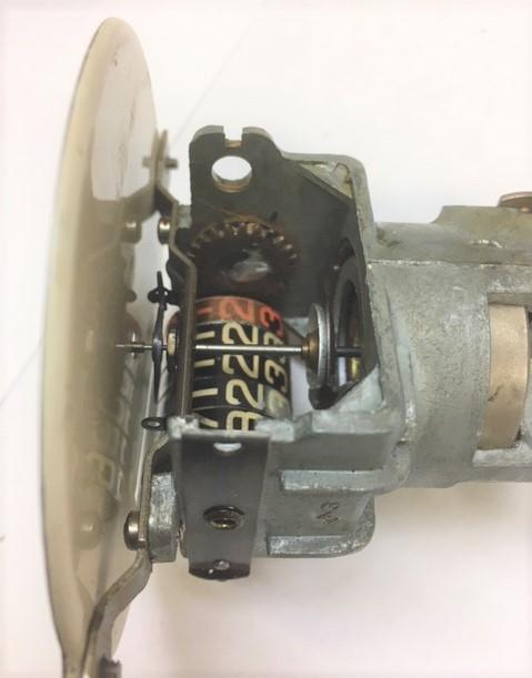

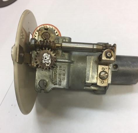

The odometer in my '46 Super Deluxe quit at 859999. I decided with Covid, shipping and customs costs to Canada, I'd take a shot at it myself. After disassembly I confirmed that the reels on the odometer were jammed, and cause one of the drive gears that transitions from outside to inside the frame to spin on the shaft. That was an easy fix. I cleaned the end of the shaft and the gear hub then soldered them together. The problem with the odometer seems to be that the 4th 5th and 6th reels are progressively stiffer, so when the odometer rolled to 9999, the accumulated resistance overstressed the drive gear train. I have looked at how to disassemble the reels to clean and lube, but I can figure out how they come apart. Anyone have any experience with this process?

Jacques. There are no clips on either end of the shaft. It seems the end plates were pressed on with a fairly tight tolerance, as I can't get the plates to move. I have been working at lubing/freeing the last three reels, as I can't disassemble the reels to clean and lube. Trying to work clock oil down the keyway in the shaft to lube the reels. Spinning the 1/10 reel by hand, to get the other reels to rotate to new positions to work the oil in is tedious.

In looking at your first photograph, I would think that they loaded the number wheels first and then pressed on the brass gear to capture everything. If that's the case, getting the gear off without damaging anything is a tough one.
