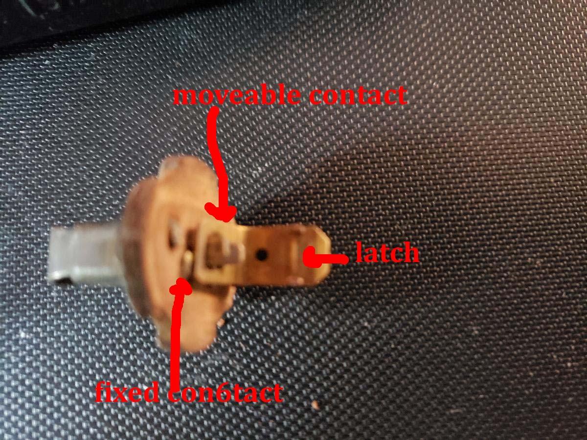

11-01-2020 @ 7:58 AM

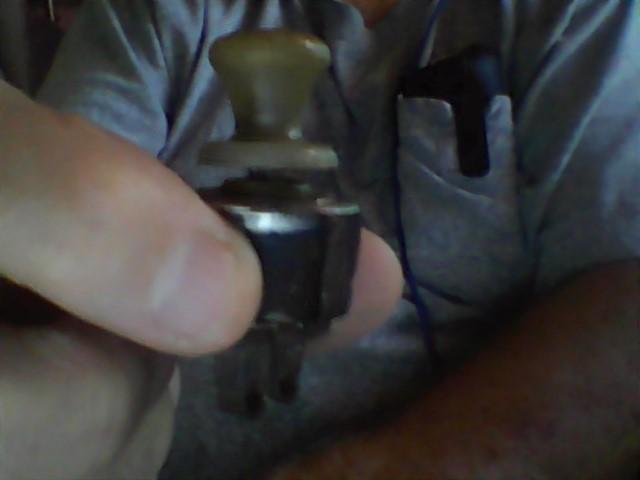

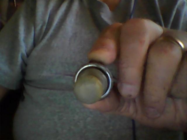

Without having a switch in my hands, I am just guessing. Here is the way that I think the switch works.
I have labeled what I think are the 2 contacts in the switch, you can verify this with an ohm meter. With the switch in the IN position, the contacts should be touching. When you pull the switch out, the piece connected to the knob pushes the latch enough to open the contacts.
The way that I would try to get it to work is:
Connect an ohm meter between the 2 connectors on the back of the switch. With the switch apart, you should have continuity between the connectors.
If you do not have continuity, bend the moveable contact so you will have continuity.
When you have continuity with the switch apart, try assembling the switch with the meter connected and the kob pushed in. If you lose continuity, try rotating the parts slightly to regain continuity.
If a slight rotation will not restore continuity, bend the latch slightly away from the piece on the knob.
flatfoot
10-31-2020 @ 10:25 AM
Posts: 286
Joined: Mar 2011
I did this but it didn't not work. It has a short and won't stay on. I have to jiggle it but it still won't stay on. (Gnarl GGGGGGGGGGG).

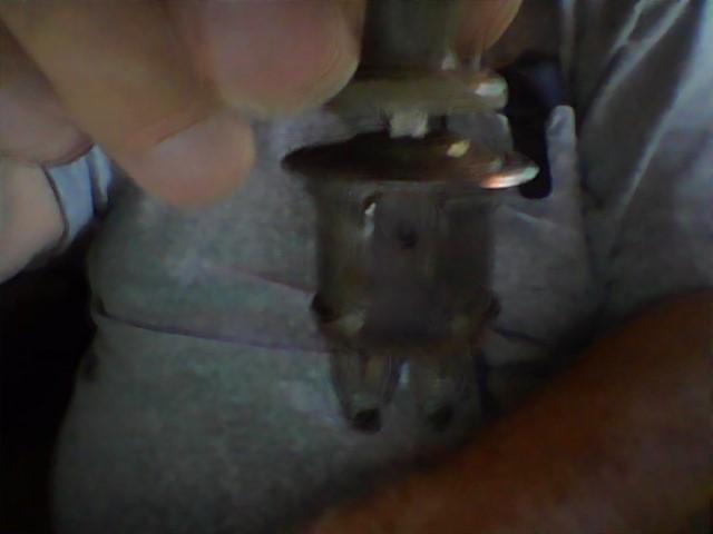

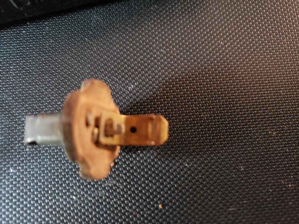

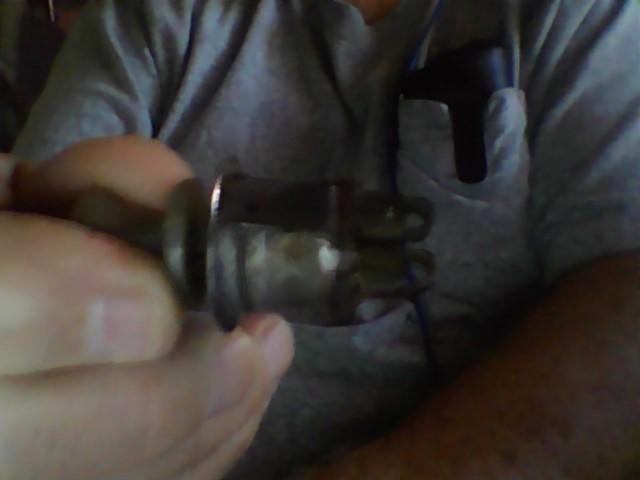

Jacques1960
10-06-2020 @ 5:26 AM
Posts: 201
Joined: Aug 2020

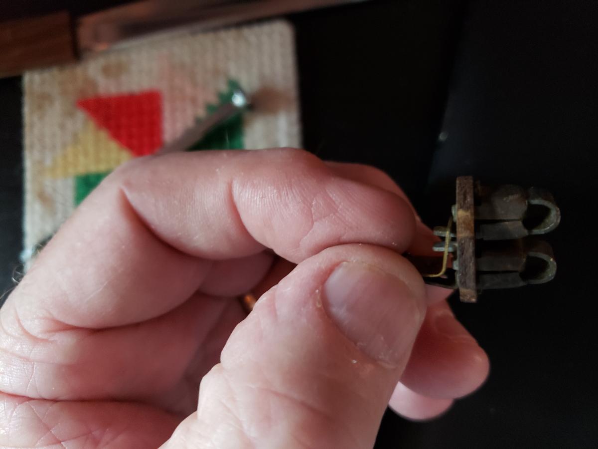

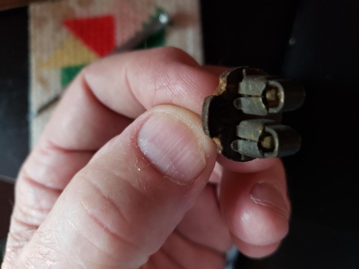

That appears salvageable; addressing corrosion might be a good starting point to see if you can improve continuity

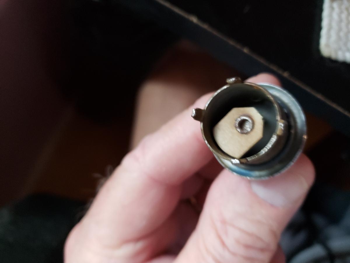

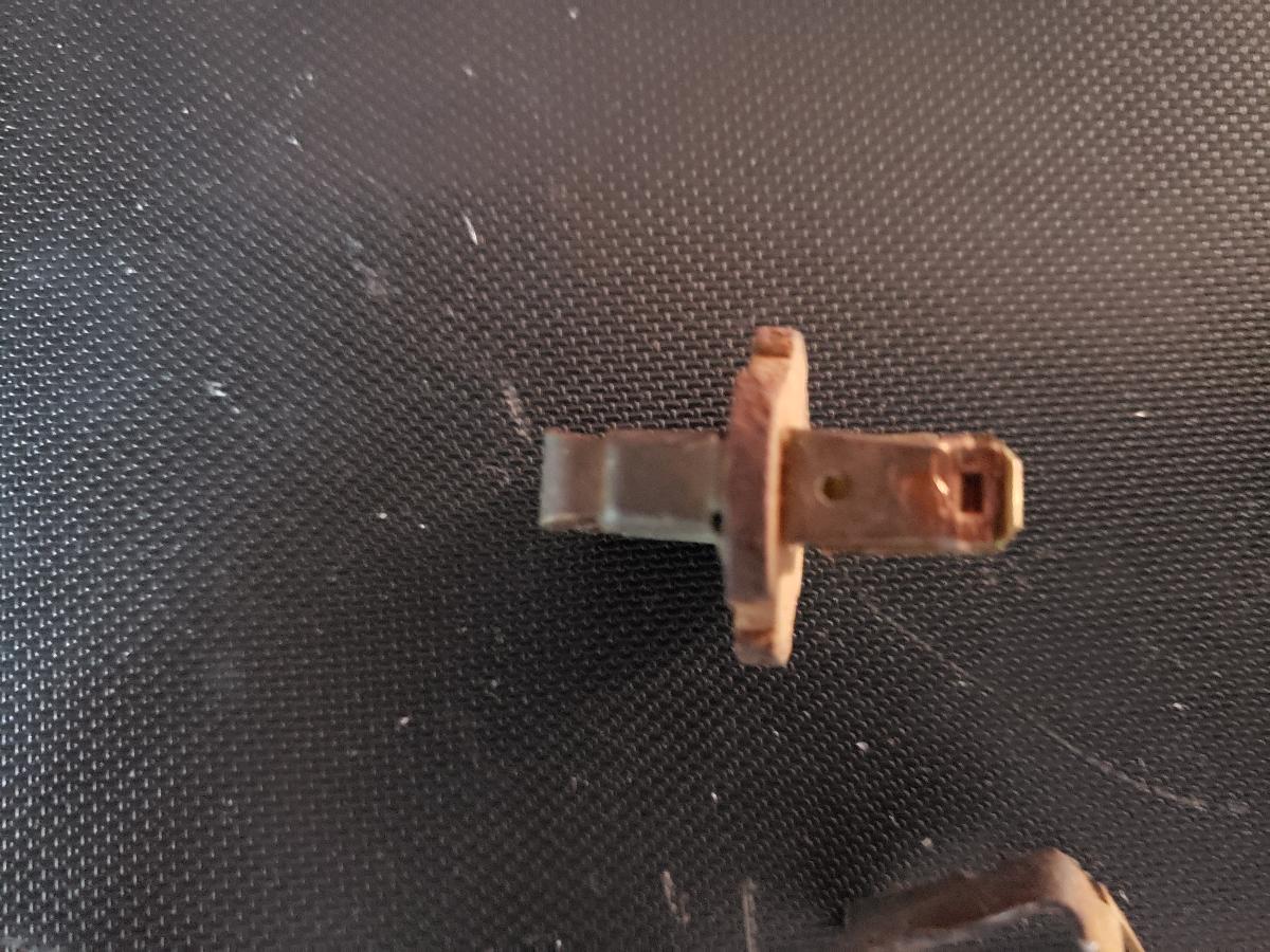

10-05-2020 @ 4:58 PM
Posts: 286
Joined: Mar 2011
Here are some photos.
