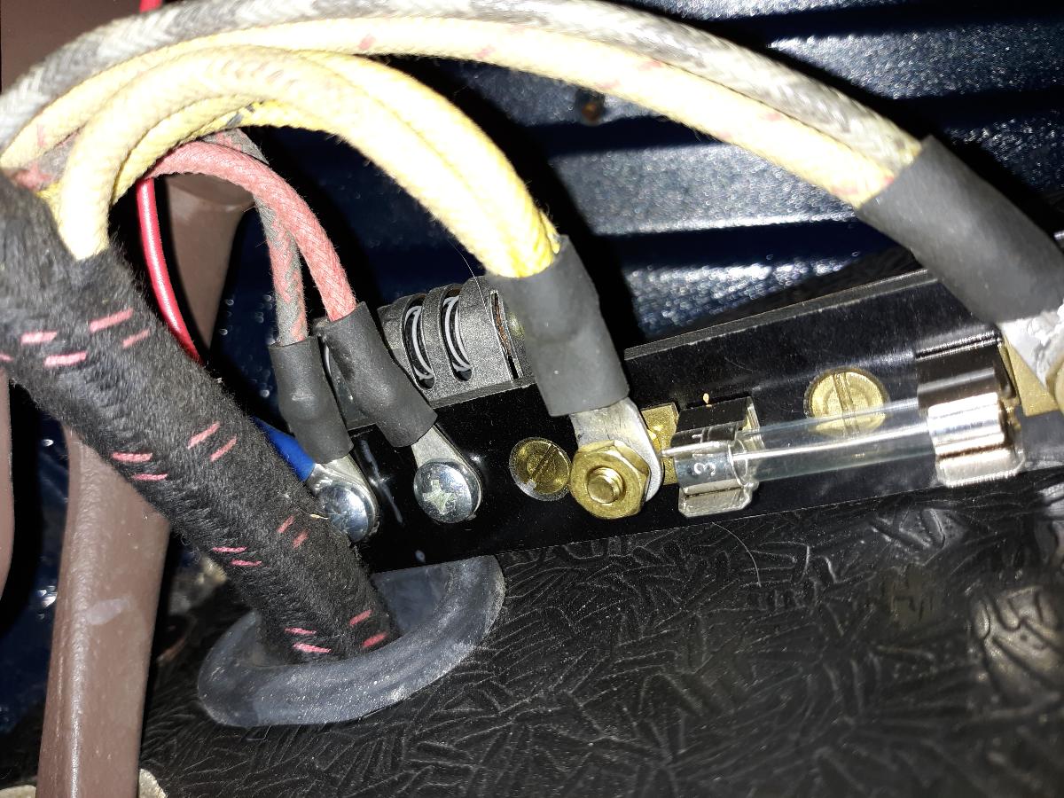

Your photo of your resistor and fuse shows it to be a reproduction. I don't believe 39 Dlx used the assembly you have but what you have should work if it were assembled properly, which it is not. Is the assembly attached to your firewall or is it just loose?

It sounds like you found the issue with the coil and condenser, but some of the reproduction ignition resistors can be evil!
I had a repro ignition resistor that drove me crazy-I drove it for months with no problems, then suddenly, the car would stall, then not restart, then it would be ok again and run for a while, then it would fail again.
The repro resistor was intermittent-someone at a local antique Ford parts place found me an original and it has been in the car for over 18 years now.
