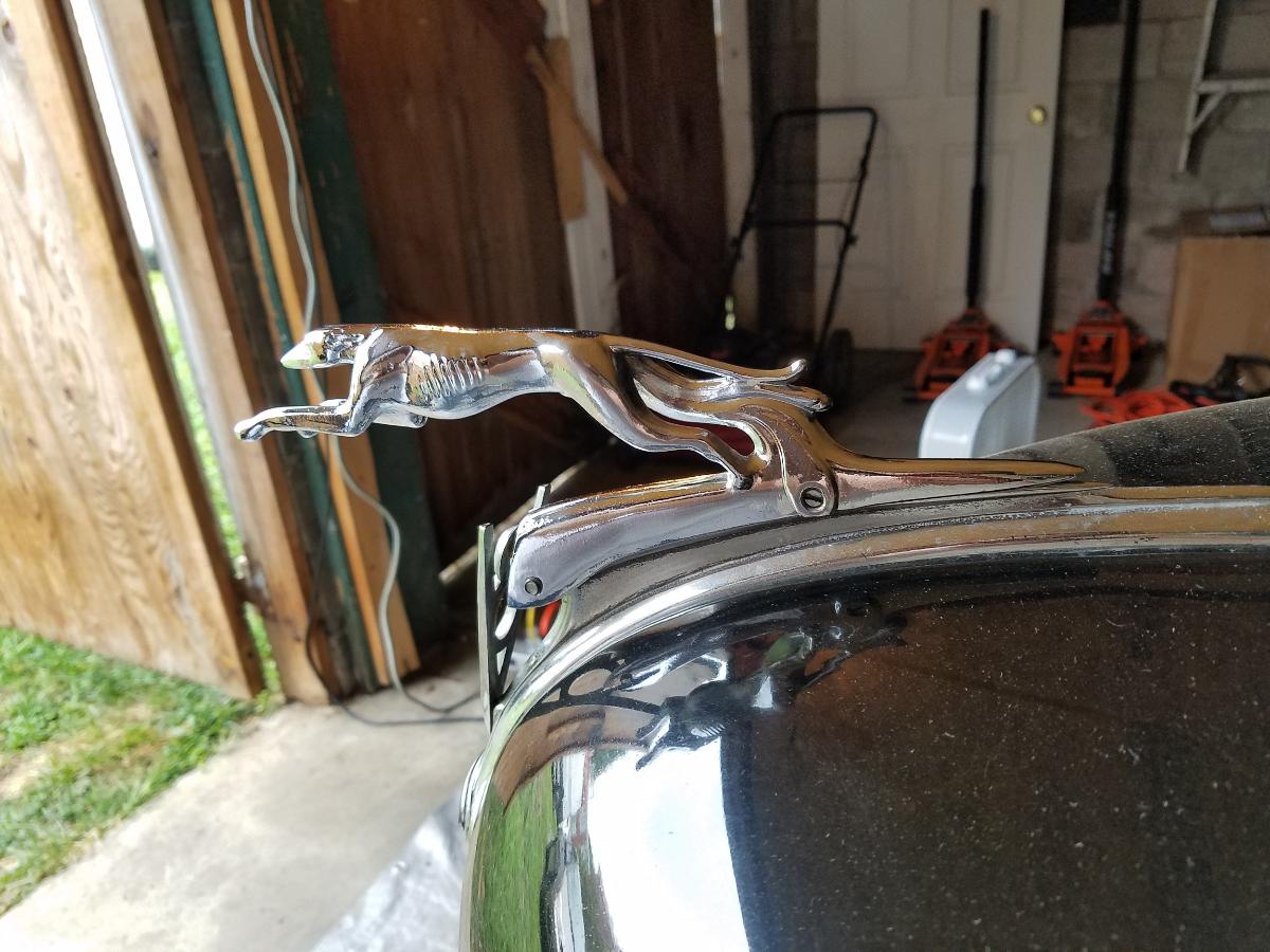

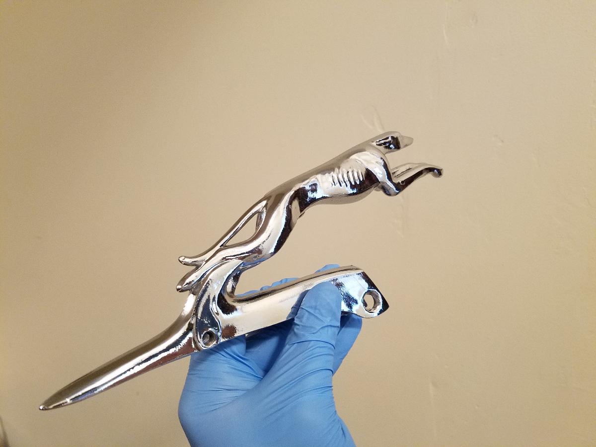

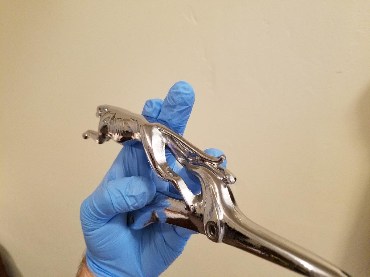

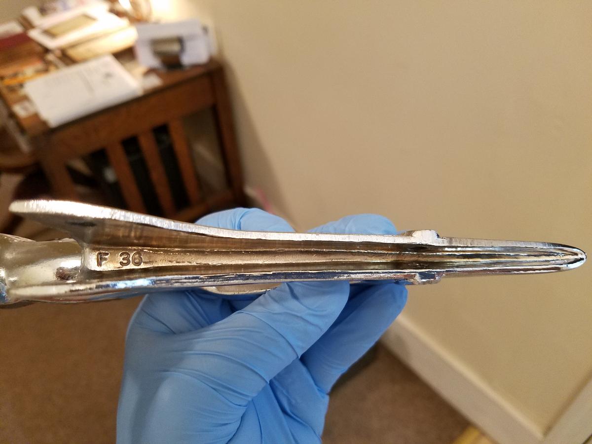

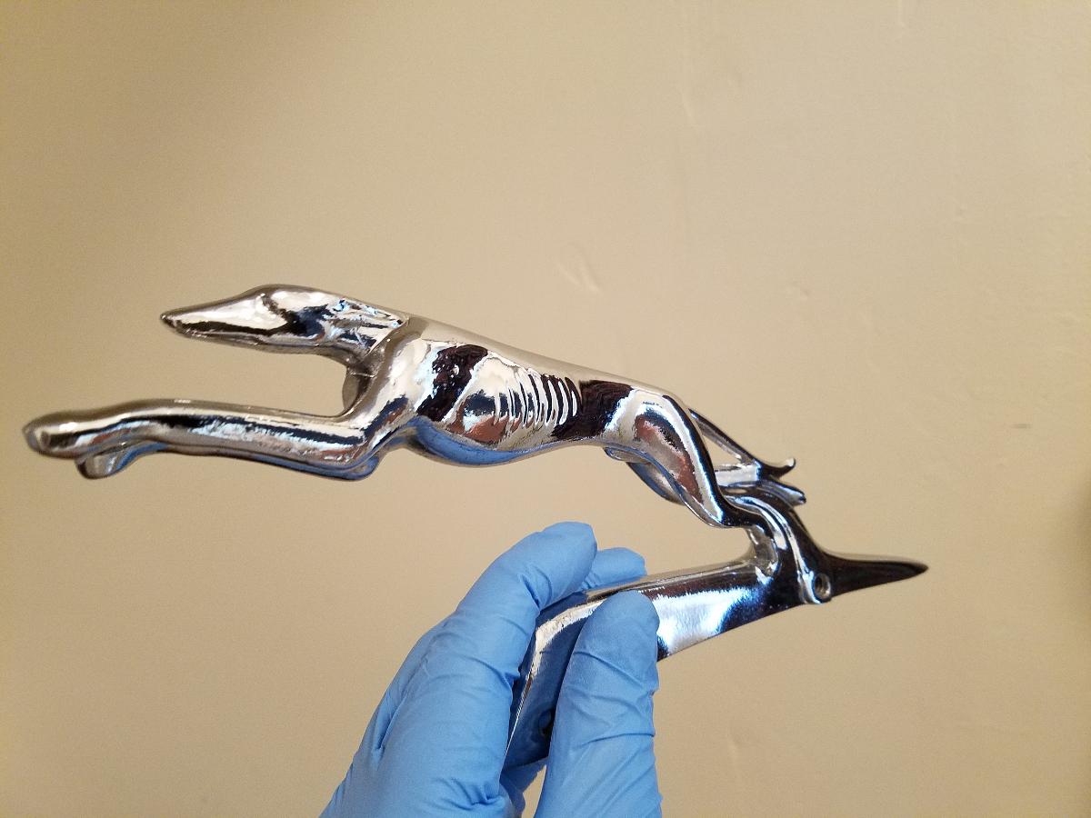

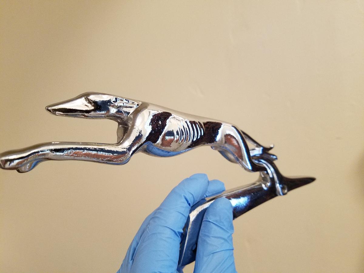

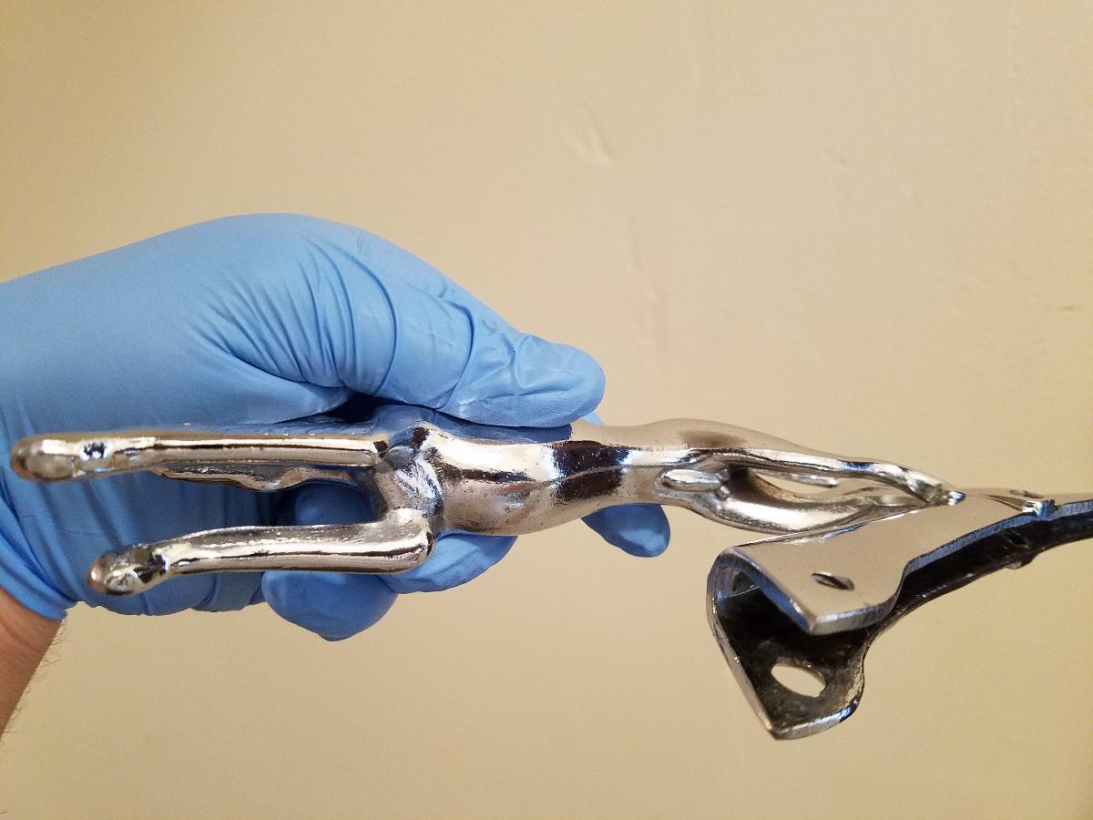

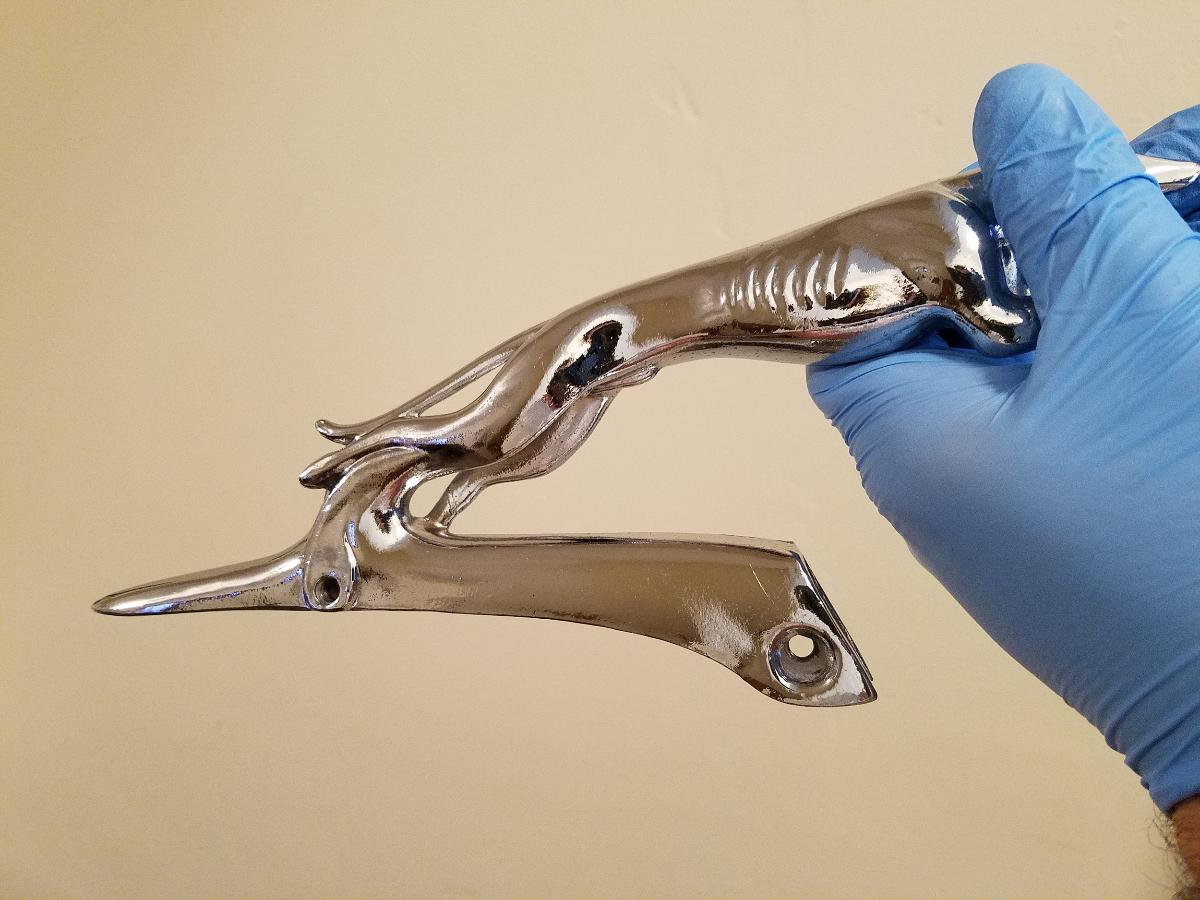

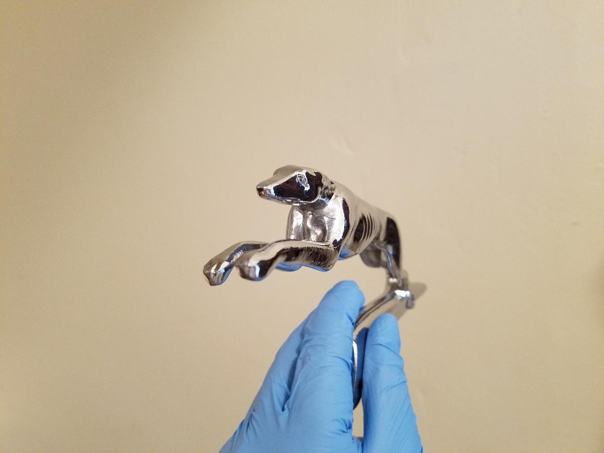

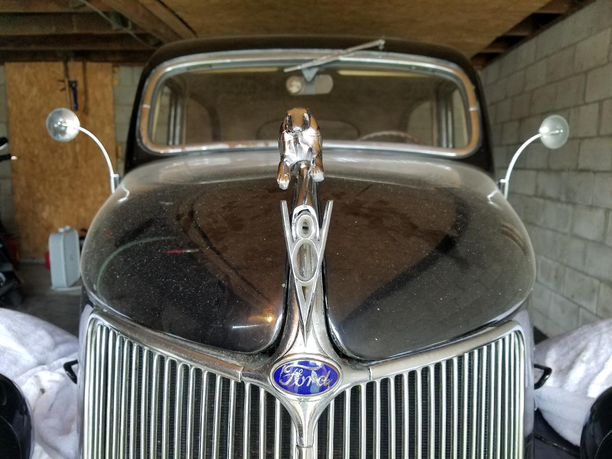

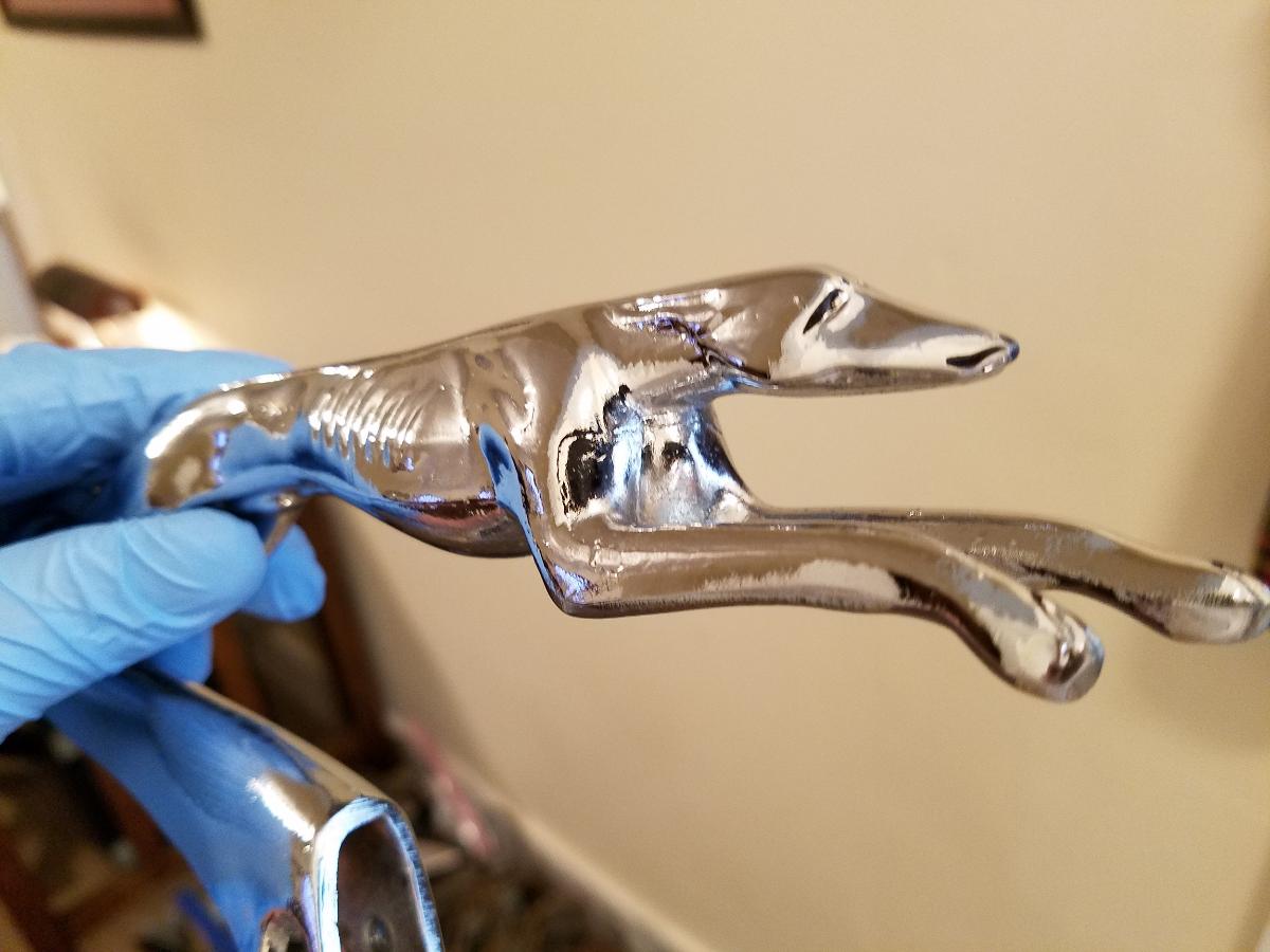

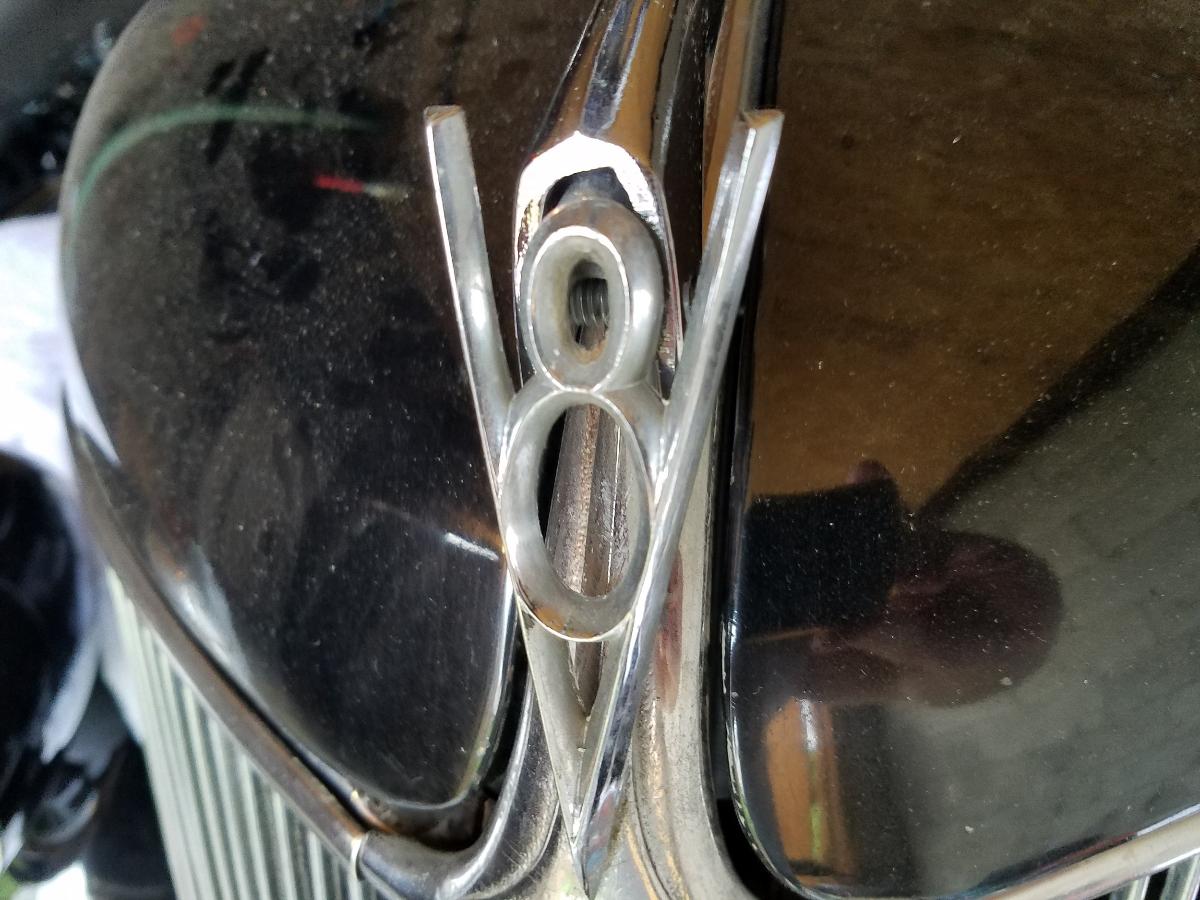

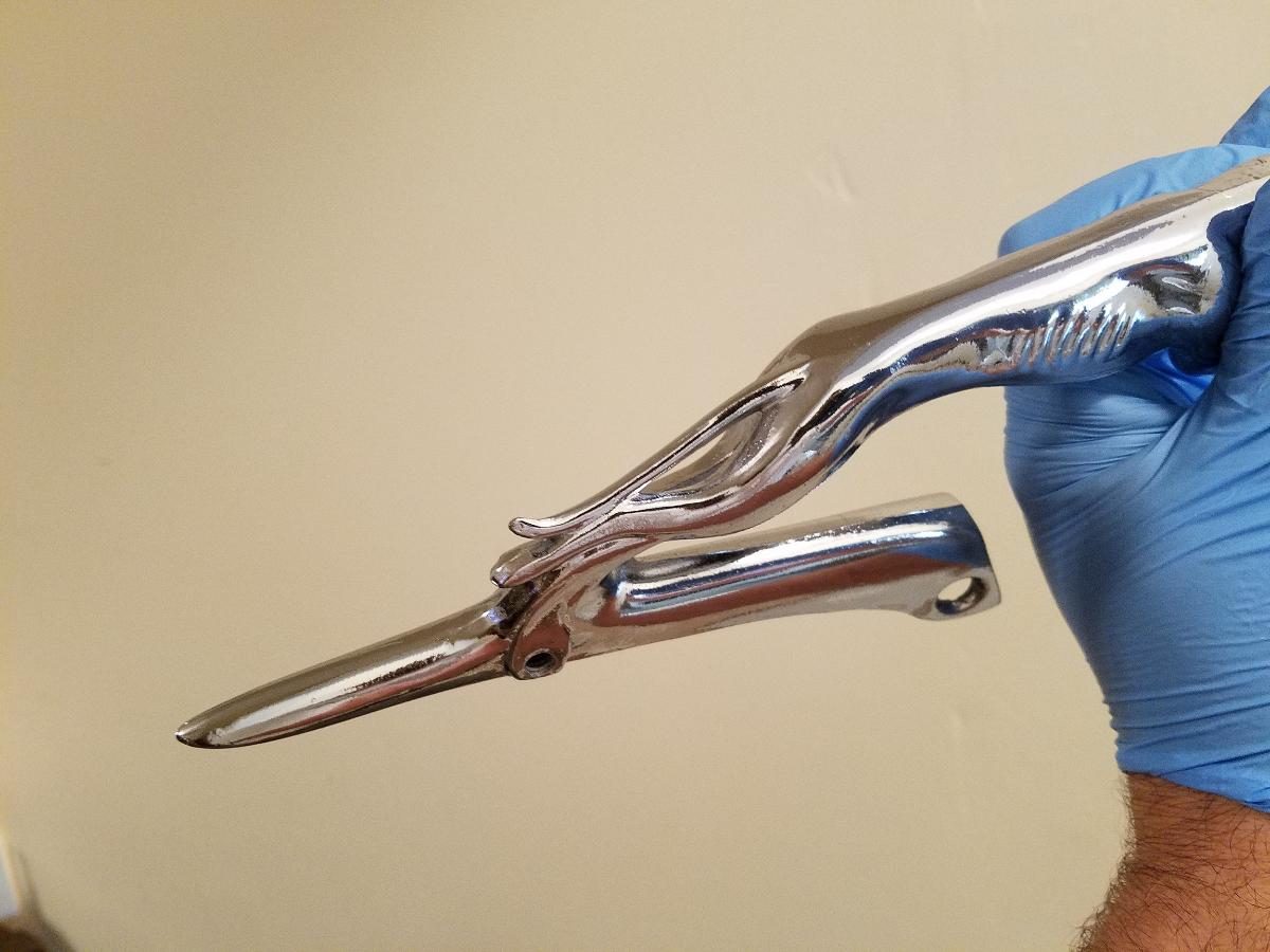

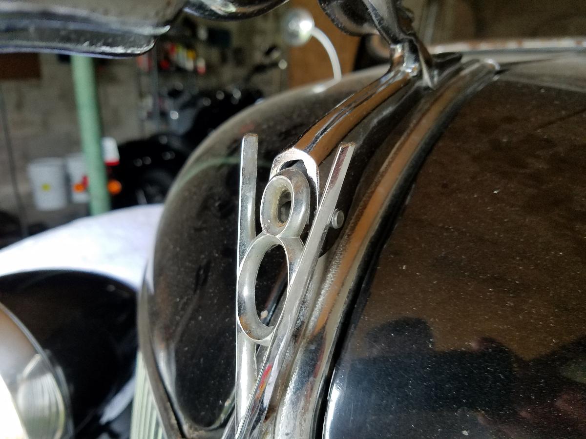

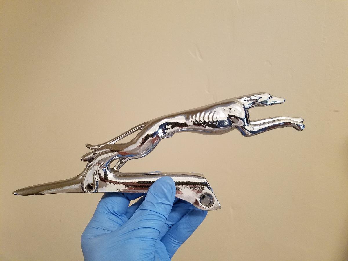

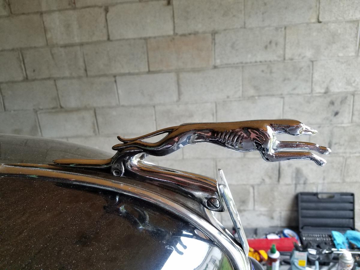

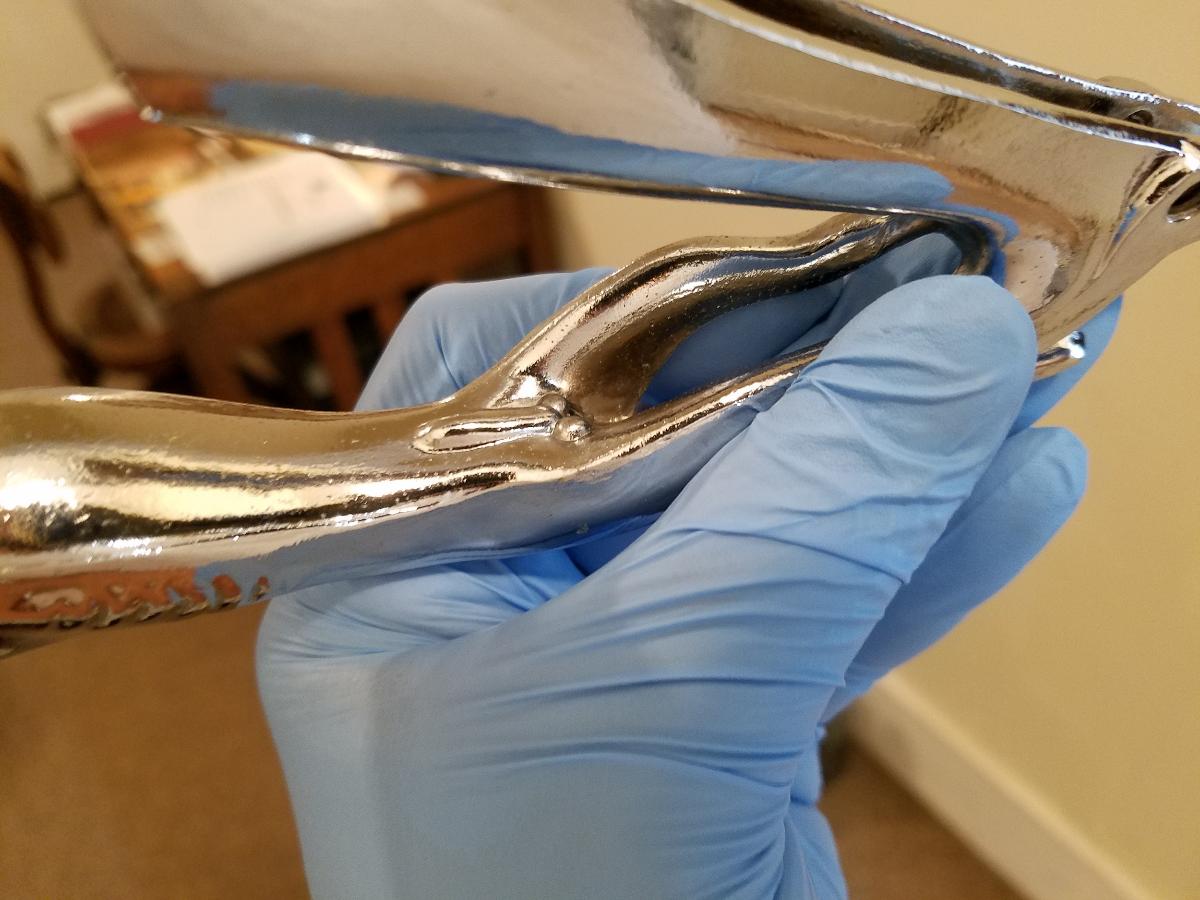

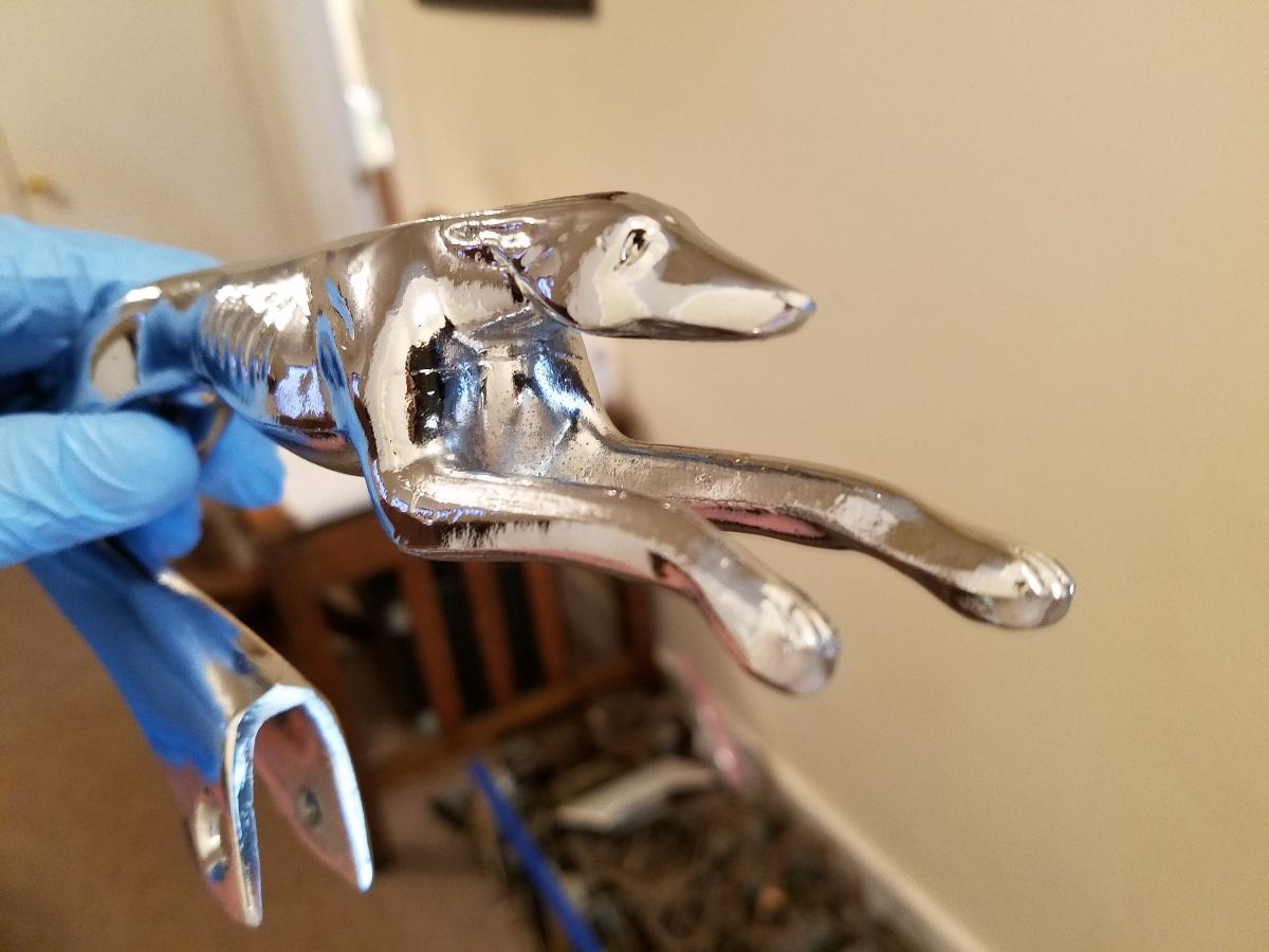

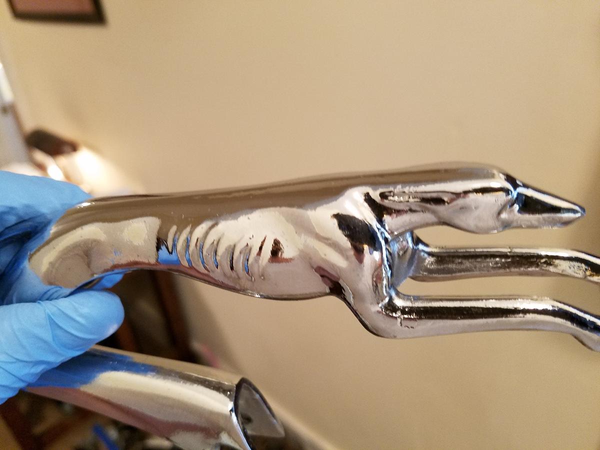

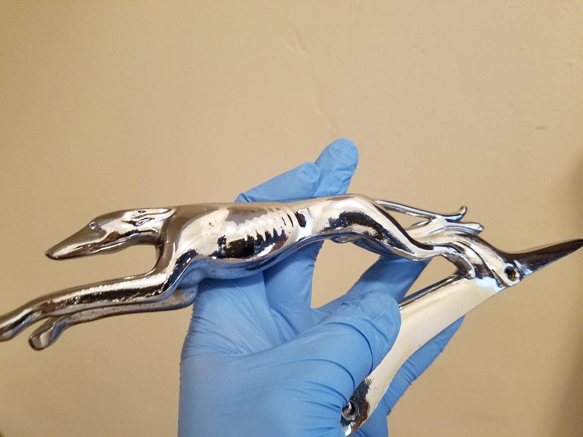

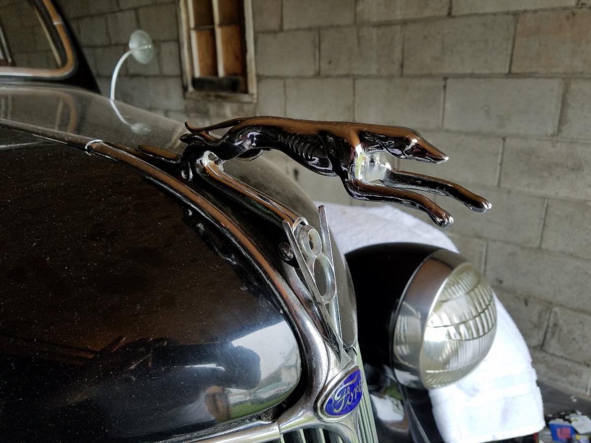

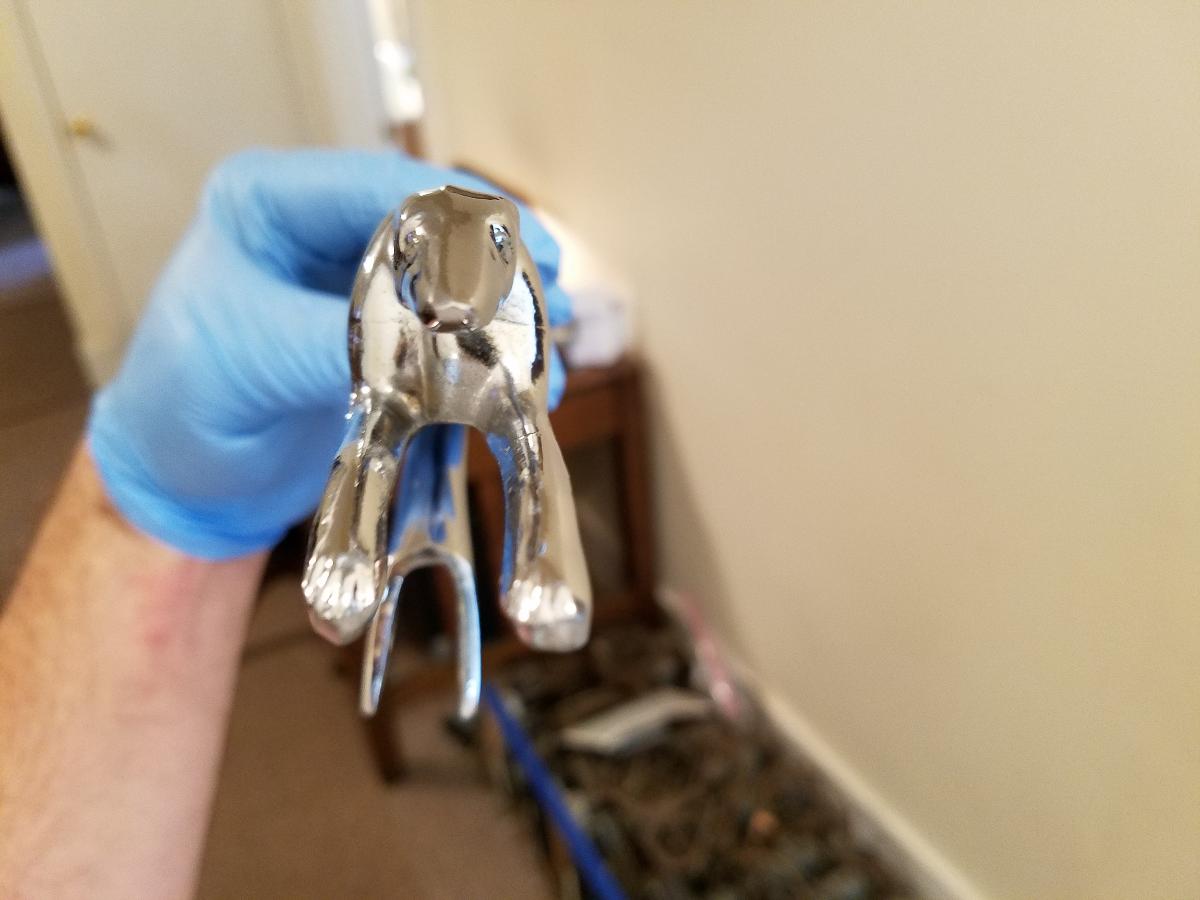

Hi guys, Attached are pictures of the greyhound accessory found on my 1936 year car. From my research the greyhound hood attachment was a dealer accessory an owner could purchase back in pre-1937 selling year cars. There are a lot of reproductions out there and I want to be sure what I have is an genuine original greyhound accessory that was purchased in 1936. My 1936 Tudor Touring Deluxe to my knowledge an original ordered deluxe car complete with banjo steering wheel, mirror clock, radio, full line of instrument gauges, chrome grille, chrome horn grille's, chrome window frame, two tail lights, and accessory polished trim rings around wheels. All of these features point to an original greyhound so it would seem if they went all out on ordering the deluxe features new in 1936. Could you all please evaluate this greyhound and give me your expert opinions as to if this is a genuine original 1936 accessory or an aftermarket later reproduction. One thing to mention, underside of greyhound is stamped " F 36". Prior to polishing, greyhound chrome patina matched that of the grille and other metal items on car. I have since polished the greyhound, hood pictures show the greyhound polished. To my knowledge the greyhound has been on the car for a very long time if not since new in 1936. I do not have any solid evidence of this though and hope you all can help out. Thanks
Jon Ketron 1936 Ford V8 Deluxe Tudor Touring Sedan

More photos

More photos

More photos

Last two photos, thanks.

Jon, I'm eager to see the replies the '36 expert(s) weigh in with. Lord knows I've a lot to learn about '36 Fords and learn I will with their help. I had understood that domestic '36 Fords did not offer a Greyhound ornament. Yes? No? I do know that accessories offered at dealers were not necessarily Ford authorized. I wonder if that's the case here. C'mon experts... tell me please
Kens 36 |
08-28-2020 @ 8:15 AM
Posts: 405
OK, Mike, I’ll bite. I’m not an expert like Don and David and our late friend John Swanberg, but I’ve read quite a bit on this subject. Jon, being that your ’36 is an Ohio car, your greyhound is almost certainly an aftermarket item. Whether it was sold by the dealer at the time of purchase cannot be known in the absence of documentation of the sale, but it was not a Ford-authorized accessory. There were a number of after-market manufacturers back “in the day.” While Ford in the U.S. did not offer such an accessory, Ford of Canada did, as has been well documented by Don Rogers. Don has further stated that Ford of Canada supplied the accessory greyhound on all DeLuxe ’36 Fords when they introduced the wood-grained dash in mid-1936. There is a long-standing belief that an “original” greyhound can be distinguished from aftermarket by the presence of a free-standing tail. In fact, the ’36 brochure from Ford of Canada appears to show the tail attached to the rear leg. Ken
wmsteed |
08-28-2020 @ 8:29 AM
Posts: 613
My 36 Ford 5 window, manufactured late Aug '36 is a delux car that has just about every accessory in the book, including a Columbia and the tool box located over the right wheel well. The tool box is reputedly a rumble seat option. An anomaly on my car is the "Aug 36" spare tire cover, reputedly a Standard tire cover, in lieu of the common '36 tire cover. I am the second owner of the car, have owned it since Sept 52. the odometer had 51.k and change when I bought the car. With all of the accessories on my '36, one could assume that the original owner of the car went nuts buying everything in the book, however, he did not opt for a greyhound. I believe that it has been well documented that the majority of the accessories installed on new cars during the '30's/40's were dealer installed.

It's my understanding that the greyhound "hood ornament" was a Lincoln part.
3w2 |
08-28-2020 @ 9:54 AM
Cast bronze Greyhound radiator caps were standard equipment on classic era Lincolns starting in 1925, three years after Ford acquired the Company and remained standard equipment through the 1934 model year (a plain, so-called "driving" cap was available as a no-cost option). With the relocation of the radiator filler to beneath the hood starting with the 1935 models and the Greyhound became just a radiator sh*ll ornament until the end of the last of the "big" Lincolns in 1939. In all instances, the tail was free standing. With the '34 models, Ford offered a Stant-manufactured die cast zinc Greyhound radiator cap as an authorized accessory. Like the Lincoln caps and radiator ornaments, its tail was freestanding. Except for the Ford of Canada 1936 model exception, Ford did not offer a Greyhound cap or ornament as an authorized accessory during any other model year. As indicated above there were several makers of aftermarket caps and ornaments, none of whose caps were a Ford-authorized accessory and none had free-standing tails. If a customer wanted one, a Ford dealer would likely be happy to furnish an aftermarket product. In recent times, some other not-originally-offered-by-Ford versions such as Greyhound caps for '32s and '33s have been created. P.S. Your Columbia rear axle is another example of a non-Ford-authorized accessory either sold and installed by a Ford dealer or other seller/installer of the Columbia axles.
