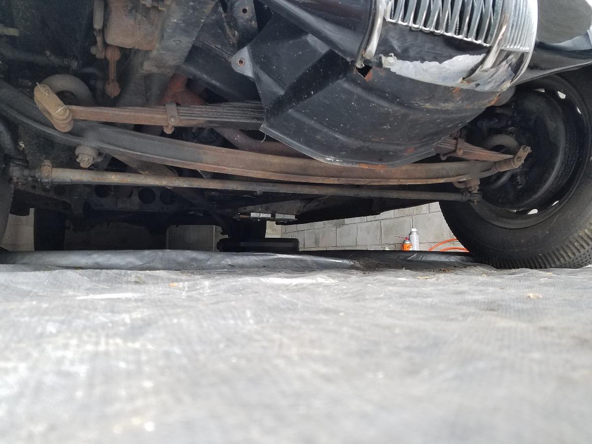

I am slowly preparing a to-do list for the underside of the car. Could you all please share with me the proper lift point to service the underside of the car. I will be using a hydraulic hand jack as a lift, then place jack stands underneath once lifted into the air. I would like to think the lift points are on the axle's. The front axle has a bow in it as from the factory. It is the original axle to my knowledge. Seems tricky to find the proper lift point on this axle. Thanks, Jon

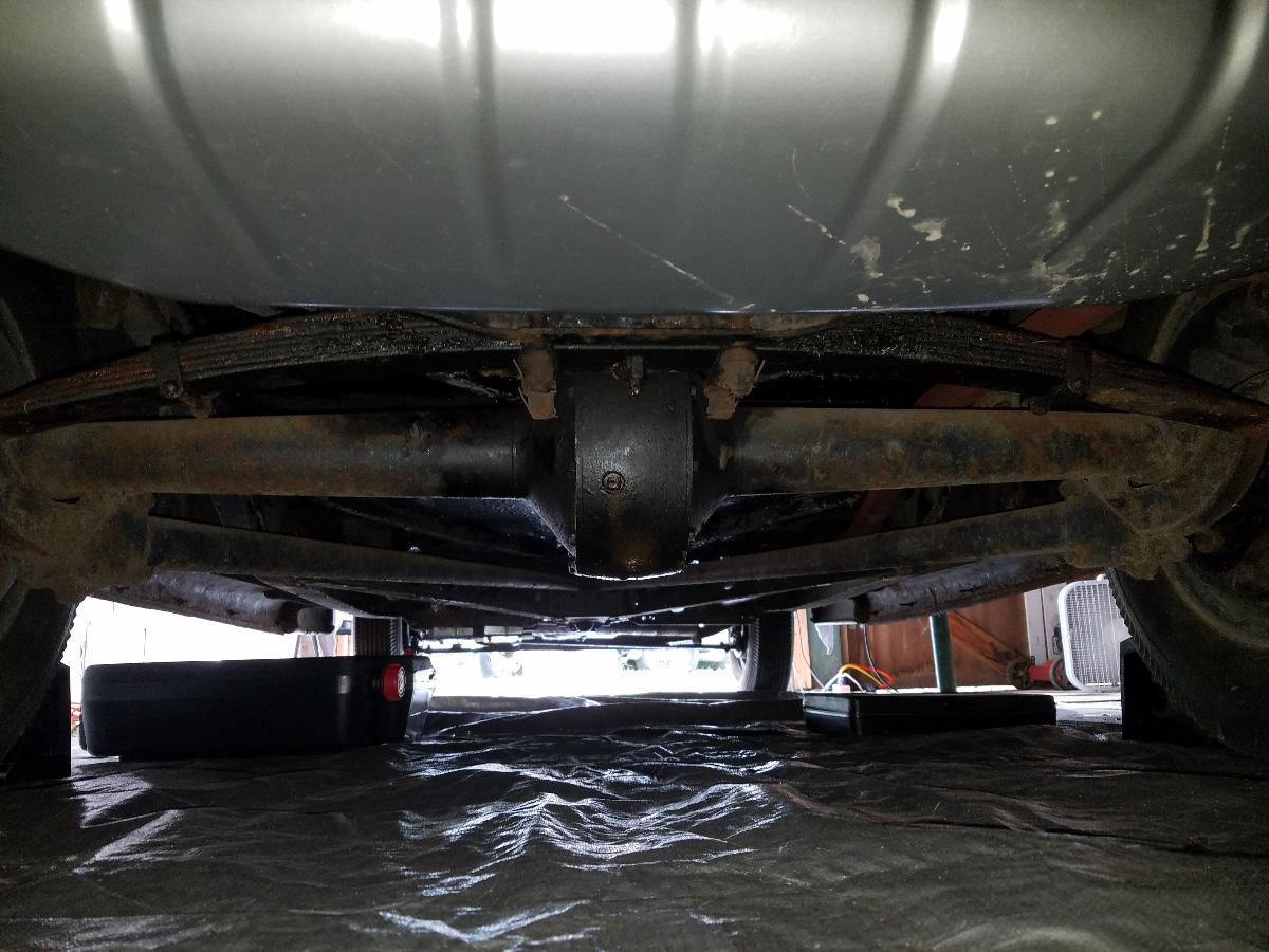

I use a floor jack with a wooden block attached to lift from the center of the front/rear axles. jack stands under the rear axle at the end near the backing plates, front axle jack stands on the inside of the perch bolts for the wishbone. have you thought about setting the tires/wheels on blocks to raise the car?

I typically lift at the center of the front axle and place each jack stand on the axle - inside of the front radius rod, directly next to the perch. I lift the rear from the center section (gear housing) and place the stands close to the end of each axle housing. I don't care to hold a car up on blocks, etc. Although most likely a rare occurrence, what if a tire blows? As long as your working under there... the front spring is long past it's life.
