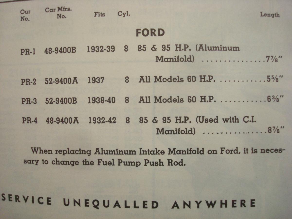

08-10-2020 @ 5:37 AM
hi
I have a list of the V8 FORD push rod lengths,
in the photo,
hope this helps 37 Ragtopman, try buying a NOS USA MADE PART,
