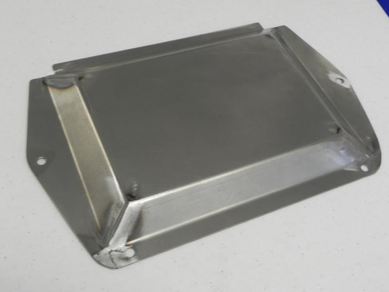

Try contacting Larry Cossar . He was selling a '35-'36 floor cover that had a lift in the stamping for oversized batteries. I believe he is a member of one of the New England regional groups.

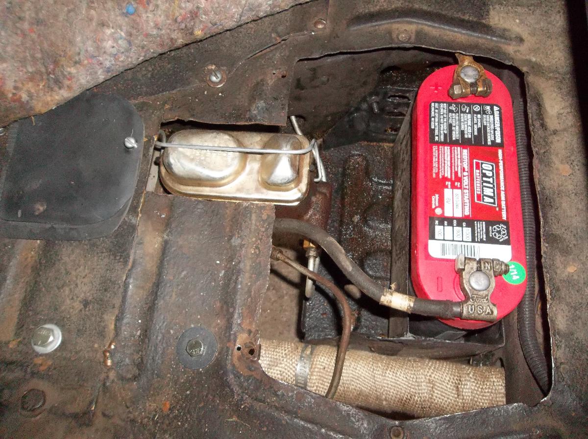

May I also cast a vote for the six volt Optima battery? We currently own and use four of them.
Attached is a photograph of the one in our '36 Ford.
It fits just fine under the floor. The battery box is an 8A out of a 1949/1950/1951 Ford, with a vertical steel plate added in the middle to accommodate the Optima.
Also visible in this shot are a FoMoCo C9 dual reservoir master cylinder (the car is a "Touring A" vehicle converted to hydraulic brakes), and a second floor pan cover plate with rubber gasket which has been rotated 180 degrees.
One of our Optimas is 14 years old and it's still working well.
