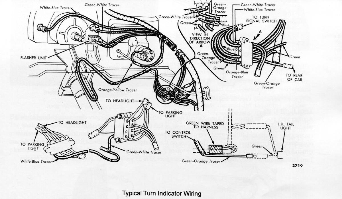

Having trouble wiring turn signals into the terminal wiring block. Does anyone have a photo or diagram showing the holes in the block and which wires go where? I have the running lights, headlights, and brake lights working but I don't know if the terminal block I am using is correct. There are two double holes and the rest are single. Is this the right one?

The turn signal terminal block has 8 holes. There are 2 sets of 2 holes that are connected and the other 4 holes are not connected. Here is alink to the wiring diagram, the junction block for the turn signals is about 4:00 o'clock on the diagram.
http://www.vanpeltsales.com/FH_web/FH_images/FH_electrical-pics/Flathead_Electrical_wiring1953.jpg

Attached is a jpg file illustrating the wiring. Suggest that you may want to purchase the Club's 1952-53 Restoration manual. It is full f these photos

Thanks I got everything working...I already had the manuals I was a contributor to the manuals I was from Red Hill, pa but moved to Florida in 2015. You will see my name in the first few pages as Steve Stastny.
Thanks again...I should have looked there first.
